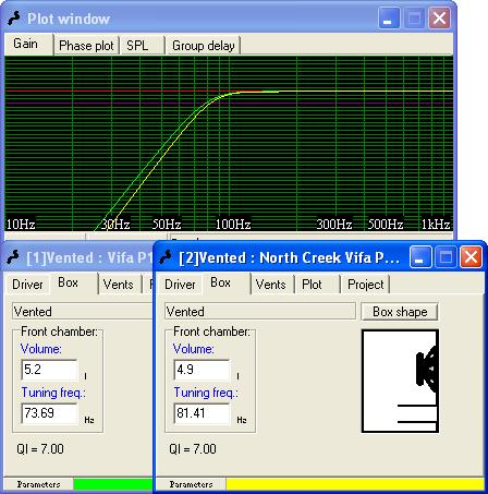

Default WinISD box modeling of the P13 using Vifa specs and North Creek measured values:
