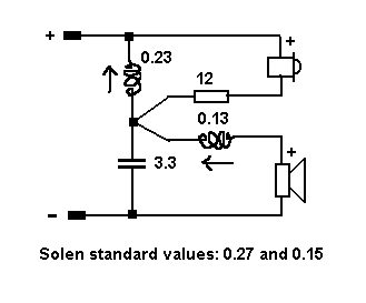

Well, since Dave asked...
THE CROSSOVER
There is nothing special with the crossover design concept, except for my imaginations
when I tried to implement new (often stupid) ideas. I said it is a concept because the
imagination and also the implementation is quite different if one is ever exist. The idea
centers around the "reason" of choosing a high "virtual" crossover point. This crossover
further had different implementations:
1) "Third order" fullrange. This turns a standard woofer into fullrange driver. The easiest
A/B comparison is the driver itself when fed as fullrange. If you feed a standard driver
with fullrange signal, usually the midbass is over exposed and the resonance at high
point rolloff is bad. With this implementation, a tight bass can be achieved. If 5K is
enough for you, you don't need a helper tweeter (I found it difficult to design a tweeter
crossover that locks the tweeter in. But it is possible!). And I found that even weak,
cymbal and triangle sound is often more accurate than in complex crossover.
2) Second order series crossover. If you're not familiar with series crossover, it is a
highly drivers-dependent crossover.
3) Similar with the second implementation but with a resistor (minimum of 10 Ohm) in
place of the capacitor. The direct advantage is the NATURAL sound and the great
TRANSIENT. How to cope with the disadvantage is the design challenge. Good
enclosure (floorstander) is mandatory to take advantage of the bass characteristic.
SUGGESTED IMPLEMENTATION FOR THE PROJECT
The last implementation is the one I suggest for the "newbie" project for several reasons:
1) P13WH+D27TG+5uF has been suggested as refference and my suggested crossover
is very close in character with the single cap crossover (You know, comparing it with 4th order
speakers like The Esquire is sometimes like comparing an orange to an apple. I mean, with
high order crossover you get a smooth response but often bad transient and clinical sound).
2) It is also very cheap. You don't need high quality big inductors. Because the values
are relatively small, you can wind your own inductor using big copper wire from high power
transformer. The problem is you will need an inductance meter to match between the left
and right (Anyway, you will need the inductance meter)
3) The crossover can be tweaked by newbies with low fault tolerance. But because existing
theories don't help much (except for driver response graph and Fs may be) IMO this require
a good ear which usually is not possible with newbies :( OTOH, enclosure can be a problem.
4) This doesn't require a hi-end amplifier. A tone control or bass processor can be used with
minimum damage. But in the audio chain the source is the next important thing after the
speaker. Here we have many (clean) FM radio stations. If the same situation applies to you,
you can hear a "real" sound using cheap radio system :D
Frankly, I guess the D27 is not good enough for this implementation. But who knows?
QUESTION ABOUT INDUCTORS (OFF TOPIC)
I have spent some time working with inductors and component orientation in the crossover,
but unfortunately not enough time and effort to draw a conclusion. When I read about
speaker project, I have never read about this either.
Originally, I tried both ways of inductor orientation. And I found that the bass sound was
smoother when you feed the woofer with the inner end of the coil. I thought that like
capacitors, inductors should pass the current from outer end to the inner end (But
what if the inductor is put in the "negative" end??)
Based on limited observation, I have been long using inductors in the positive side with
inner end of the coil towards woofer (or ground). When once I realized that the analog
signal is AC, I started to question this. I don't have enough time to further observe this
but in this crossover I use different orientation than what i usually stick with! I don't
remember how I came to this orientation but I don't have time to reconfirm.
WARNING
I'm also a newbie. I don't know much about speaker design theories. I have experiences, but
as a hobbiest I tend to take the "out of the box" way than studying the "not so complicated"
theories or doing the plug and play approach.
That's the first warning (interpret it by yourself). The second is you should guard your own
tweeter. I've never used high power amplifiers, especially when working with crossovers.
I used amplifiers with sufficient output protection.
Anyone challenged? Please tell me what you think.

Jay, I think that was the idea that x .onasis had in mind that people would build this thing and tweak and report their findings which would be great assistance to newbies. What was listed was a starting point that should sound good and act as a datum.
I sent x. onasis a series xo to try. I don't know if he has tried it yet as it was an alternative to the 5uF cap xo.
Have fun.

Rabbitz,
Is the xo you sent to x. onasis copyrighted? ;) Do the drivers "lock in" beautifully?
x. onasis,
I hope you'll come up with a good speaker so I will be motivated to buy the drivers.
Currently I need a good looking small speaker to be used at office. I have a 6"
local driver (called Tango) as a candidate. Not as detail and sweet as P13 but
better dynamic and very low bass. I need one that work good in low SPL.
The P13 is really sweet in midrange, and I feel that the midrange quality is very
important for music enjoyment (when listening to vocals). But 5uF D27 could be
a problem, especially when we expose the midrange quality as in small speakers.
In floorstanders, we expose other qualities (transient, bass) that will make the
problem with D27 become less important. The problem is not only the harsh
sounding (like what coolkhoa is anticipating), which is true, but also the phase
problem. For the harsh sounding problem, may be you can damp the chamber
with wool.
As I can remember, the D25 has qualities that better the D27 (to be match with
P13, P17 or even several other drivers I have tried). But that is just my opinion.
I really don't think that P17 is a better option than P13. If you insist a P17 project,
it should be a high power teenager system with a lot of (not so low) bass, a
floorstander. I think EROS is the best implementation available on the net. And
there are also many other implementations (John K's for example) so building a
completely new design is not supposed to be done by newbies.
If you want another project using P17 and D27 (called the Pilotis), I think I can
send you the xo information (this one is not on the net). This speaker is popular
here, and seems many here can live long with it.
Coolkhoa,
It is sure that the D27 will be harsh sounding with only one cap (even with second
order accoustically). The problem is to find out how important or critical it is.
With P13, no matter where you cross it, it will still be sweet. But I usually search
a point where the driver produce the most natural sound (sweet doesn't mean
natural), and it is usually lower than what creates "sweet" sound. IMO, the natural
sound will be produced if the driver mechanics (cone etc) doesn't introduce their
own sound, and so the sound must not be heard coming from the driver.
Dual P13 in MTM? That's the Ariel. I usually against double woofer, but P13 is
very good at mid with the compensation of weak bass. IMO, the best choiche to
expose a bass is by means of a good enclosure. But I think I have never seen a
