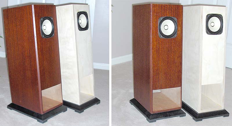

And these were built from the drawings at post 539?
What would a stand height be on these or can they be
used a 29 " desk height?
loninappleton said:And these were built from the drawings at post 539?
Yes, we just scabbed on a couple extra pieces on the side to give them the same aspect as the Fostex FE126 design... if you were building from scratch you would just make the sides extend down.

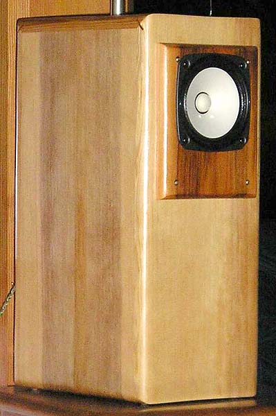

That is the other way to do it... as a stand-mounter... like Scot's attached.

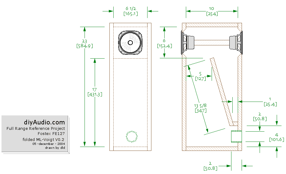

Thanks for clarifying. This reference project seems to
have morphed into a number of designs all with the same
FE127 driver.
That being the case, and since GM has already given a
MLTL design for this (which I built) are there any tweaks
based on theory to go in that direction? Any design
suggestions to improve on that? I'm curious about
triangular shapes and long port tubes as in some of the
builds of the Jordan 92s.

Dave I don't want to criticize, but Scott left the staples in the upper corners of his cabinets. It must have been pretty tough running the router over those.
Yep, Scott's got a lotta 'splining to do bout dat!
Best Regards,
TerryO
TerryO said:but Scott left the staples in the upper corners of his cabinets.
Not a staple... a purpose piece of contrasting wood installed to give a visual accent. the only metal fastens hold the drivers & terminals in place.
dave

planet10 said:Not a staple... a purpose piece of contrasting wood installed to give a visual accent.
An interesting use of a biscuit.
Terry Terry Terry.........
You make me laugh everytime you write.
When I was dry fitting those cabinets I was having a heck of a time holding the corners together. I was intending to glue and clamp the box up in a single process so I decided to put a spline in the corners. Since I could not make it disapear I decided to make it into a bit of an accent. I have a pretty good collection of Western Yew wood so it makes a logical choice.

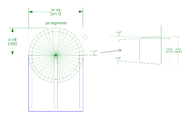

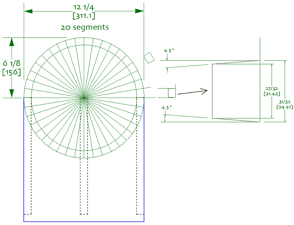

Tombstone:
I hope this works. I got Planet10 to draw this up for me. It breaks the curve up into 20 segments. Set the table saw at 4.5 degrees and cut the sections. Use 3/4 in material. You may need to make a male or female mold for clamping and use a glue with long set time to allow for some fussing about.
If the diagram does not work maybe dave can find the one he did for me.
Good luck
I have not tried it yet
Good luck

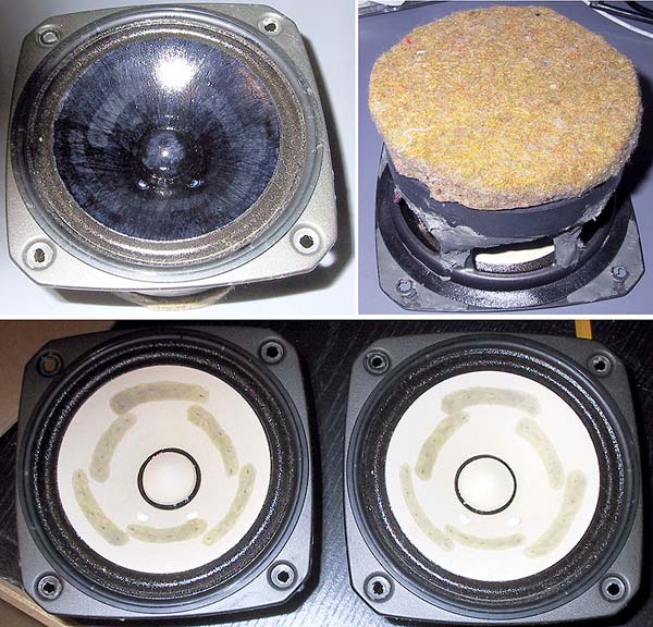

MarkMcK said:... Fostex’ banana paper cones are very noisy with vibration modes. They are much worse than polypropylene or the mag/AL alloy... Cone vibration modes may be independent, loosely coupled, or tightly coupled. Fortunately, several vibration modes in the FE126E cone are tightly coupled. That means that controlling one mode may take care of more than one... two regions of the cone are mechanically modified... The critical regions where the mechanical modifications are made are 9 and 17 mm in from the outside edge of the cone.
http://fullrangedriver.com/forum/viewtopic.php?pid=4861#p4861
dave

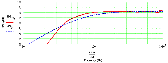

planet10 said:
Sure they would -- sealed (or aperiodic if you want a smaller) box XOed to sub(s)
A box between 3 & 10 litres with an XO of 150 to 115 Hz....
With the success of planet_10 sealed bi-pole for the WR/FR125:
http://www.planet10-hifi.com/sealed.html
I was wondering if anyone has tried a sealed bi-pole for the FE127E?
I have noticed that my BD-Pipes start to suffer in the mid-range (and get ugly in the bass) with increasing driver displacement.
I was thinking that a sealed box may help limit the driver displacement, thus delivering a better mid-range.
The problem is see with a sealed box is that with an F3=120 Hz (23L), a subwoofer would have to cross over at about 100-110Hz and you may be able to locate it. Or, do you think I could count on some bass reinforcement from the room and cross the sub at 80-90Hz?
Anyway, I am always interested in hearing what the others think as I am not sure if I should go t-line or sealed.
Gio.
