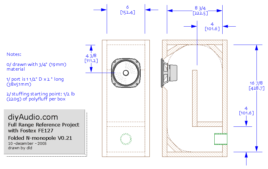

could you repost the drawing?
thanks.

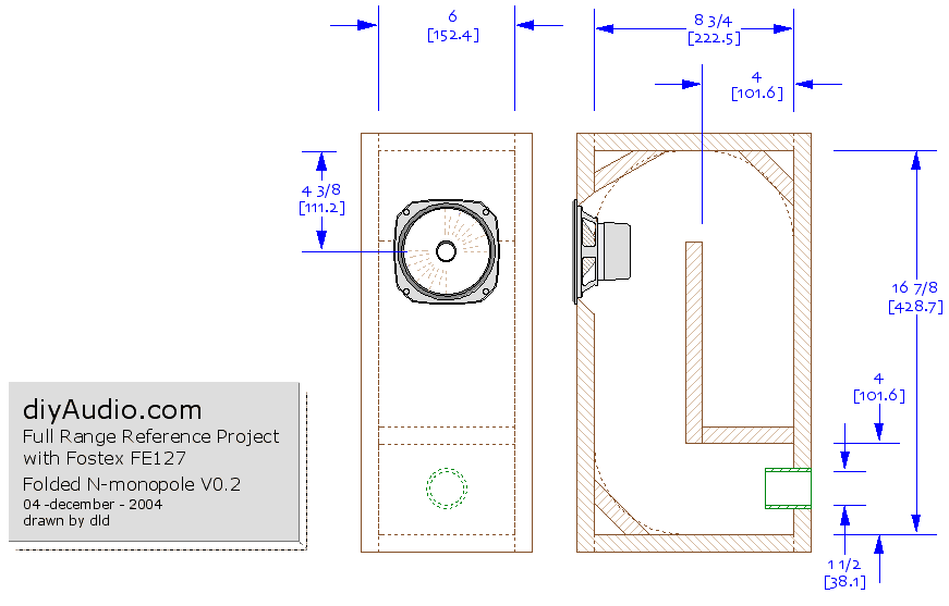

planet10 said:Some questions came in that provoked a drawing of the narrow folded monopole so here is the 0.21 drawing -- actually given that it has been built and turned out well, it should probably be called V1.0
dave
Would this be a suitable enclosure for a FE126E, too?
(edited to attach drawing from post #525)
oodi said:Would this be a suitable enclosure for a FE126E, too?
No...
dave
oodi said:Silly question now... Which would be a better speaker to use with a SE tube amp, the design above with FE127E or the Solo 103 with FE103E?
I haven't heard the Solo (but love the looks -- it inspired the miniOnkens -- we have pieces cut to see how well the design adapts to the FE127). I have listened to lots of FE103 variants but not the current FE103E.
I have heard the FE127E in the above box and it is very nice. The FE127 is not a whole lot more money than the FE103, is 3 dB more efficient, and will produce more & lower bass. I expect the rest of the range to be quite similar. With an SE amp -- if the difference in box size isn't a concern -- the 3 dB greater efficiency is the bit that should really sell it.
dave
loninappleton said:This thread is over 500 items.
thanks.
I have been using FE127s for a long time now.
I'll see if i can grab a bit of time, update the drawings and post them all together in the Wiki.
dave

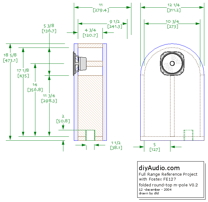

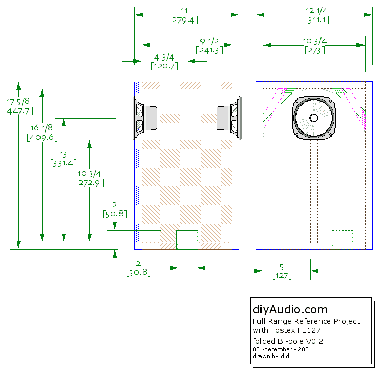

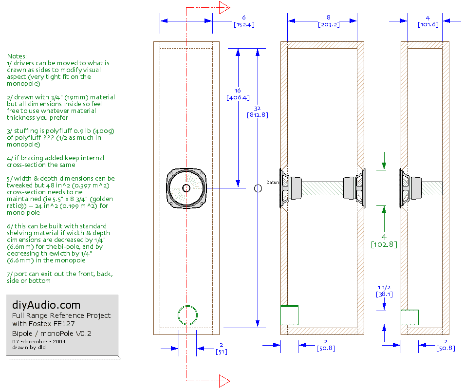

Just to make these easier to find, let me post them all in a row... these probably still need some work, but all the basics are in place....
1st the straight monopoles & bipoles... remember that the width & depth dimensions can be changed as long as the cross section remains the same....
