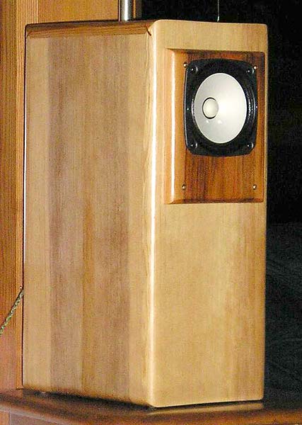

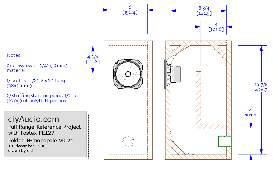

Has anyone built the folded monopole cabinet design on post #70 or #131? I'll be using a sub for lower enhancement and I was wondering which one would be better with a sub.

MPM said:Has anyone built the folded monopole cabinet design on post #70 or #131? I'll be using a sub for lower enhancement and I was wondering which one would be better with a sub.
Scott built a pr. They sound good. the cosmetics on his pr are spectatacular.

I think I'd more likely go with a sealed box, perhaps even a bipole sealed box. A dipole would be nice although it would probably have to be fairly large.
Dave,
Perfect timing, thanks. I was just looking around to figure out what box to try my 127's in just to have a reference as a double check to make sure I'm not off course in my OB pursuits.
johninCR said:Perfect timing, thanks.
It came about because Chris & i were trying to figure what to do with the single pair of FE127s we have after killing 6 of them....

Thanks for the nice comments on my Fe127 folded mono. I have not heard them for a while. The last time I heard them I was very impressed with quality of the mid range. The vocals were excellent and the high range was very smooth. Yah they are a little thin on the bass, no big deal though. I have a sub that we integrated into them to bring up the bottom end. For 2 channel audio I like them.
