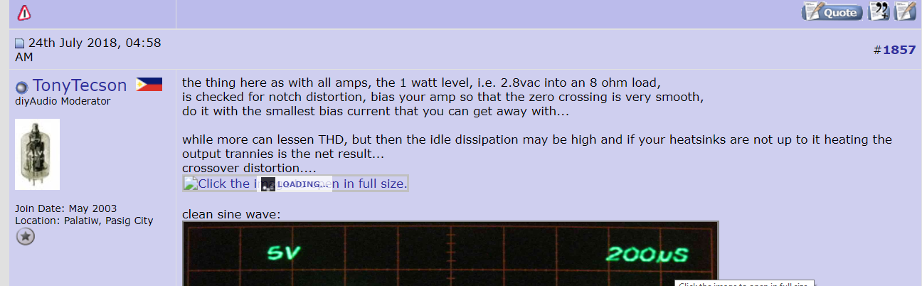

Hello Tony,
Could you attach the images to post . I am not able to open and see the first image. I don't know why. Post no. 1857
Regards
Prasi
Regards
Prasi

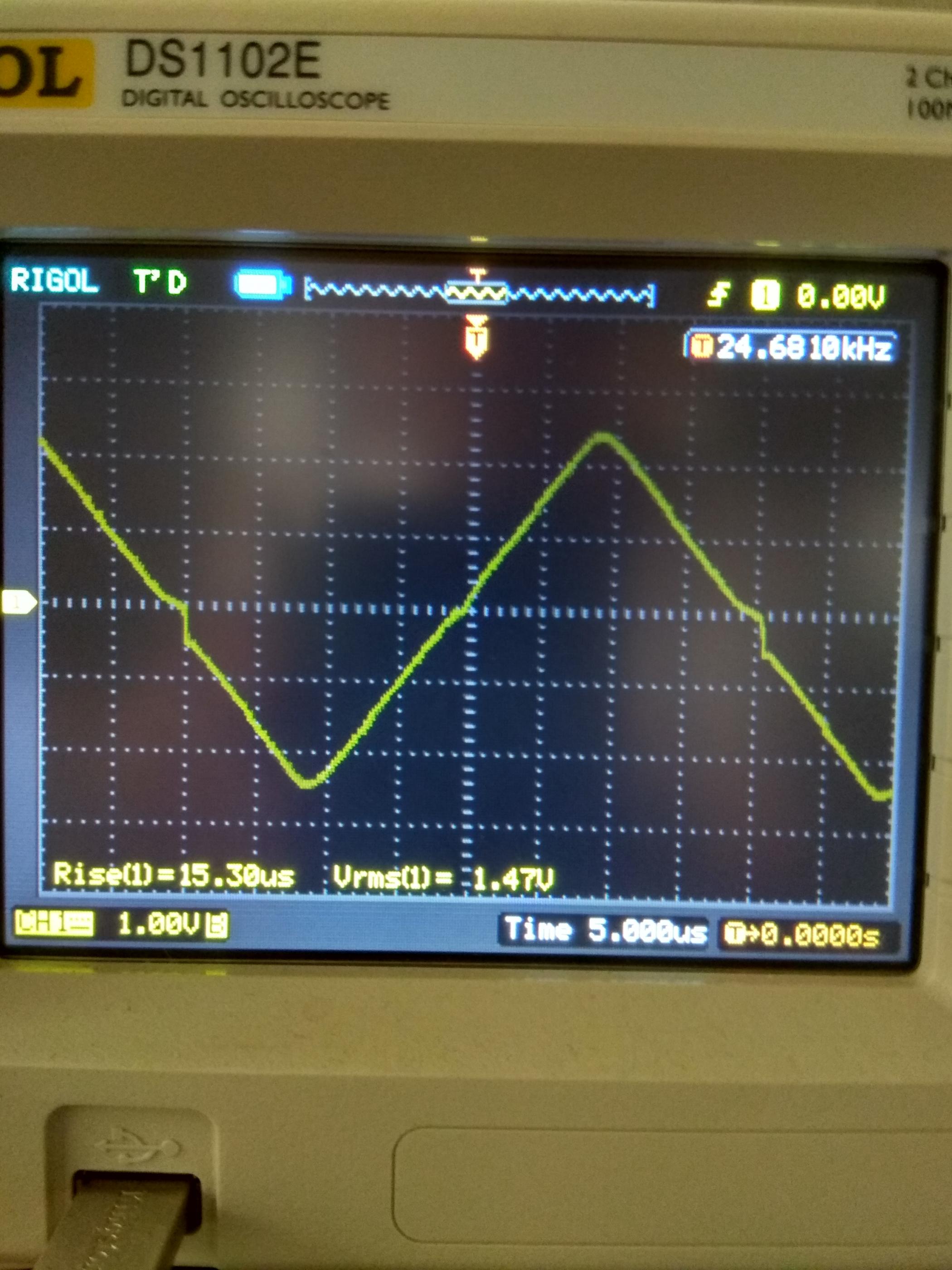

I'm using triangular waves when check for crossover distortion.
More visible than sinusoidal waves under same conditions.

Thimios, is that scope connected from speaker output to ground or VAS stage to ground.
VAS to ground would show the correction signal.
This is the output on a dummy load.Thimios, is that scope connected from speaker output to ground or VAS stage to ground.

the first link in the post #1857 doesn't load for me.
it does the "loading...loading...." thing all day long, without actually loading any image..😀
screenshot attached.
