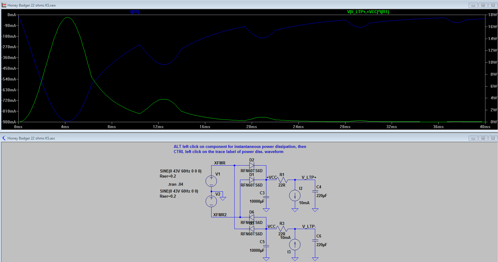

As an ignorant followup question - one that I have not seen addressed in this forum - is the subject of power up behavior. We are all familiar with what happens in the power supply at turn-on and the heavy current inrush due to toroid physics and due to empty filter caps. What general assumptions are made to specify transistor voltages so that parts will not smoke at power-up? Should we assume that the input differentials and the VAS transistors could individually be subjected to the full rail-to-rail voltage even for an instant? Thus if +/- 60 volt rails are used, must the transistors all be able to withstand at least 120-150 volts. I've seen the results of poor design choices in commercial amps like this. Smoked parts when using the power switch. Works fine if brought up slowly on the variac. Naturally the problem was not seen in production testing because each amp powers up differently based upon part tolerance.
RA
Regarding power-up.... people forget the (front-end) resistors on the rails, V2.2 I think (R32/R33 1/2W) 22R and 220uF have to charge up to 60V during power up. So a 17W few msec inrush on LTSpice sim, not sure what people are using but careful the resistors can fail open circuit. Old carbon comps can handle this 34X overload but metal films are in a gray area I think.
