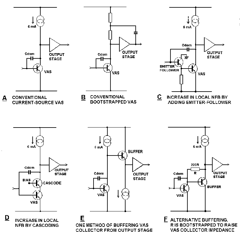

Has anyone looked at alternate VAS topologies for the Badger?
I added a buffer between the VAS and EF2 OPS of a very badger-like amp. Douglas Self shows such a buffer as figure F in his diagram of possible VAS variants:
This keeps the VAS transistor sinking a near-constant 3mA. From the VAS' point of view, the buffer makes the EF2 look a lot like an EF3, a much lighter load. Could we call this an EF2.5 output?

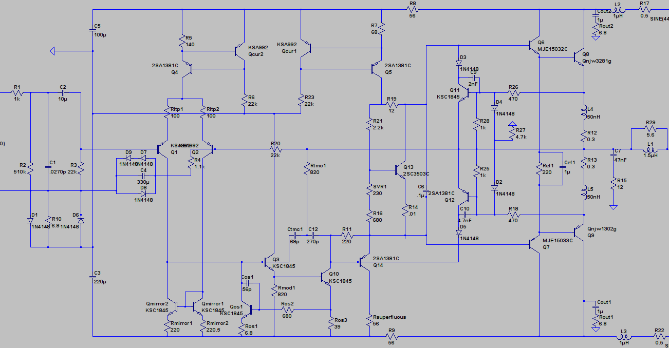

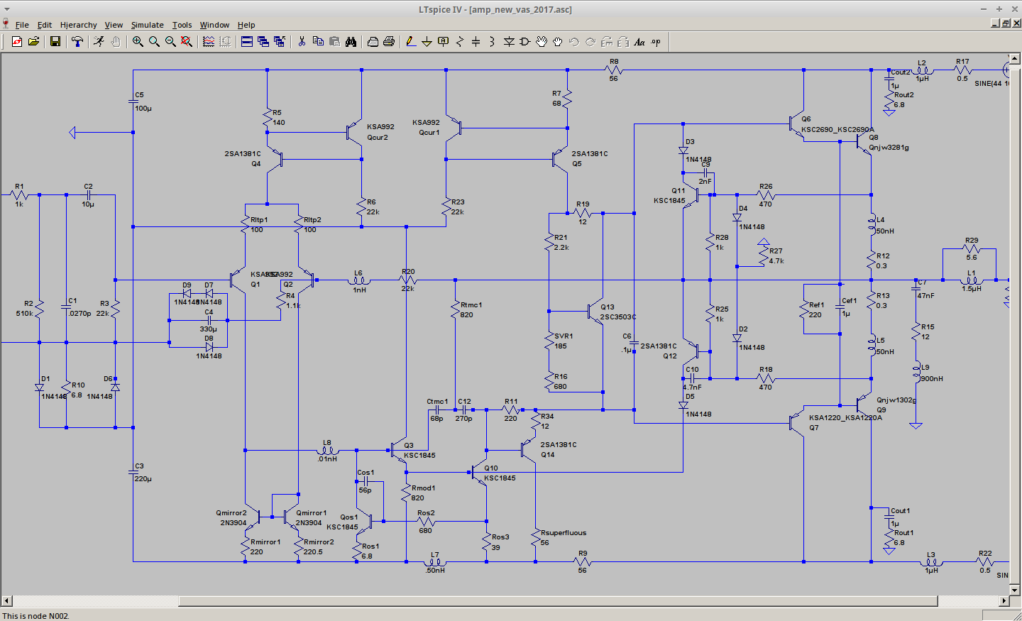

Before and after schematics are attached. Q14 and R11 are the additions. I also adjusted the CCS feeding the VAS from 4.5mA to 9mA. (The VAS with output buffer can sink more current, shouldn't we be able to source more too on the other side?) The new version simulates with a lower distortion floor, about 10db lower. It's not a bad return for adding two elements.
Note the SOA protection circuitry dumps current to the VAS transistor, not to the buffer.
It's playing now. Subjectively this mod seems to help the amp play into a 4 ohm load (Klipsch Fortes) that it was sounding dull with before.

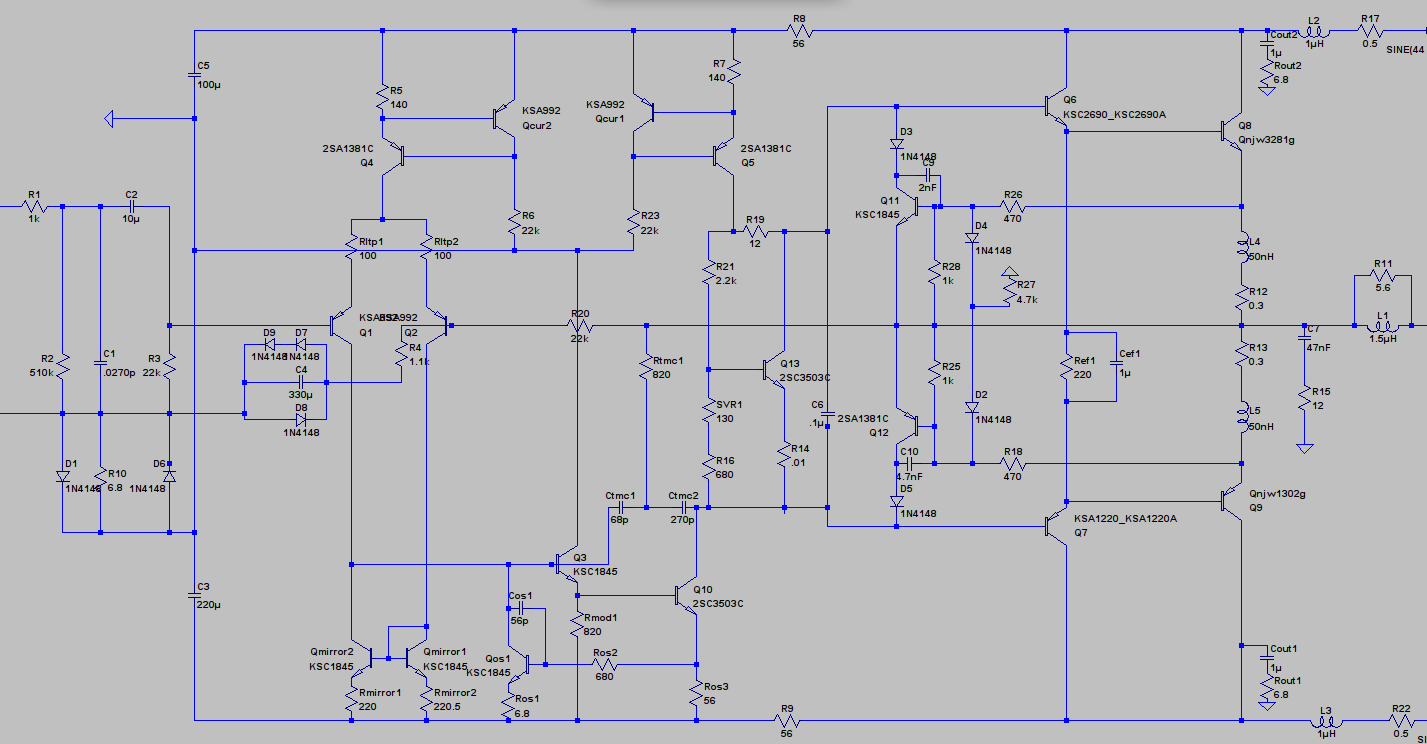

Oops! The "EF2.5" OPS above oscillates, which can be fixed with emitter degeneration on the buffer. New schematic attached.
It was oscillating with no load, with amplitude ~100mV and at a few 10s of MHz. It wasn't enough to be destructive, but let's not gamble. The oscillation happens on the real amp, and you can see it in simulation by removing the load and putting 600nH of parasitic inductance in series with the Zobel network. The real amp has a nice long Zobel return wire back to the ground star, it must be 100s of nH at least.
What loop was oscillating? It's not the global NFB loop or TMC loop; if you break both of those with 1GH inductors, AC sim still shows peaking. My guess is that this is the well-known effect where an EF, or chain of EFs, can oscillate in the absence of enough load. Adding the EF2.5 buffer makes this amp more prone to it. You want EF3-like performance, the cost is EF3-like stability concerns.
Base stoppers at the drivers and outputs help some too. A base stopper at the predriver buffer makes stability worse in simulation, oddly.
The revised design is below. I also replaced the KSC1845s in the current mirror with transistors that are free of quasi-saturation behavior.
So there you have it, the EF2.5. It's near-EF3 performance, can be retrofitted onto an EF2 OPS by adding one Q and two R's. It's probably stable? Have fun 🙂

In the simulation your zobel inductance is shunted by R29 and the load resistor. Give the load about 1uH of inductance or more like we would see in real life.
You're right. That puts a shelf back into the response roll-off at about 20MHz. Thanks. This design needs a clean RC zobel.In the simulation your zobel inductance is shunted by R29 and the load resistor. Give the load about 1uH of inductance or more like we would see in real life.
