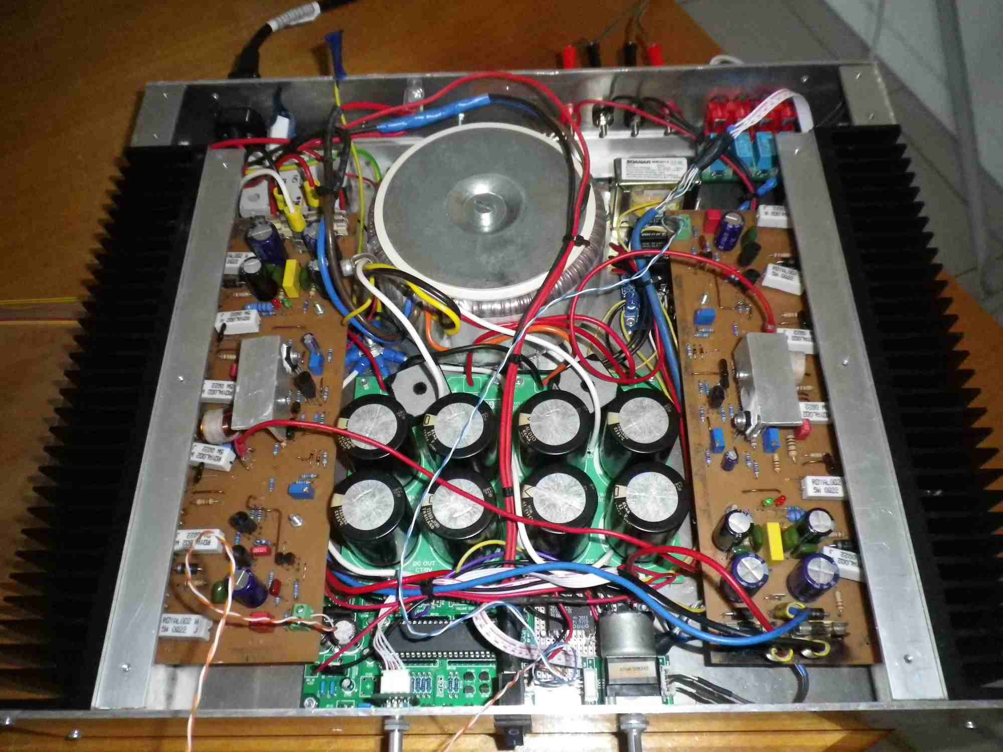

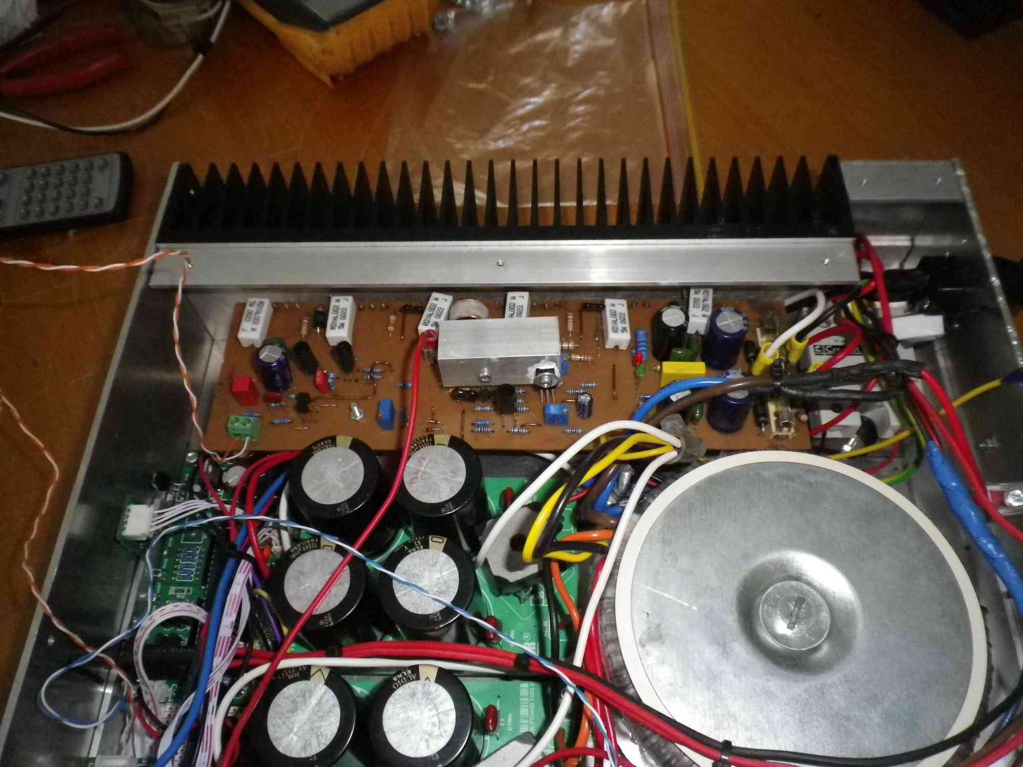

Just been testing my amp. The output emitter resistor voltages seem stable. The only thing I find is the VAS heat sink(in middle of board) gets a bit too hot for my liking. Is it best I make it larger or change the vas emitter resistors?

Read OS's recommendation on the VAS, different R27 gives different VAS current. Beware, changing R27 will have an effect on output bias so start all over again if you change R27.

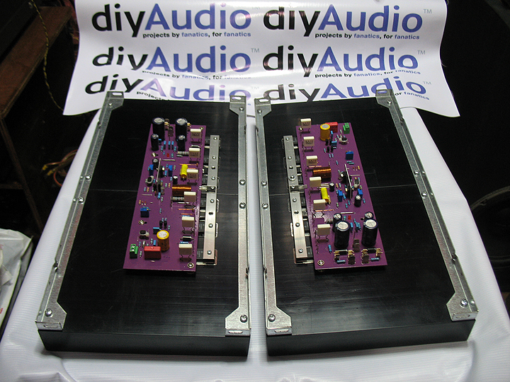

Is it just me and my eyes or are your boards flipped?
I mean, with the board's opt side away from you, the input should be on the right and the power supply on the left... 😕
looks like it will take some serious beating with those heatsinks
nice use of the alu bar across the outputs
and also the upsidedown mouting, placing outputs at lower half of heatsink
Thanks! Yeah it's been playing hard for hours, connected to an iPod Touch via LOD and a passive pre and the sinks only gets barely warm. 😀
I would have opted for the Vbe on top of one of the opts but me and the guys decided on using a thermal bar. It looks good with the alum bar, very symmetrical.
Yes it's upside down, the opts are on the lower portion of the heatsinks, though in the video, you'll see the opts towards the top to facilitate probing the bias and other stuff.

Reading 0.544V across R27(68r) = 8mA.
Yeah my boards are flipped. I accidentally produced my boards as a mirror image so transistors to the heatsink are underneath. Components on top had to be installed as a mirror image.

Just about right on the VAS, I'm running our prototype at about ~10mA with 56R for R27. As you can see in the video, after 2 hours it still remains at no more than 47 degrees Centigrade.
I see, I thought my eyes were failing me when I saw the orientation of your pcb. 😀

Am happy with VAS now. Changed R27 to 100r and reset the bias adjustment a little lower than before. Also doubled the size of the vas heatsink. Now it runs nice and cool as I like. I have access to one of those laser temperature probes as on your video at work so will use it when I get the oportunity. Thanks for your help.

Cool. The heat from the VAS is quite constant. The recommended heatsink was more than enough to maintain temps below 50*C even with higher ambient temps. I live in a tropical country so it gets kinda warm during the afternoon.
