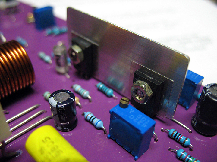

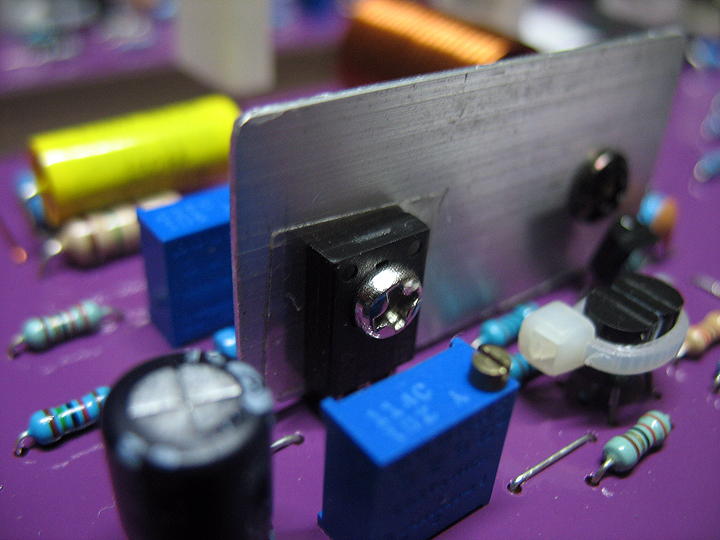

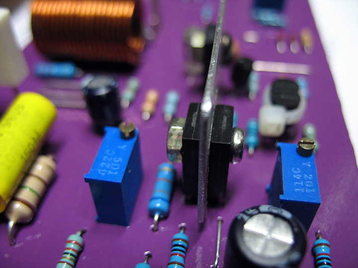

Mounting Q10, Q11, Q12 with a piece of aluminum as heat sink...
Q11 and Q12 are mounted back to back with each other using only one bolt...

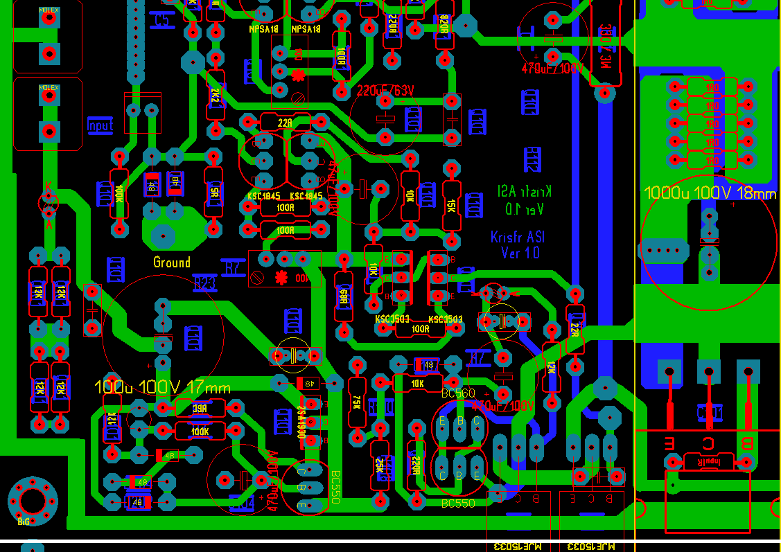

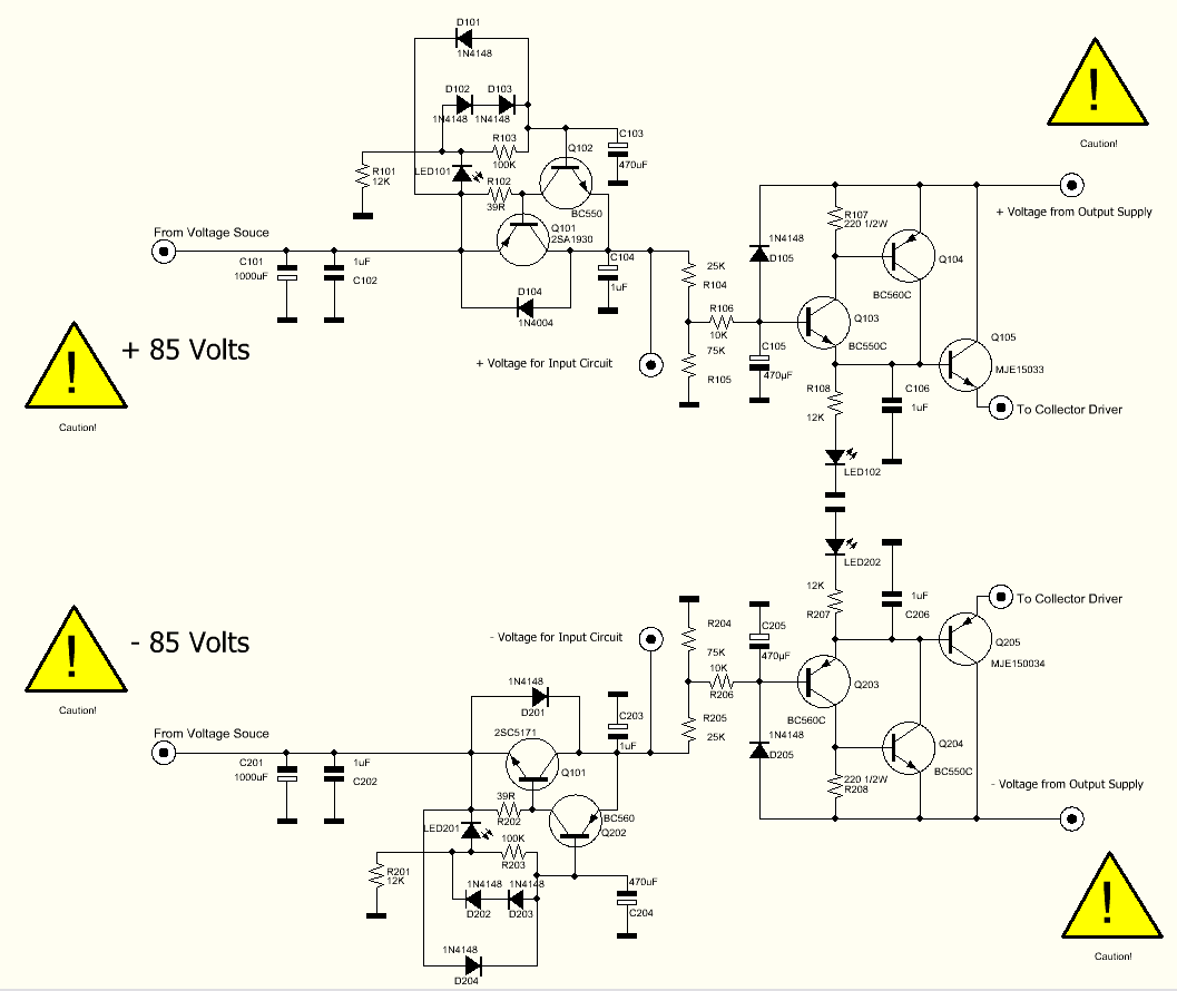

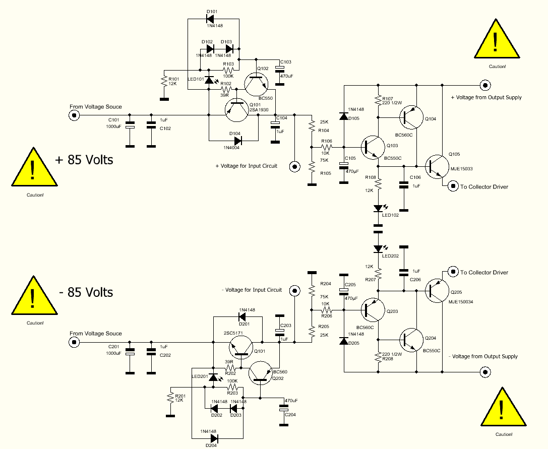

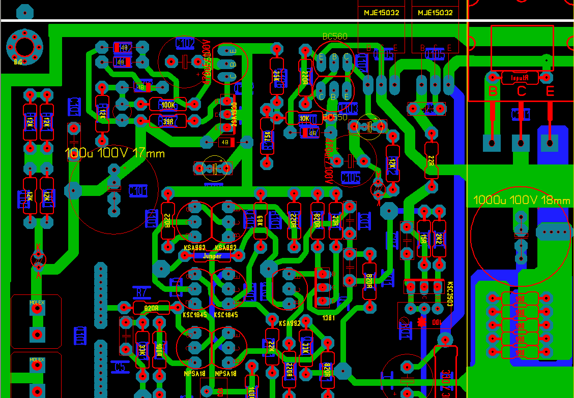

That error is on the schematic, but not on the board, thankfully.
The C and E of T3 are shorted!
- keantoken

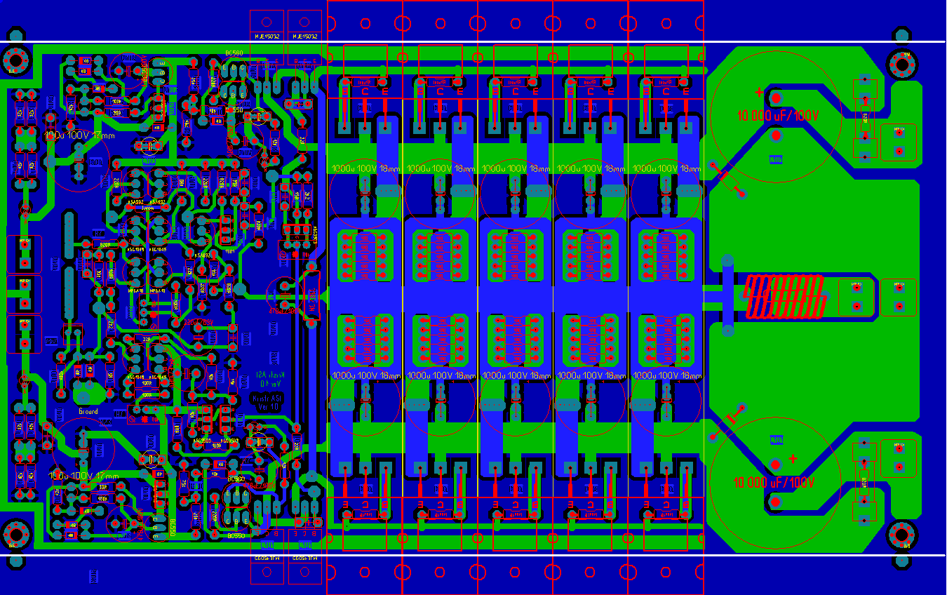

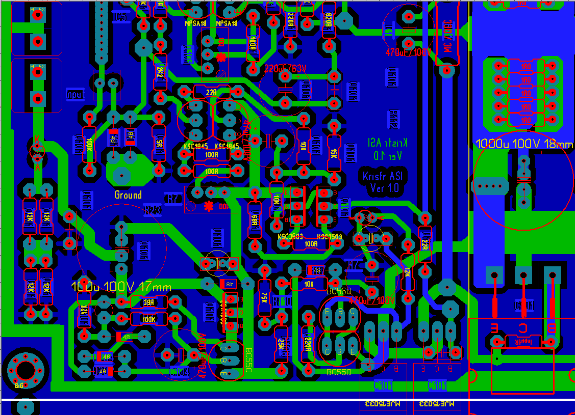

The PCB layout program sometimes changes the coordinates of trace points, when I duplicate the board. I dupe the board to save a version.
I have corrected the noted problem...
I am very busy with another project at the moment, I will post more readable visuals shortly.

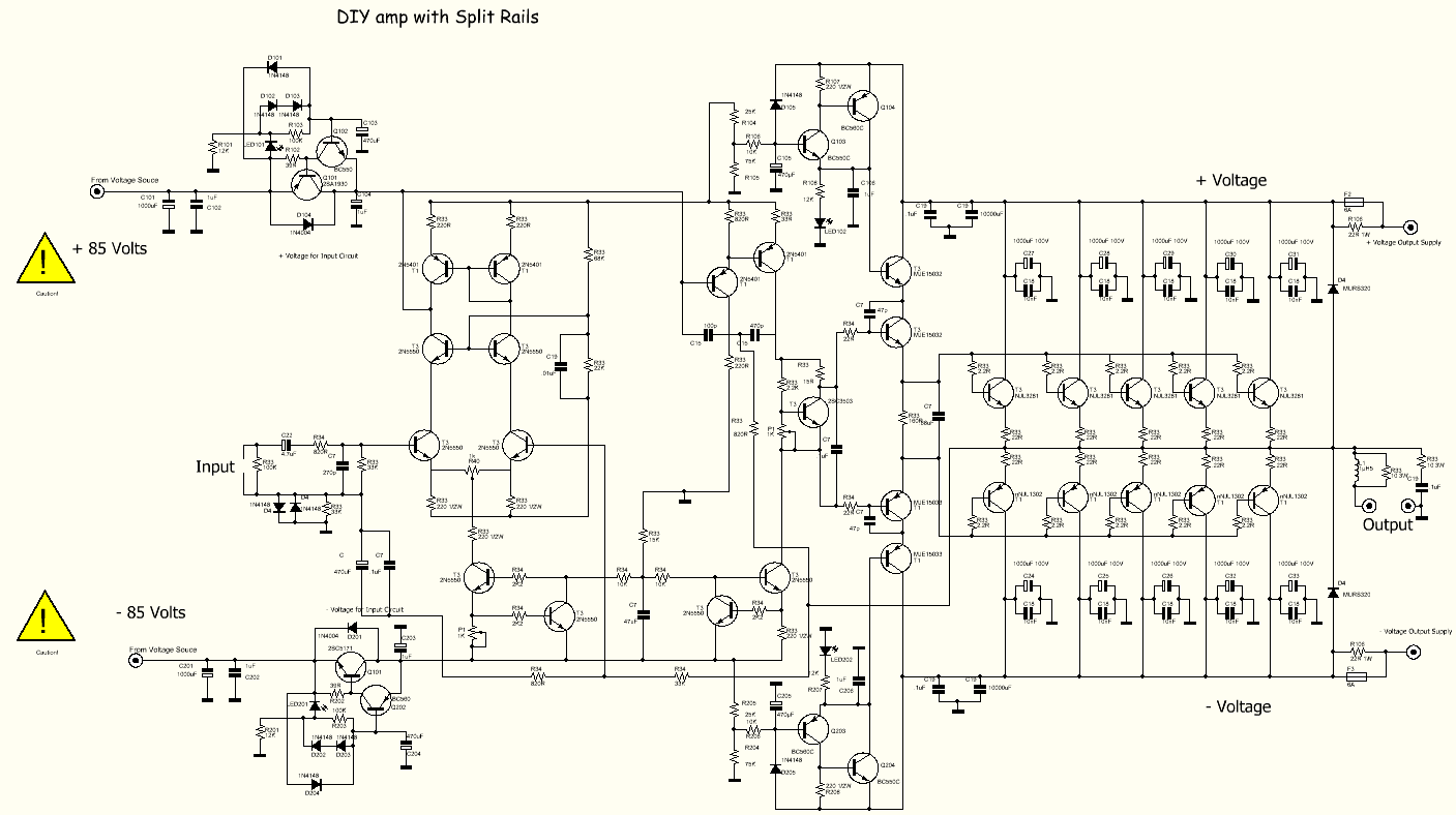

Here you go...
Please comment correct or otherwise, I want to get this right... and I am open to suggestions for improvements too.
I am willing to share this with anyone that wants to DIY.
It, the board is NOT done, I have to mark the parts on the ground plane. I think it can be made with one side with jumpers. I will strive to make it doable one sided.
Also the schematic for the power additions are just what you need to add to OStripper Schematic...

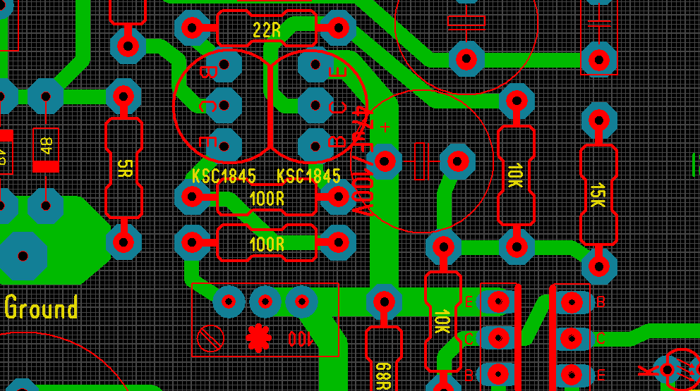

Krisfr, is it possible you can make the text cut out of the ground plane, instead of having to clear space around it? Seems like something sensible any layout program should be able to do.
D104 and D201 still need to be reversed on the schematic and the board.
It looks to me like the input stage CCS is all foobar'd.
- keantoken
- keantoken
Done on both
