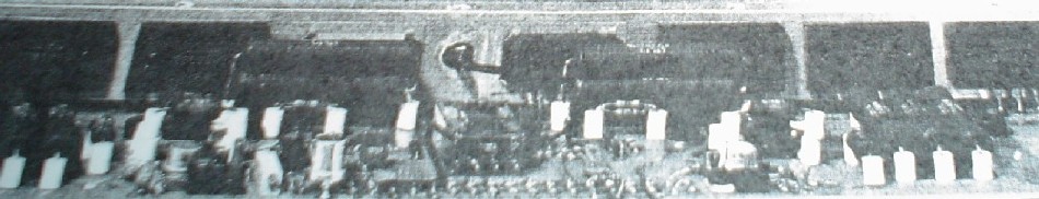

Unfortunately I didn't do that. I have uninstalled the soft start. I was playing music at work through it for 12hrs ok. Took it home this morning and did some loud volume tests. After about an hour I heard music go soft and then stop so I run to the amp only to find 2 fuses popped on one channel and the resistors across the fuses in flames. Turned poweroff and blew out the flames. It seems I have 2 blown npn transistors and 1 pnp power transistor. I wonder if they might be fakes that can't handle it when decent power is drawn??

Have tested power supply without being connected to amplifier board and I get +ve and -ve 61v rails and bulb is not on. (ok)
When connected to amplifier boards +/-ve 50vdc and bulb is on very very slightly(hardly glowing)?
Theres some issue with my amplifier board somewhere.
What is the best place to start now? Maybe remove the power transistors and driver transistors and see if input bumps back up to 60v?
Edit Just found a shorted Q15 driver transistor.

I assume page 1 schematic is current, showing Q12.13 as drivers MJE15030/1. They are T0220s and able to drive huge current (8 amp max.) - much more than the little TO126 video drivers you ask about which are only suited to the VAS duty (200 mA). In a word, Nope!
Indeed, if those drivers blew, you have a serious problem there, whether the outputs were fakes or not. I hesitate to go further since you already had several hours smooth operation. From that point, you could have had oscillation or thermal runaway. This could have been triggered by the air temp. rising gradually, sense transistor not in good contact or simply the programme.
You need to get it going again with those big drivers though and scope it for oscillations or simply note excess heat for the bias current used. Expensive, aren't they?
