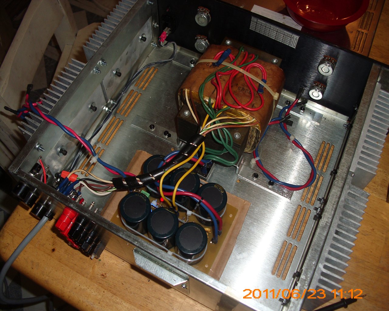

50kuf for a stereo pair or 25k for each. Double that for lower ripple.
I have my "6 pack" for a similar OP stage X 2 -
6 x 8200uf -100v Apex jr. samwha caps. CHEAP -15$ + PCB +35A bridge.
OS
suggested trafo
2 X 300Va standard 38-0-38v E-waste trafos (or new ones). 1 X 600-800Va / 40-0-40V unit , either choice will require a soft start. 2$ "el cheapo" will do(below 1+2). Started the above PS 100's of times -- works real nice , can use the trafo ac direct or the 68V positive rail to activate.

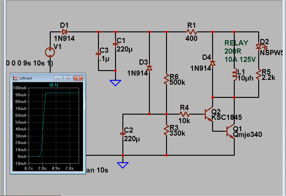

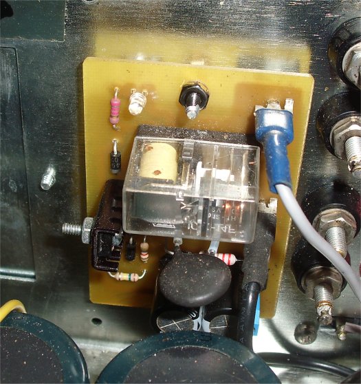

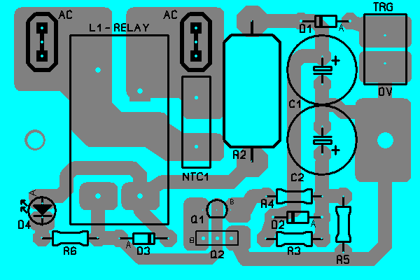

Here ya are , full S4 "super simple soft start" (I have 2 working , made the first 2years ago) 50mm X75 (below) , any junk microwave oven single pole relay will work. 😀
Whole "package" below ... S4.zip...
If you want the power supplies , too - I have the "6pac" (external 35A bridge) and the "4pac"( snubbered 10 A flatpack bridge). Both built and working nice. 6pac is good for 1 big PS , 4 pac's are good for dual mono.

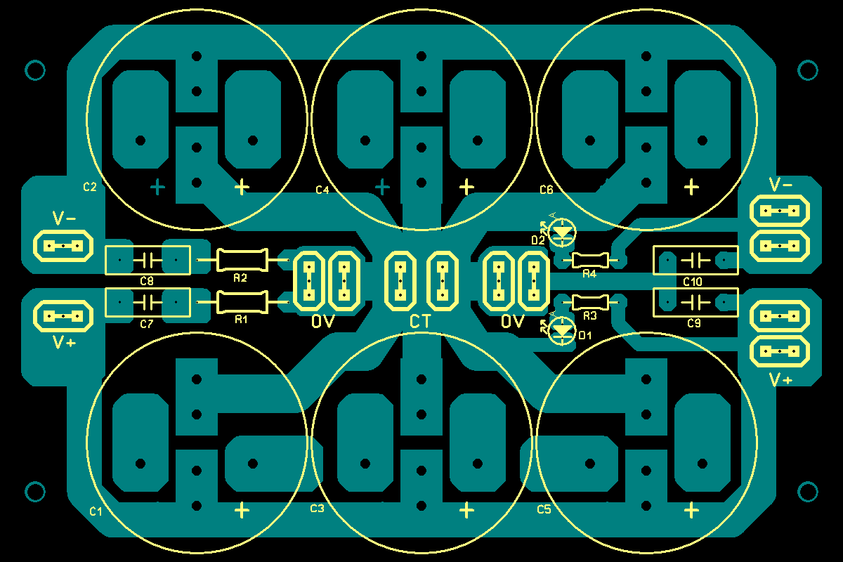

6PAC - proven simple PS
Here is the "6pac" (below)
full package (below- attached)
-better than the EBAY ones
- true star ground
- takes the APEX JR. panasonic or Samwha 2-3$ cap's- (22mm LS 4 pin) AND 10mm snap-ins.
- built 10 of these for my "bar-room" ebay amps.
-SUPER durable...
-100mm X 150mm.... not much bigger than the 6 caps themselves. 2 would fit a dual- mono setup for 100Kuf. 😱 (overkill)
"4PAC" is next ... my "test"PS and a smaller package (10mm snap-ins - 75mm X 100mm total) these are good to get rid of all your "loose" (extra) caps. 😎
Enjoy...
