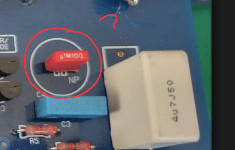

Hi all,

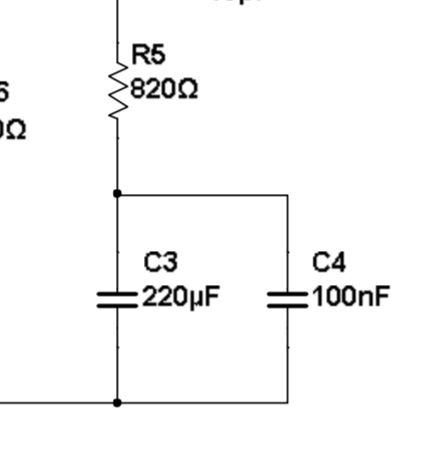

I'm building a new amp board. Following the 2.5.4 schematic I note that C4 has changed from 220uf to 100nf 100V. I have spent significant time trying to locate that capacitor with a 5MM lead spacing. Really looked around the corner. Appreciate if anyone has some spares or can point me in the right direction.

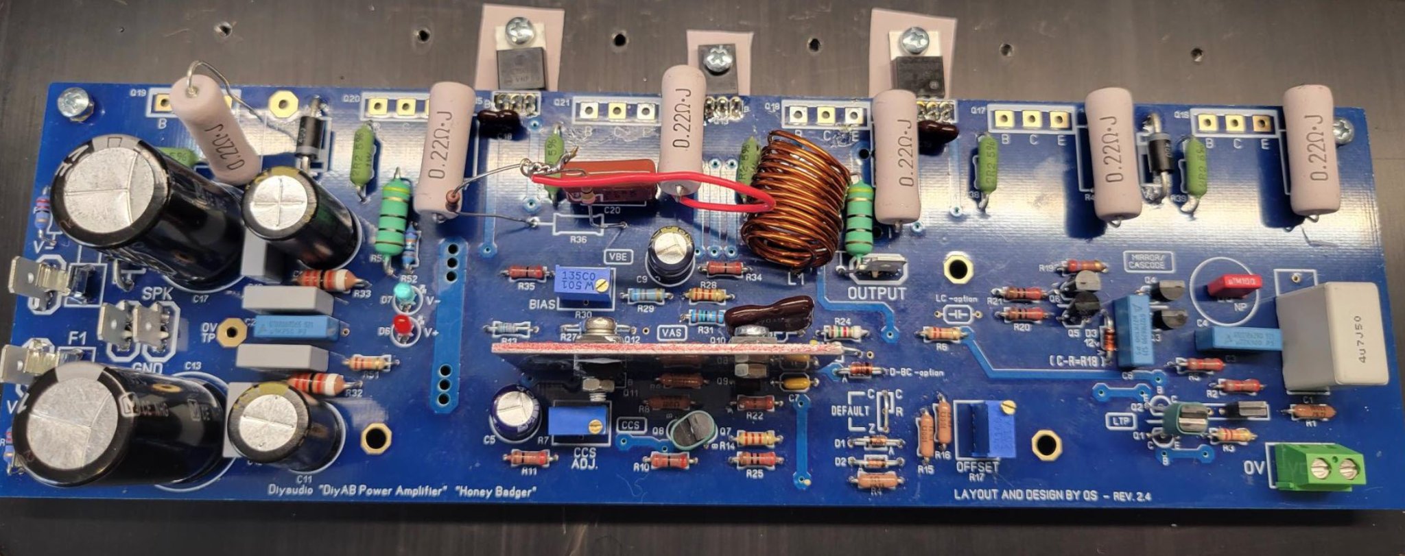

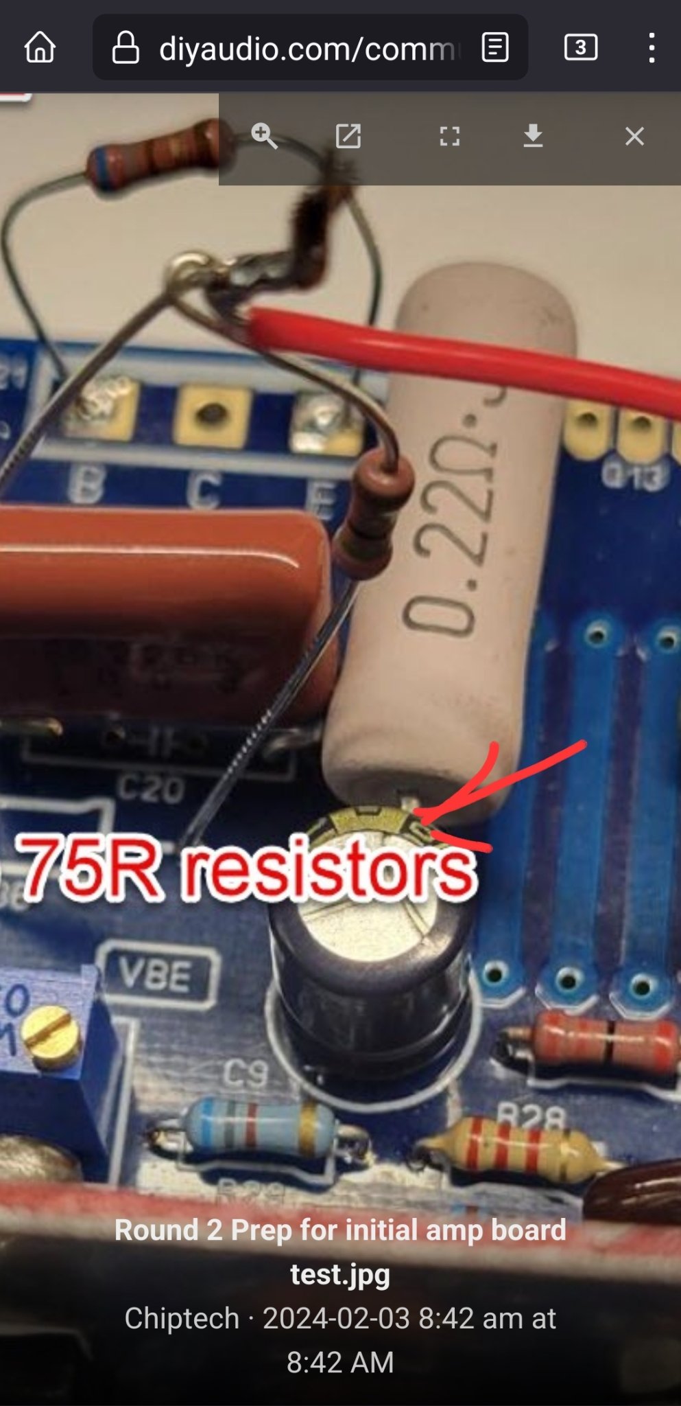

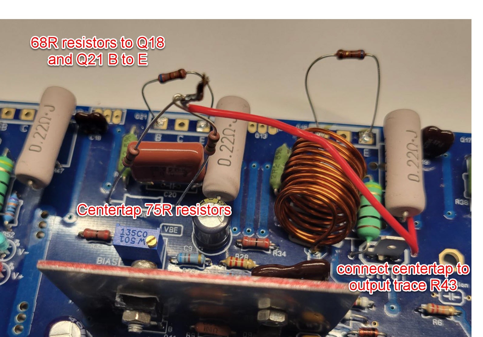

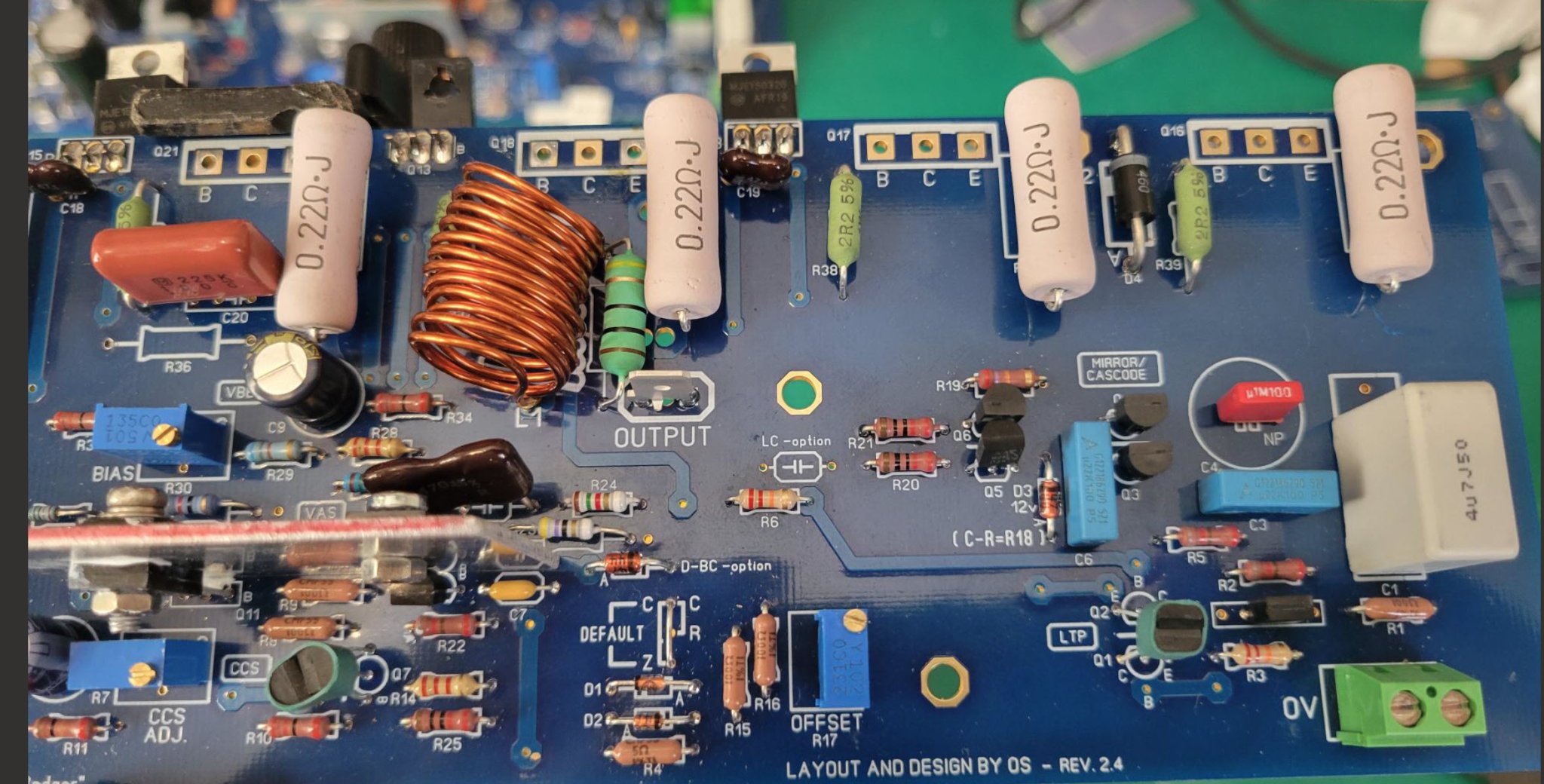

I have a new board ready for initial test.
Do I have this set up correctly? I'm not quite sure about where to connect the center tap to the R43 output trace.
Can I use this with the DBT as I don't have a regulated supply?
If not, I'll think harder about acquiring one.

The resistors you have in place of the output transistors are doing the same thing as the two 75 ohm resistors. Two different methods of doing the same thing. Use one method or the other, not both.
You need to install the drivers (Q14 & Q15) and the bias spreader transistor (Q13) before doing this.
You can do this with the DBT

Its a bit hard to see exactly were you have the wire going from the centre of the Two 75R resistors. It just need to go to any node on the output trace. The bottom of R46 for example.
I'm not sure what the resistors from Base to Emitter are for. Personally I have never done that.
Yes... All transistors should be installed.

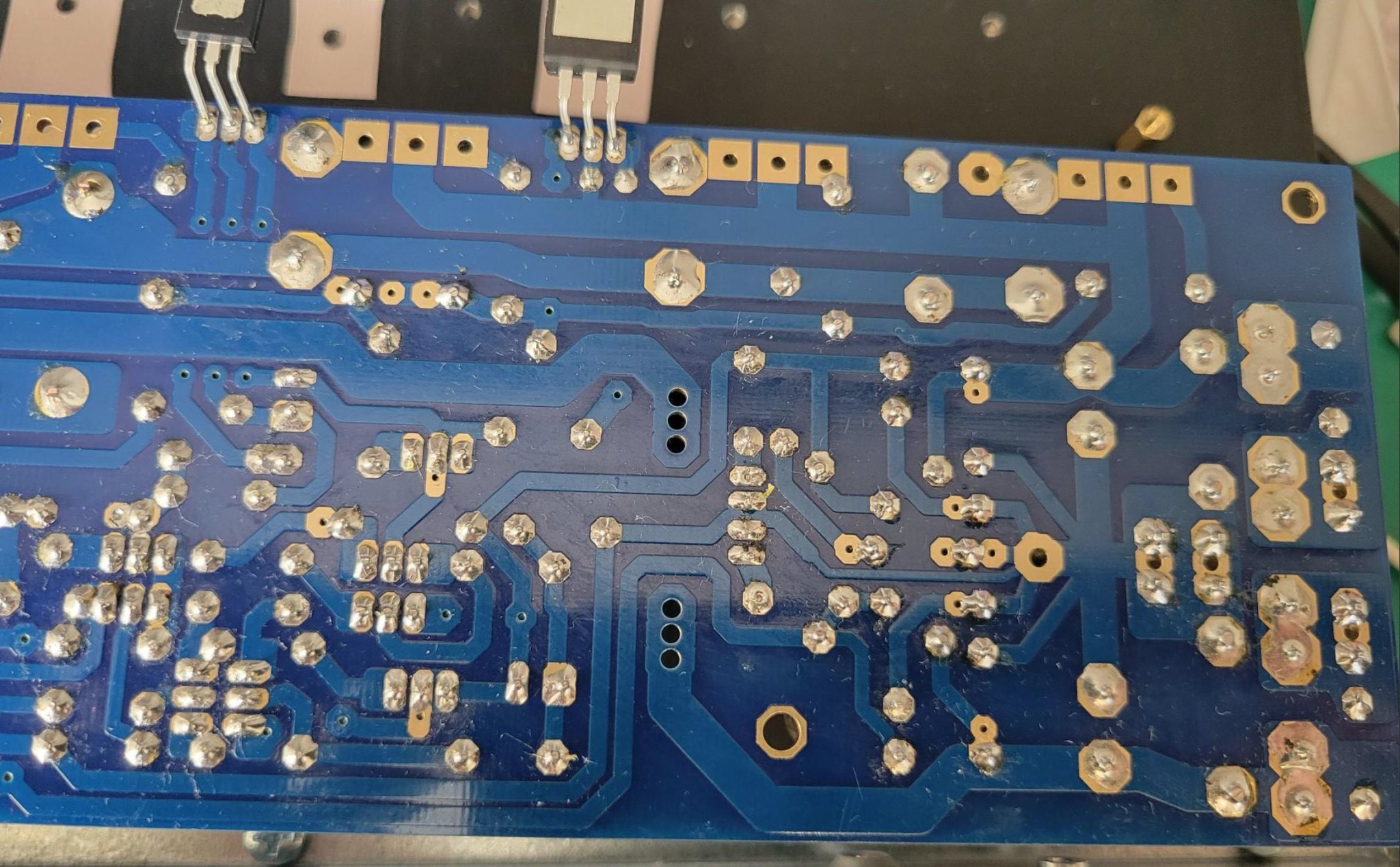

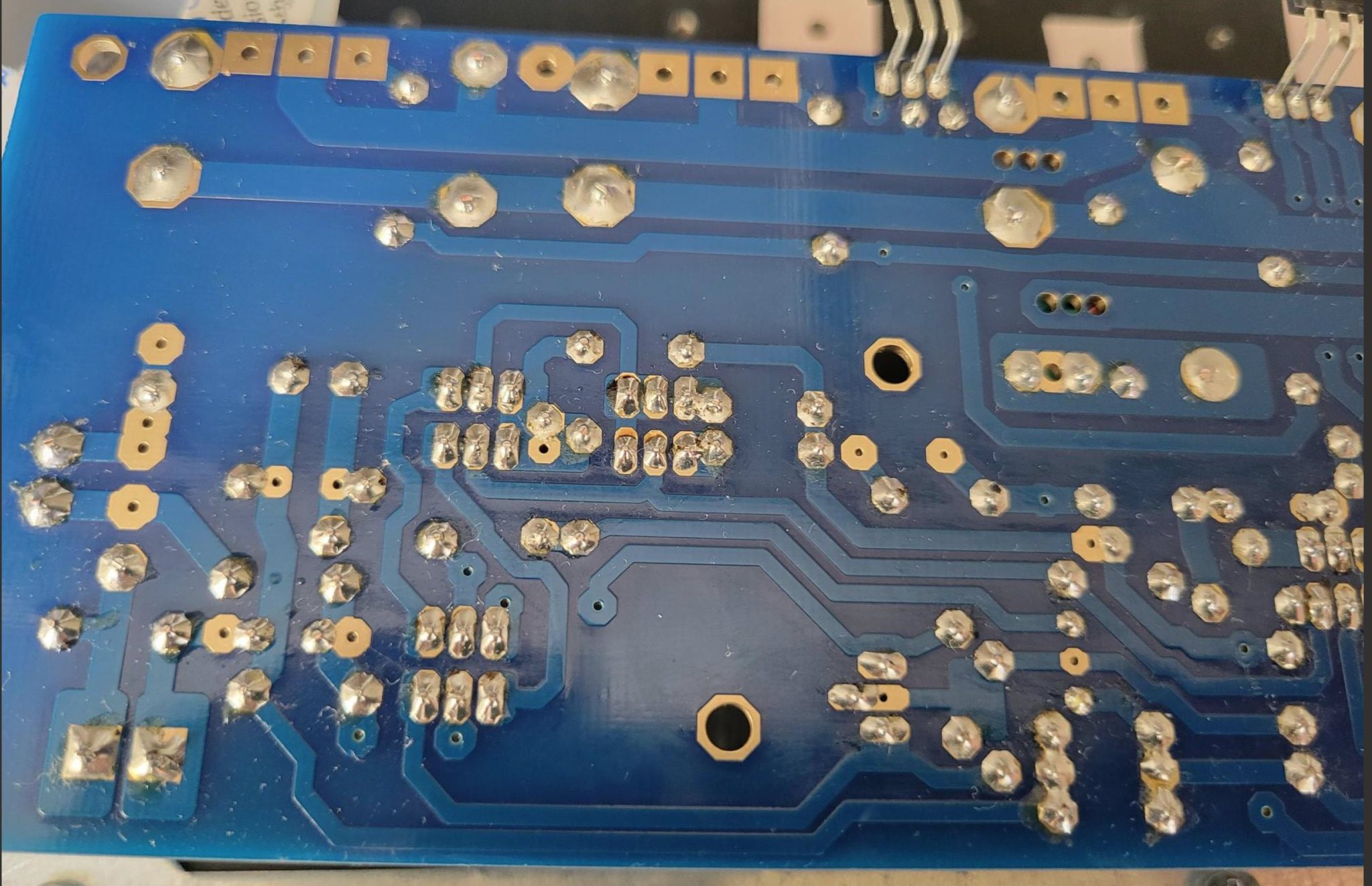

And you should some more images of the board. Top and bottom.

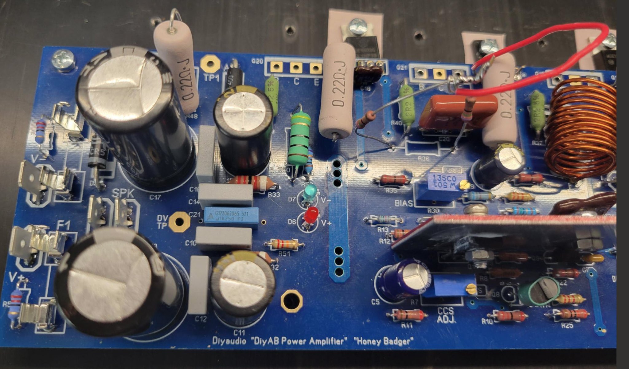

See photos below.
I have the centertap soldered to the R46 resistor.
Below is a powering up checklist and bias plan:
Pre-flight Check List
Set pots:
R7 set to 80R
R17 to midpoint
R30 sent to max resistance
Attach power from PSU: V+, Ground, V- [Grd goes to left grd tab]
Connect DMM’s
10R resistor
TP1 & TP2
Across R14
Ist [Quick On-Off] Test With DBT
Read DCV across 10R resistor = close to 0V
LEDs turn on
2nd Test – Initial Biasing With DBT
Connect DMM to speaker output – speak grd
Adjust bias:
R7 = 8.25V
R17 = > 0.5V
R30 = 15-20mV
3Rd Round With DBT
Remove 10R resistors
Install 4A slow blow fuses
Remove center tap and install R36
Install output transistors
Tune Bias
4th Round
Remove DBT
Final bias adjustments
Appreciate any further thoughts, otherwise, Sunday its game day.

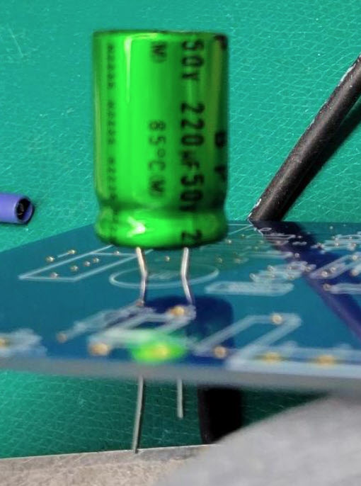

Chiptech,
Is this a new board you built, or did you redo the old amp board? Also, the parallel contribution of C3 and C4 needs to be at least 100uf. In this case, there should be a 220uf (preferably non polar) there. The bypass cap is just a nice option. I think the schematic goofed on the part number as it pertains to the silkscreen, which is why it might be confusing for some folks. This is part of the feedback section and it is important.
