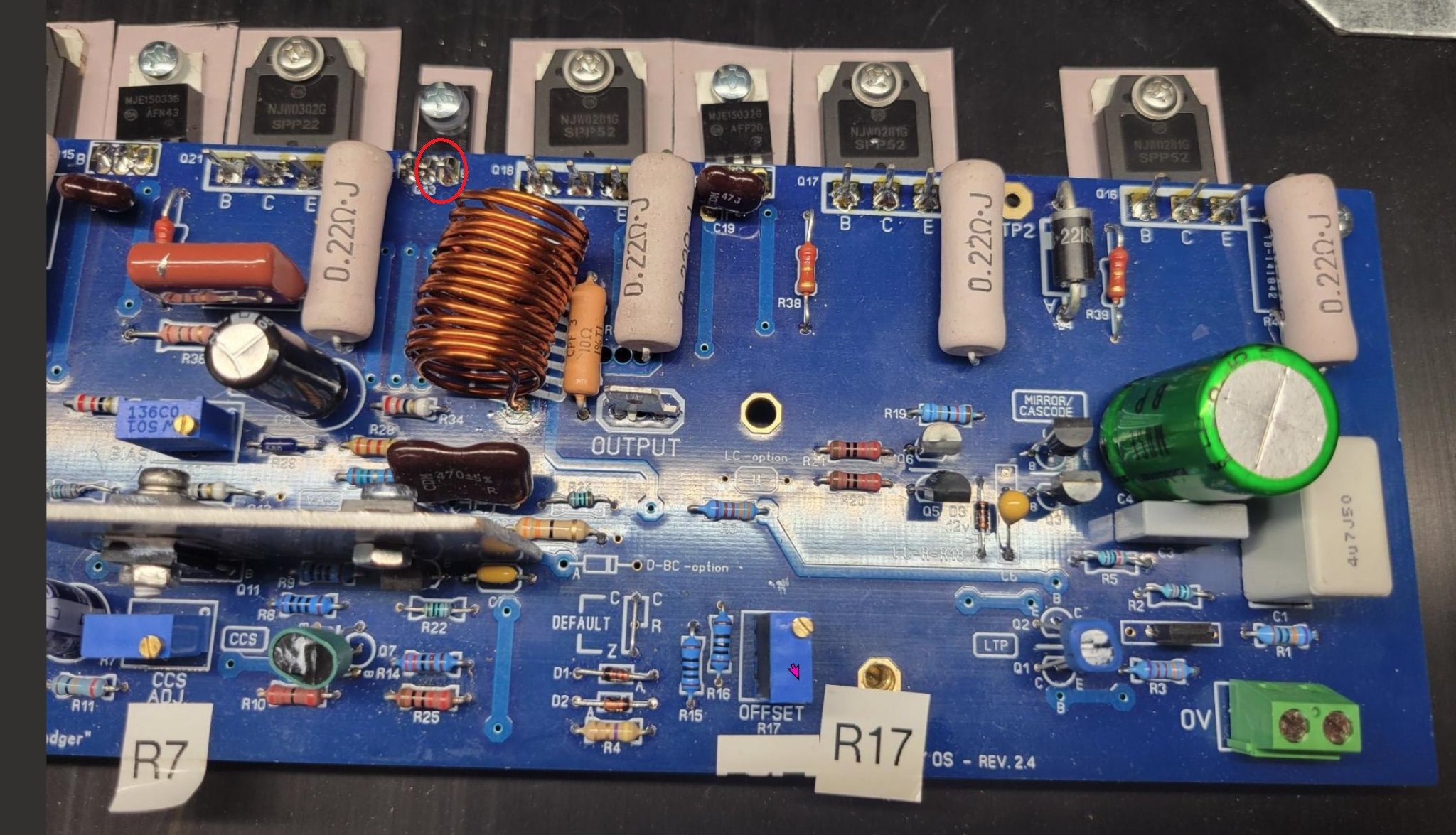

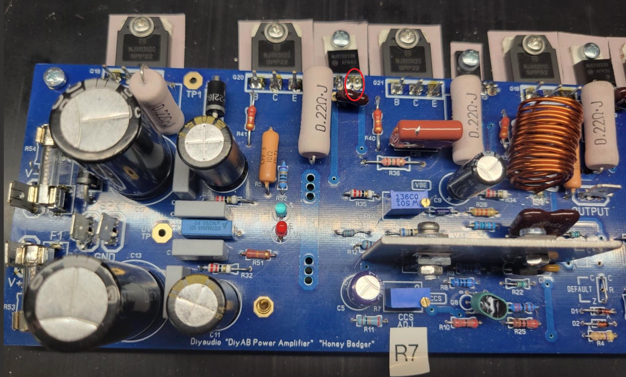

I know that ENIGS solder worse than HASL pcb, but these are probably the problem spots, you can't see them well, but it seems like the pads are connected, ...
Reactions: 69383

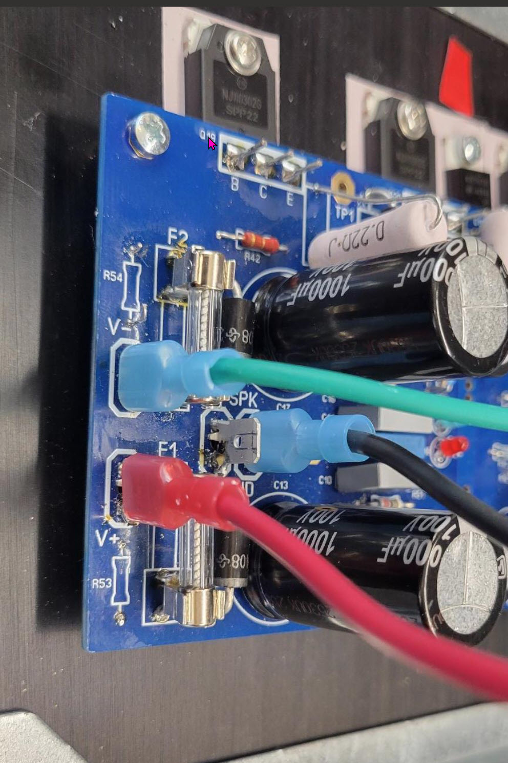

No voltage. No LED lights.
My PSU board is putting out 63DCV +/-

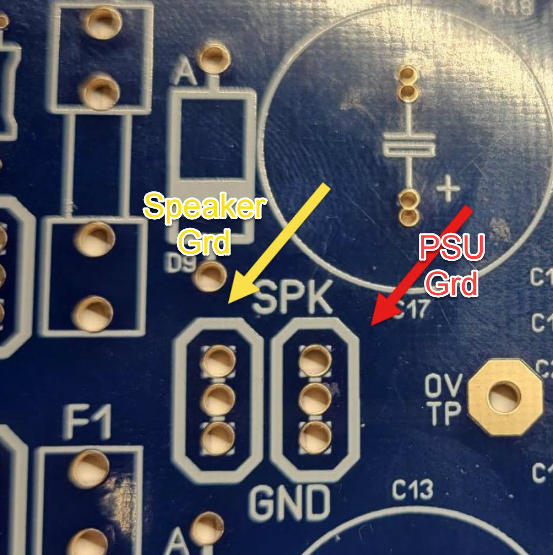

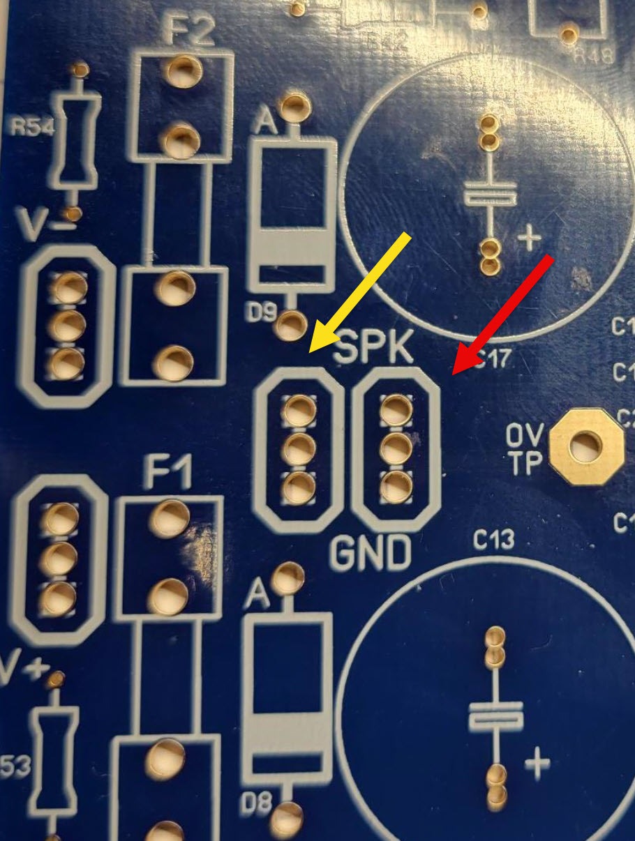

The negative from the PSU goes to the ground [yellow].] and the TP1/TP2 DMM lead goes to the adjacent ground [red].
Your PS must have three terminals: negative, positive and ground. You connect PS ground to onboard ground which has two terminals, one for PS ground and one for speaker ground. Your yellow and red arrows point to these GROUND terminals. You connect PS negative to V- terminal on the board and NOT to where you connected it (yellow arrow), that is GROUND TERMINAL. You connect your PS positive to V+. Remember: your PS must have THREE (3) terminals: positive, GROUND and negative. PS Negative goes to V- on your HB board, Positive PS goes to V+ on your HB board and PS Ground goes to board Ground described as SPK GND as it has two terminals. The other Ground is for your Speaker.
BUT before doing the above check your board for possible joint connections on heatsink transistors shown on photos.
Remember that you connect power through a globe to prevent burning something. If globe goes bright for a second or two and then gets dim then it's OK and you can continue with initial adjustments. After that you disconnect globe and power on your amp directly for final adjustments. Input should be shorted and nothing attached to the output. If all is OK after 30 minutes then you connect a dummy load of minimum 100W and 8-10 ohm. TEN ohm dummy load has advantage of making calculations easy, can be done in ones memory. With that load you adjust what has to be adjusted (bias, offset etc).
Once everything measures fine you connect audio generator to the input and an oscillator to the output. You can see how sine and square waves of various frequencies are amplified. If you do not have oscilloscope and generator you skip this testing stage. Eight and Four ohm dummy loads are real loads for final FINAL adjustments before actual speaker is connected and music goes to the input.
cheers,
Reactions: UncleMud
@Chiptech unfortunately if you have found any pads that have been mistakenly bridged by solder you are going to have a big job on your hands to fix the problem as multiple components could be blown and will need replacing. Its vitally important to check and verify these sorts of things before you attempt to apply power.

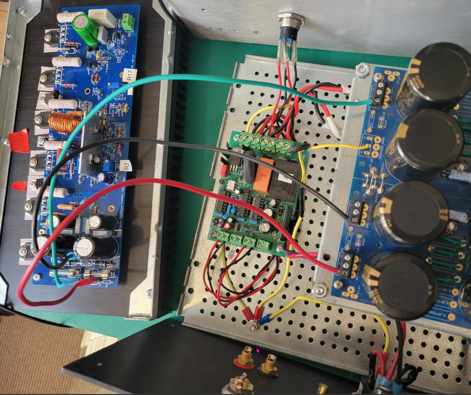

Ok. First things first. Regarding the correct PSU wiring to amp board.
Have I sorted this correctly?
