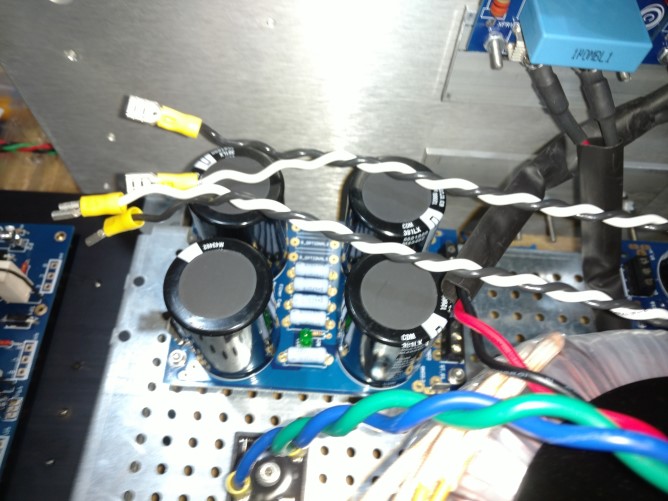

Not knowing this when I built my Badger, I populated R1-5 on the DIYStore PS boards...it's been running for almost a year now, but should I remove these resistors? Could this R in the PS manifest as compressed dynamics at higher volume?
Yep. No CLC or CRC since the current is not constant as with a Class-A. The variable current of an AB amp would cause a variable voltage drop across the R (or L), thus modulating the rail voltage with the audio signal.

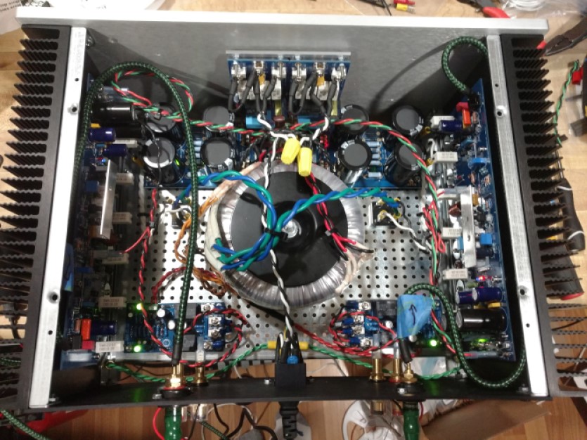

All in all, for my first amp build, it exceeds all expectations! Combing the threads for all part values/substitutions/choices was a chore, but when it didn't blow up (and sounded better than the Parasound it replaced)...worth EVERY minute!!
Thanks OS/diyaudio

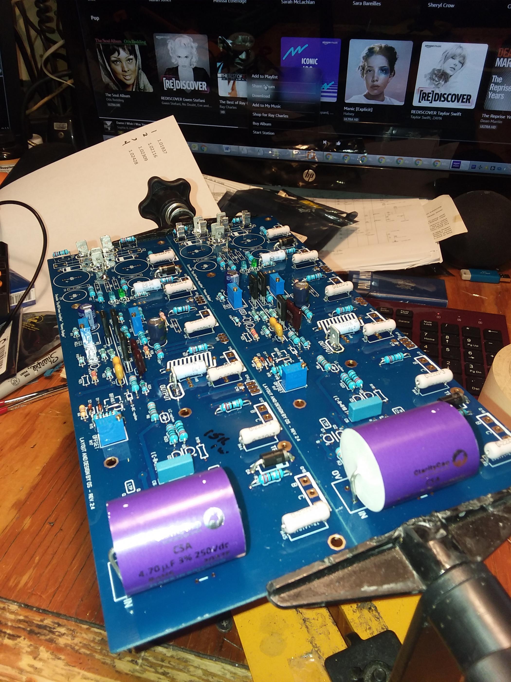

And that's it my boards are complete.
Just need to install the transistors and stand offs on the heatsinks.

Not knowing this when I built my Badger, I populated R1-5 on the DIYStore PS boards...it's been running for almost a year now, but should I remove these resistors? Could this R in the PS manifest as compressed dynamics at higher volume.
CRC power supply is designed to reduce ripple. If you don't need that, go ahead and jump across your resistors. Either way, you are unlikely to hear a difference. The Badger has good PSRR.

Hi All,
I don't want to upset anyone nor do I want miss information passed on as being correct and other members following it who may not know any better at this time.
I do no agree with the statements made in post 4419.
I would not be modifying the CLC or CRC network on the diy power supply for fear of "modulating the rail voltage with the audio signal"
Yes the rail voltage may vary a little as the current through them changes but this will not have an effect of changing quality of the output signal.
Those networks are there to reduce noise and 60hz Hum. So removing them will increase overall THD and THD+N
Yes, my CRC PS as shown in the attachment works very well with HB. I do not remember what resistor values I finally used but that's fine tuning. I have also a complementary RC (100nF + 1ohm) circuit added at the voltage input to each pcb.
i do not see this as untrue...class A amps as in Nelson Pass amps used this arrangement, for class AB i see no point...
for class AB, the idle current can be a few mA to several amperes of current that flows thru those resistors so there will be a hit somehow...
