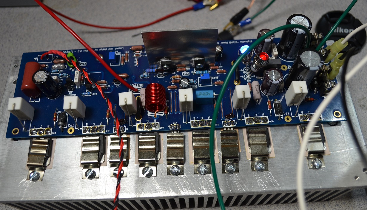

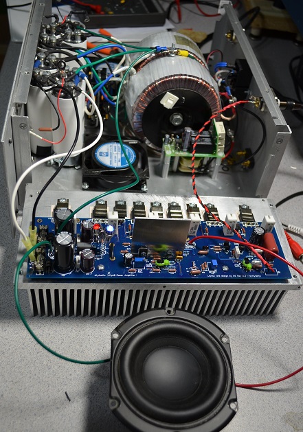

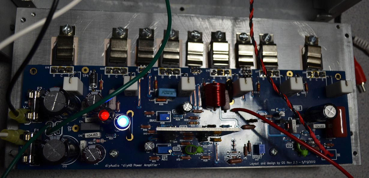

Success!
I can't believe I first posted that I "took the plunge" back on February 22. What can I say? I'm a busy guy. I'm listening to one channel right now, using a power supply taken from another build. So far, it sounds good in mono. The second channel should go much faster!
Thank you, Wembley, for the link. I bought 4 boards. So maybe I'll use the resistors from Analog Metric for the second pair.
I'll post more pictures when it's all done.

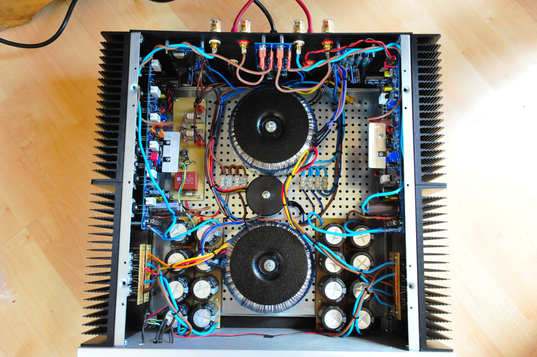

It's done!
Well it’s finally done and here are the pics. I wasn't particularly picky about which brand of components I used and stuck to the prescribed values in the build guide. The only exception is the power supplies where I splashed out a bit on making sure that there was no shortage in that department, using a dedicated toroidal and smoothing capacitor bank for each channel. Basically 2 monoblocks in a single chassis. The outcome is surprisingly good – someone on this thread previously used the term “authority” to describe the amps performance and that’s probably the best way to describe it – it exerts tremendous authority over my speakers. The sound is quite forward with great low end performance and soundstage. If I compare it to my Arcam FMJ (which was a bit underpowered for my speakers) I’d say it sounds the same (i.e. very neutral) but X 2 for the authority and “size” of the sound. A very pleasing outcome and I’m dead happy!
Anyone contemplating the build I suggest go for it - it’s a whole lot of fun but take your time, do it carefully, don’t skimp on the Power Supply side and enjoy!
