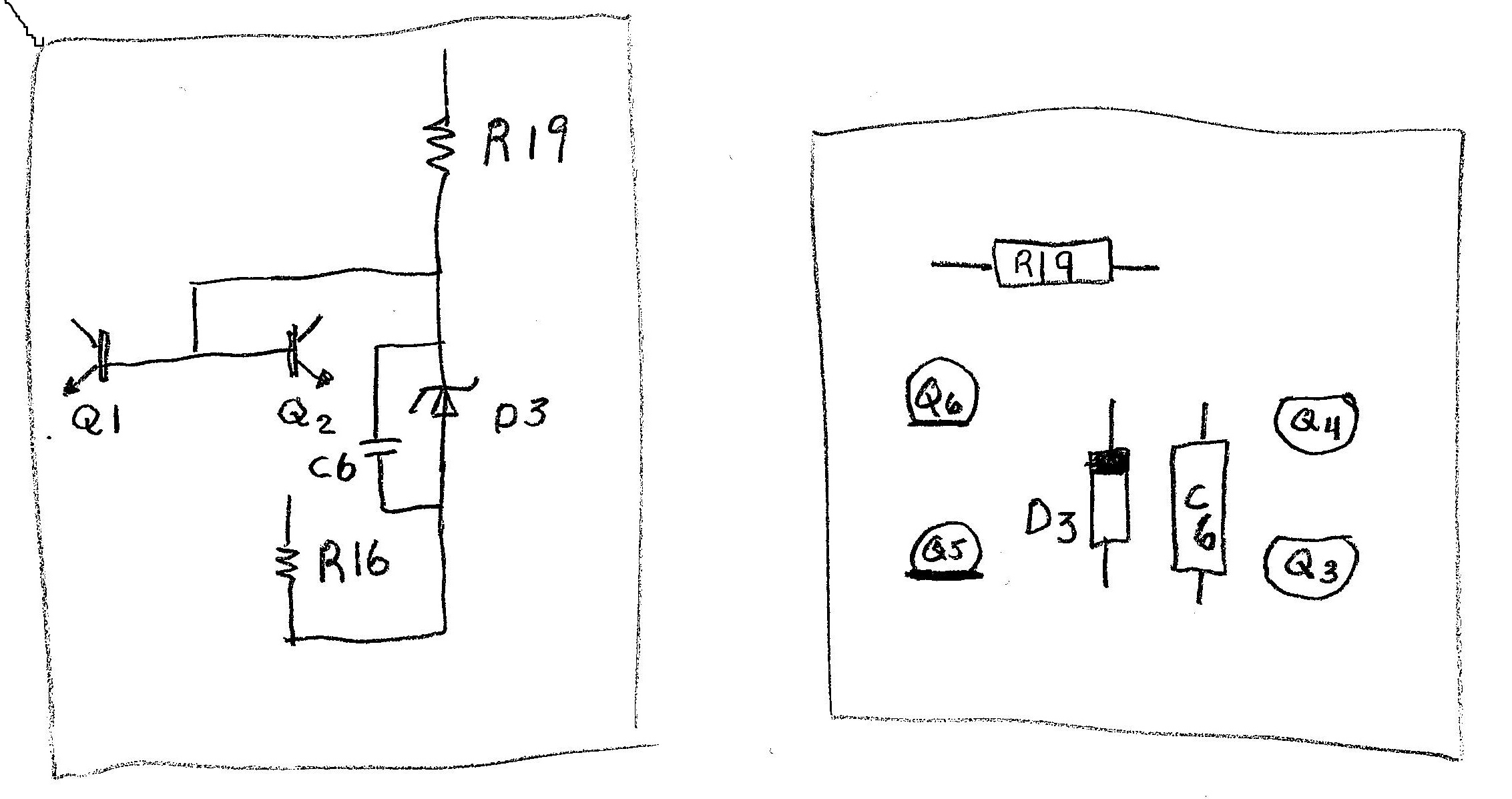

Orientation of D3?
The orientation of D3 is not shown on either the board, or on the schematics. Judging from my limited understanding, I think current is supposed to flow from R19 to D1, D2, R4, etc. In which case the band on my diode goes on the side facing the jumper, and the letters "LTP". I just wanted to check before I soldered this in place.
I'm surprised so one has asked this question yet.

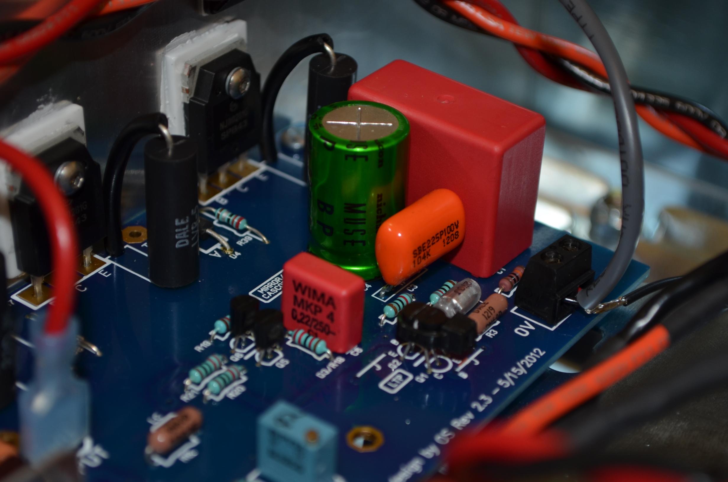

Hello guys,
I am pretty new around here, and this is my first build.
I wanted to share what I have so far and see what you guys think!
Warning: there are a whole lot of really large images!
Honey Badger Amp

Very nice. I got the same chassis. It looks like it's a lot bigger than it needs to be. Maybe I'll have to add another couple of channels to fill all that empty space up!
It looks like you opted for no VAS heatsink. I got aluminum sheet metal from here: 7075 Aluminum Solid Sheet, Annealed, 0.08" Thick, 4" Width, 4" Length, Pack Of 6: Amazon.com: Industrial & Scientific . The stuff available from the hardware store was too thin.
I don't believe this this is your first build.
Yes, its definitely very large in there. I was debating whether or not to try and put the mezmerize in there, or a separate chassis. I feel like putting it in a separate chassis would be better for any potential interference, but there is definitely enough room to fit it.I got the same chassis. It looks like it's a lot bigger than it needs to be.
I did, simply because I could not find anything suitable quickly at a local store. If it becomes an issue I will definitely look harder.It looks like you opted for no VAS heatsink.
Well, its my first amp build, but I am not new to DIY or soldering by any means 🙂
