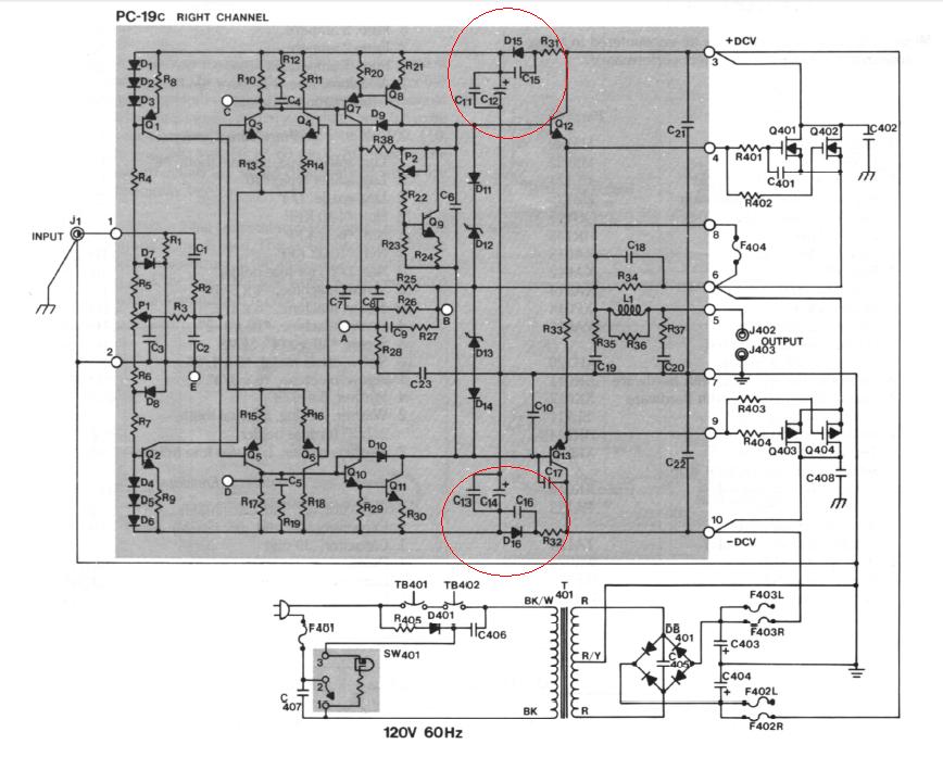

Oh, thanks for the info! 2u2 for C11, C15?
I see that R32, probably need to be changed from resistors to diode drops (or diode series to resistor) to give consistent performance.
So, it would be fairly orthodox to use 100u for C11, C15, but actually needing 2u2 indicates that "something else" is going on, such as the schematic's power decoupling for predrive section, has not fully worked for high speed transients. Power board umbilical cable, chassis layout and transformer voltage could foobar resistors somewhat, so we probably need something more than mild suggestion of current drop--it needs an assured voltage drop with regulators, or with diodes like the Hafler DH-220. The diodes could make C11, C15 work as expected so that the 220u (or 100u) work properly and without hindrance from all of the other power caps in the system.
If your little cap is also the most efficient cap, that option works too.

Your 220u didn't like the 100n guesswork/shotgun bypass at all? That could happen and would be ringing (and arbitrarily non-specific bypass ringing in the power circuit is rather destructive to predrive audio quality). It is possible to replace the 100n with a 0.47u bipolar electrolytic to resolve that problem. Would look crazy and be hard to explain, but tiny bipolar electrolytic just blend easier with big caps, with much less chance of ringing. Try Nichicon ES for the little one.
The two possibilities are:
The simple version of the circuit just wasn't effective enough, Or
A certain model of 220u set up ringing conflict with a certain model of 100n

For getting relatively normal capacitor values to work, here's a couple of possible solutions:Possible my 220uf didn't work well with 100n.
*A fairly orthodox approach, with capacitance value very close to Ostripper's specs, but with a more seamless method of bypassing, is to make C10, C11, C14, C15, all identical models of rather decent 100uF capacitor. This idea makes high efficiency 200uF per rail.
Or,
*If you want to set minimized capacitance value for that area, you could make C10, C11, C14, C15, all identical models of rather decent 47uF capacitor. The resulting value of approximately 100uF per rail is still relatively normal at small signal locale. However, smaller than this might begin to look weird, which could possibly indicate the problem you're looking for may be elsewhere.

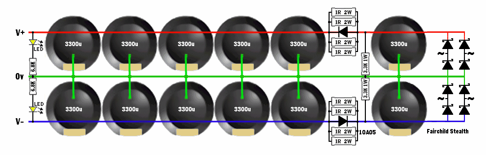

I did post a rather quick reacting power supply design up at post#265. Although faster might be helpful, power supply isn't an ideal location to attempt small signal support; so, it really can't substitute for a more idealistic small signal power circuit like either Hafler's diodes or regulators at amplifier front end. In my opinion, if we were actually looking for the right spot to fix, then we might want to remedy the omissions at Honey Badger's R32, R33, but I don't know if Hafler's diodes or regulators for amplifier front end, are compatible or not.
Hi, just posted a group buy for some 15000uf 30mm capacitors for the universal psu, let me know if you are interested.
I did post a rather quick reacting power supply design up at post#265. Although faster might be helpful, power supply isn't an ideal location to attempt small signal support.
