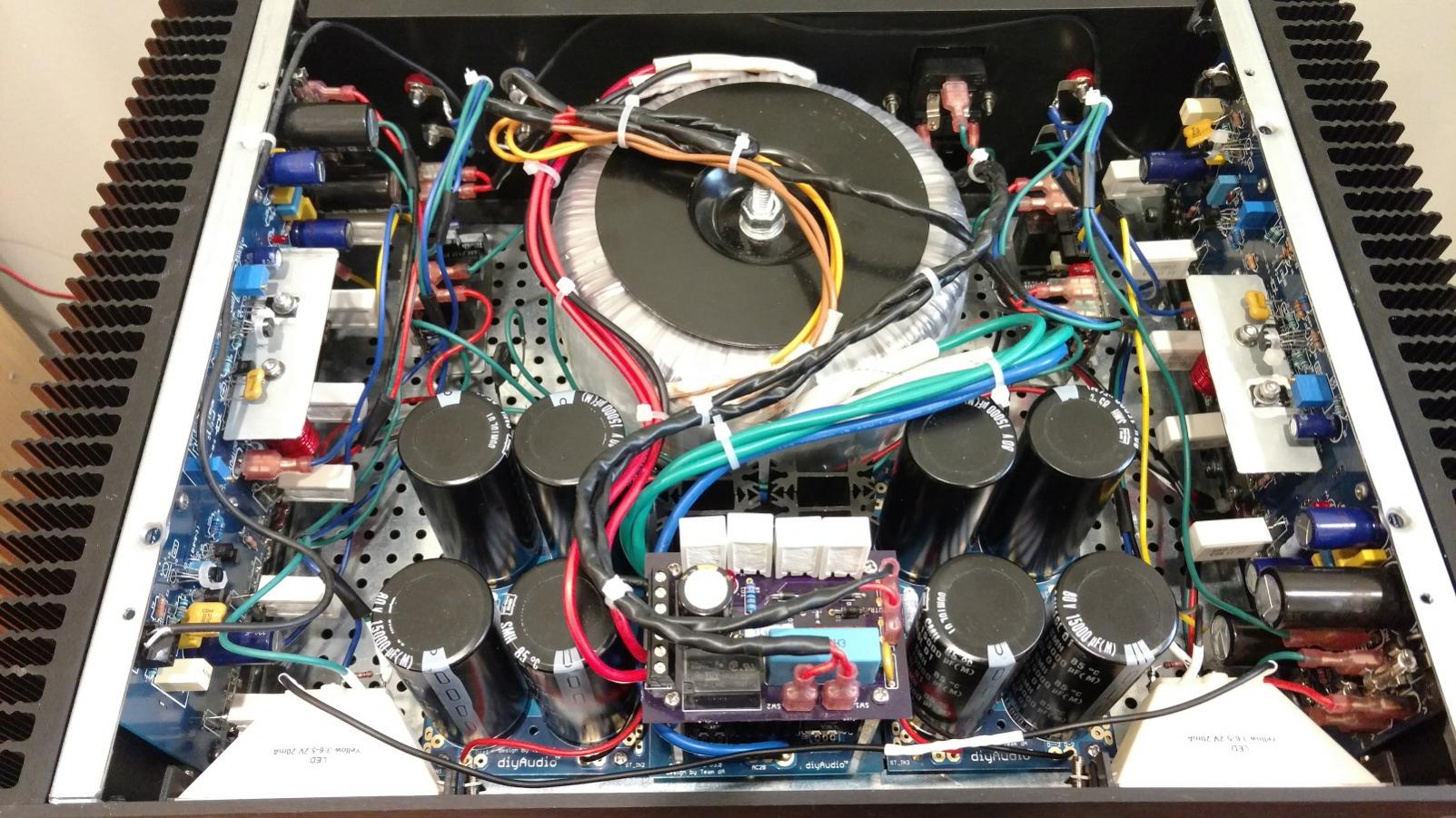

Okey I have done some more testing. And I believe I found the fault.
I followed your instructions and everything works good until i connect cap bank.
I started with only 2 capacitors connected and meanwhile I tried to start it I measured the voltage over the cap. Like before the slow start shut down very quickly. After first try I measured ~5.5VDC so then i continued pushing the start button and the caps gained about 3VDC with each push, until it reached ~26VDC.
When reaching ~26VDC it worked, voltage slowly rised to 60VDC and I got a nice negative volt reading on the other cap(just as it was supposed to be) 🙂
So, probably the wiring was right all along but the slow start can't handle the inrush current? Even with only 2 caps with is 20kuF each. I know this still is quite a lot of capacitance but shouldn't a slow start designed for amplifiers be able to handle 40kuF at 60V?
I did some research about the slow start wich I picked up from ebay and I found out that it has 4 NTC resistors but 2 of them is wired in parallel.
Link to diyAudio thread and post showing schematic of NTC setup
I understand it probably was a bad choice of slow start/trying to save a few bucks. Do you guys think its possible to mod the NTC setup to handle my cap bank? In the forum thread mentioned above it says that the NTCs are the type: "10D-11". From what i found online one of these can only handle 3A max.
I got some CL-60 at home , rated for 5A, could the be a better replacement maybe?

Protection and control circuits are something you shouldn't go cheap on in an amplifier, much like brakes and seat belts in your car. These systems protect you and your speakers. That softstart design is terrible, NTCs cannot be used in parallel. The power relay and bypass relay in series is also not ideal, they should be in parallel to minimize unneeded connections in the main power circuit.

Yeah you're right, it was a bad choice. But isn't it a bit strange that it's not working at all with only two of my capacitors? I checked my NTCs and they are the type: "20D-20", not "10D-11" as I thought before.
I understand why the parallel setup of the NTCs is bad but at least the two 20D-20 NTCs in series should be "active" during start sequence? Would it work better if I modded it so all the NTCs was in series instead?
I would really like to understand why my modules are not working, mostly for the sake of learning 🙂

A single good quality 5 amp NTC per transformer should work fine for you. 40R would be good for 240VAC mains. Your supplies should be charged in 4 or 5 seconds.

I did some mods on the soft start. I rewired the NTC so be in series and doubled the capacitance on the rc network to the 555-timer circuit, so NTC relay delay became 2 seconds instead of 1.
It did not help at all. I just shuts down as soon as i turn it on with capacitors connected. I guess i have to find a new solution...

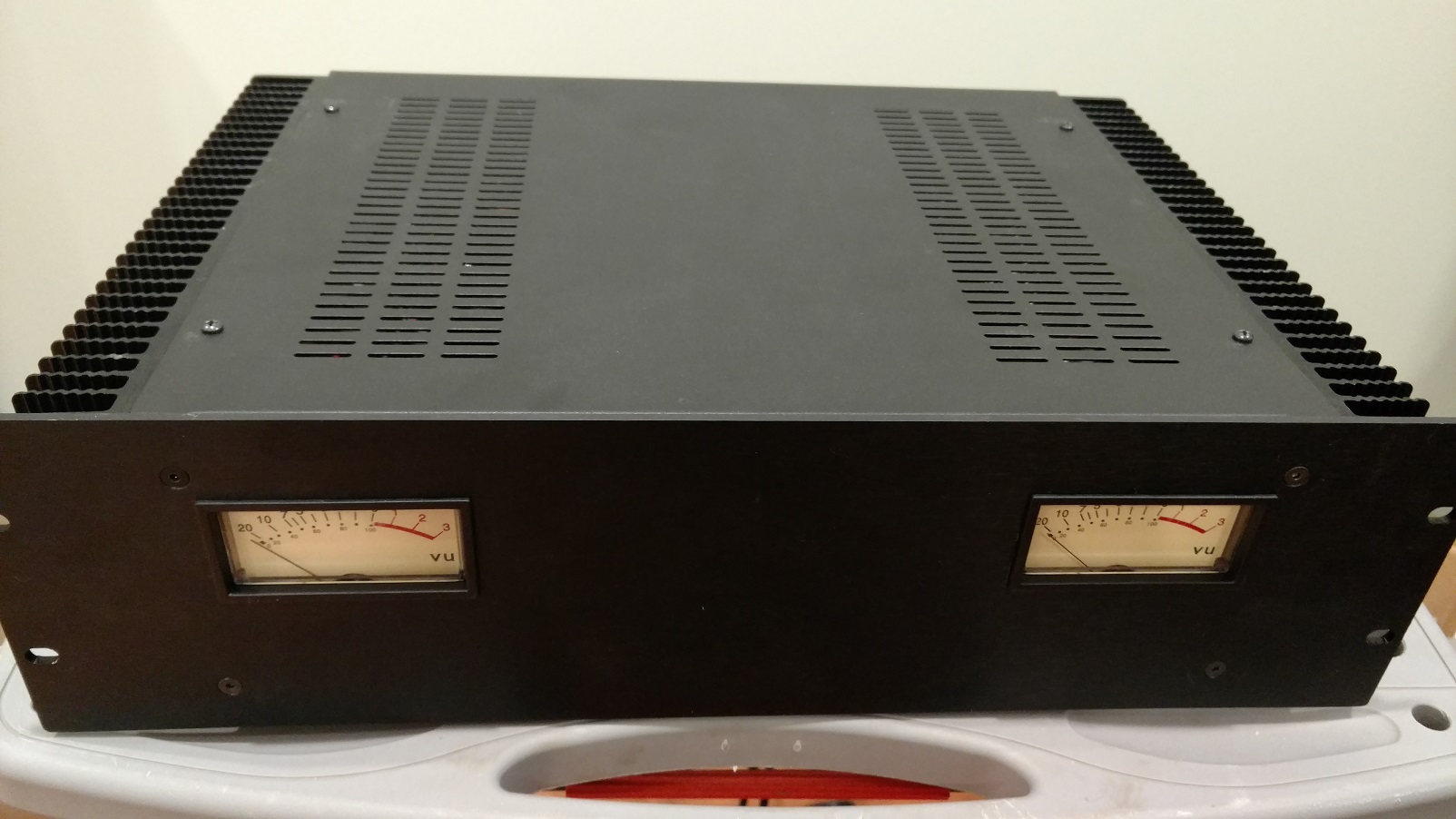

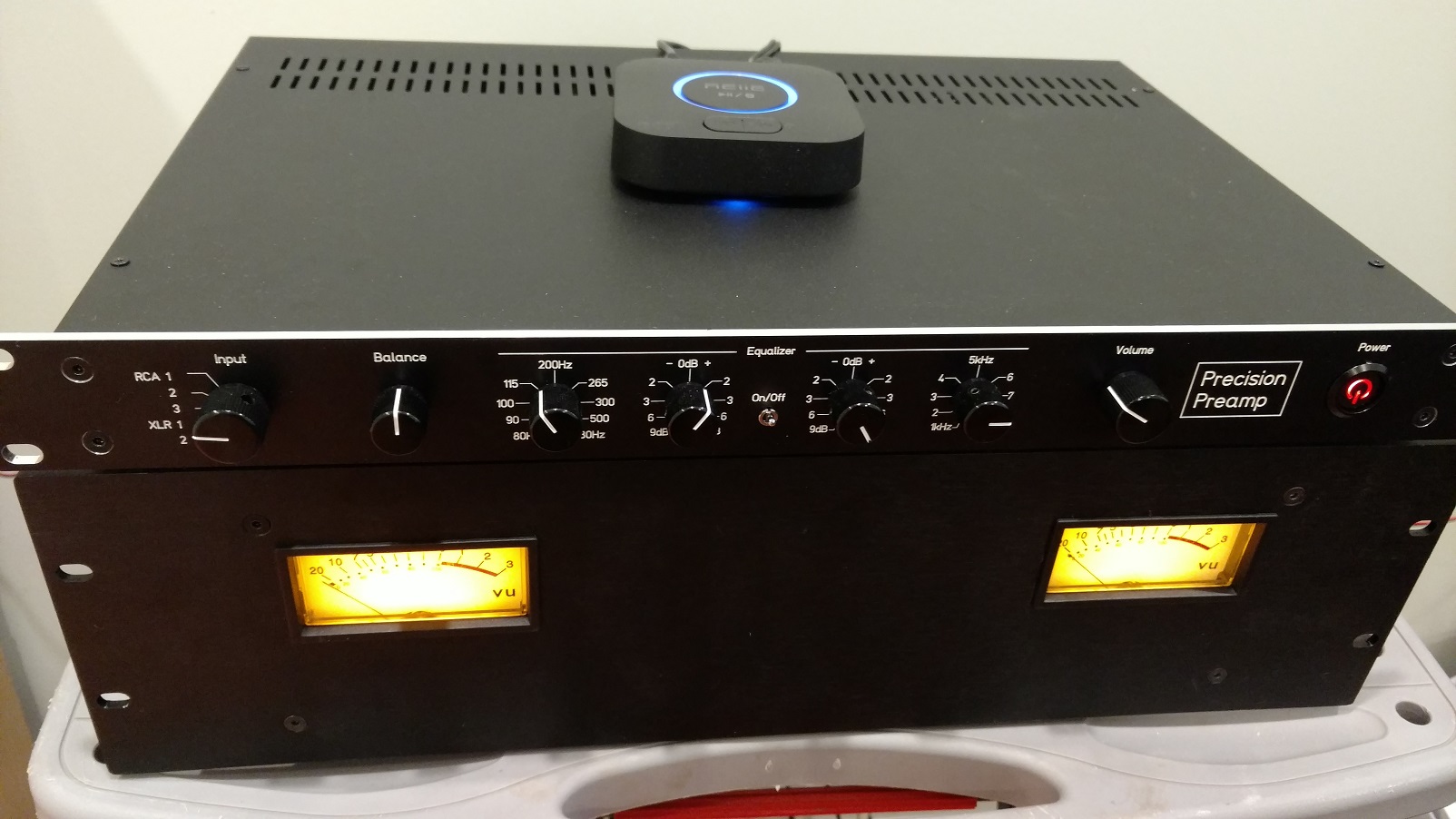

These past 3 months have been a blast! I have had a lot of fun building Honey Badger and Doug Self Preamp. I have learned a lot and keep learning. Working on this project has also been a way for me to re-live my school years. The last picture is of the 4 Watt stereo amplifier I built in my 11th grade. 🙂
Thank you everyone who have been answering my (sometime stupid) questions. I couldn't have done it without you! Thank you to DiyAudio staff and moderators for maintaining the forums and the store.
I hope to be able to start contributing back some day, maybe when I am done with all of the 1192 pages of The Art of Electronics by Horowitz Hill? 🙂
