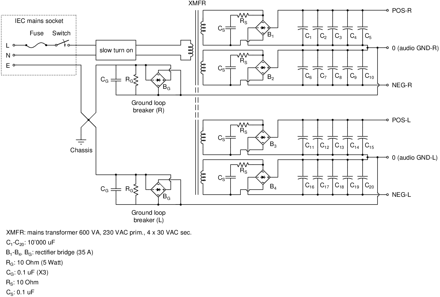

Since this is my first amp build have some questions about designing and picking out caps for the power supply which will be complete dual mono with dual soft starts, 400VA( 45VAC secondaries )...
1: Is there any harm in going with bigger capacitance than the recommended in build guide? (I could probably fit caps up towards 100kuF per channel in the chassi)
2: What kind of ESR on the caps should i be aiming at? I have found these *Link to mouser*KEMET Caps*Link to mouser* that has 22mOhm ESR. Would they be suitable for a HB power supply?
3: After reading about different grounding techniques I'm thinking that the channels should have separate star grounds with a ground loop breaker for each of them(and power inlet ground straight to chassi). Is that good thinking or could someone give some some advice of how it could be done?
Yes, that's the way to go. I attached a schematic of how I built the power supplies of my Honey Badgers.
If you're using loudspeaker protection units at the amp output, make sure to keep the GND separated between the two channels. Some protection units have a common GND for both channels. Even if using two separate protection units (one per channel), be careful not to connect the two GNDs via the helper power supply of the two protection units.

Thanks for your answer! I will be using dual speaker protection boards so i'll be sure to keep GNDs separate 🙂 I see you didn't use any pi-resistors/CRC configurations, i cant say I understand the use or can calculate the proper values for them(i just bought a bunch of 0.47Ohms 3W incase i should use them since this seems to be a regular value). Would i be missing out of something if I didn't use them?
CRC (or CLC) configurations are good as ripple filters in situations where a constant current is drawn from the power supply. This is the case with most class-A amps, but not with the HoneyBadger (class-AB). I wouldn't use a CRC (or CLC ) with the HoneyBadger.
... you end up with HF noise from diode switching ... You're going to have to use larger rectifier diodes as well since your hot switching current will be much higher.
Snubbers will remove those switching/ringing issues (see the schematic in my pevious post).
