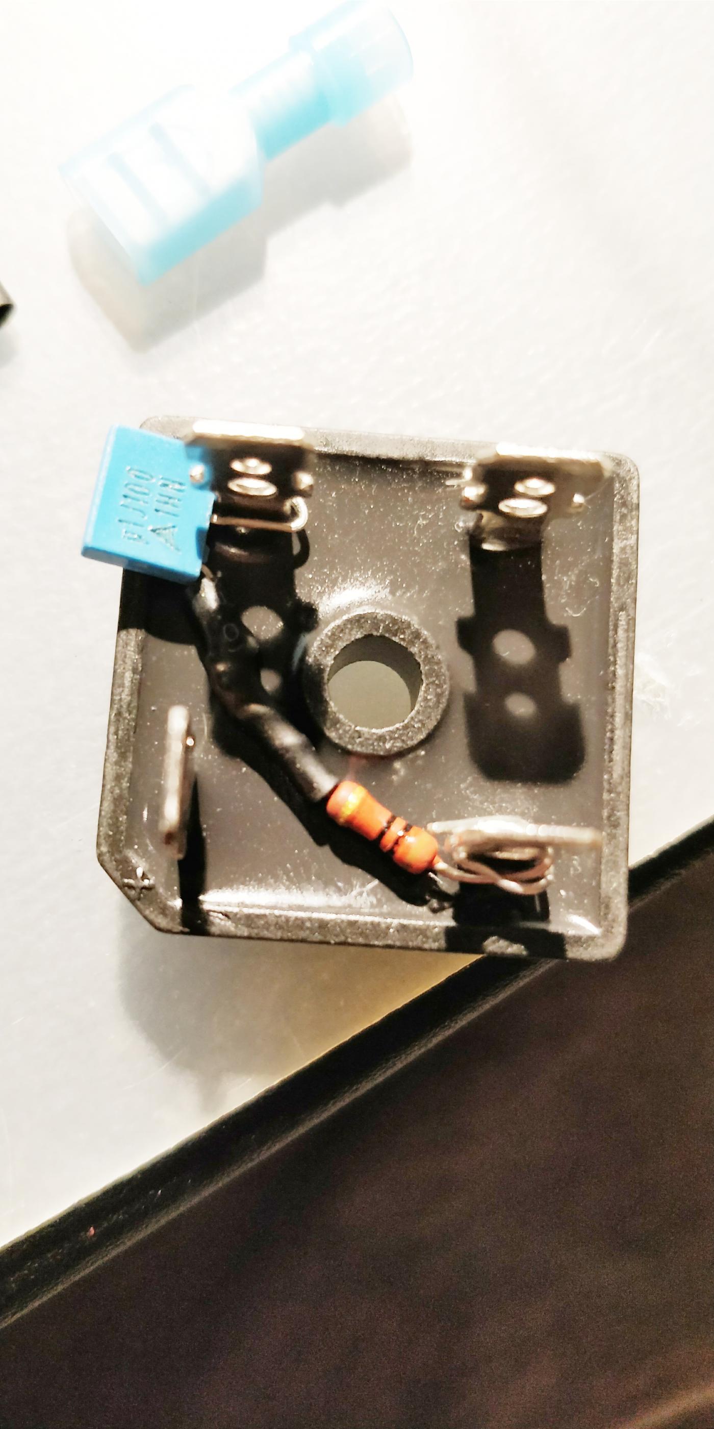

On my bridge rectifiers I have soldered on a snubbers. Could these be what causing the low voltage? The snubber is a 10Ohm 1W resistor with a 100nF 100V capacitor LINK TO CAPACITOR ON MOUSER
These are connected on the AC-side of the bridge rectifier as shown on the attached picture.

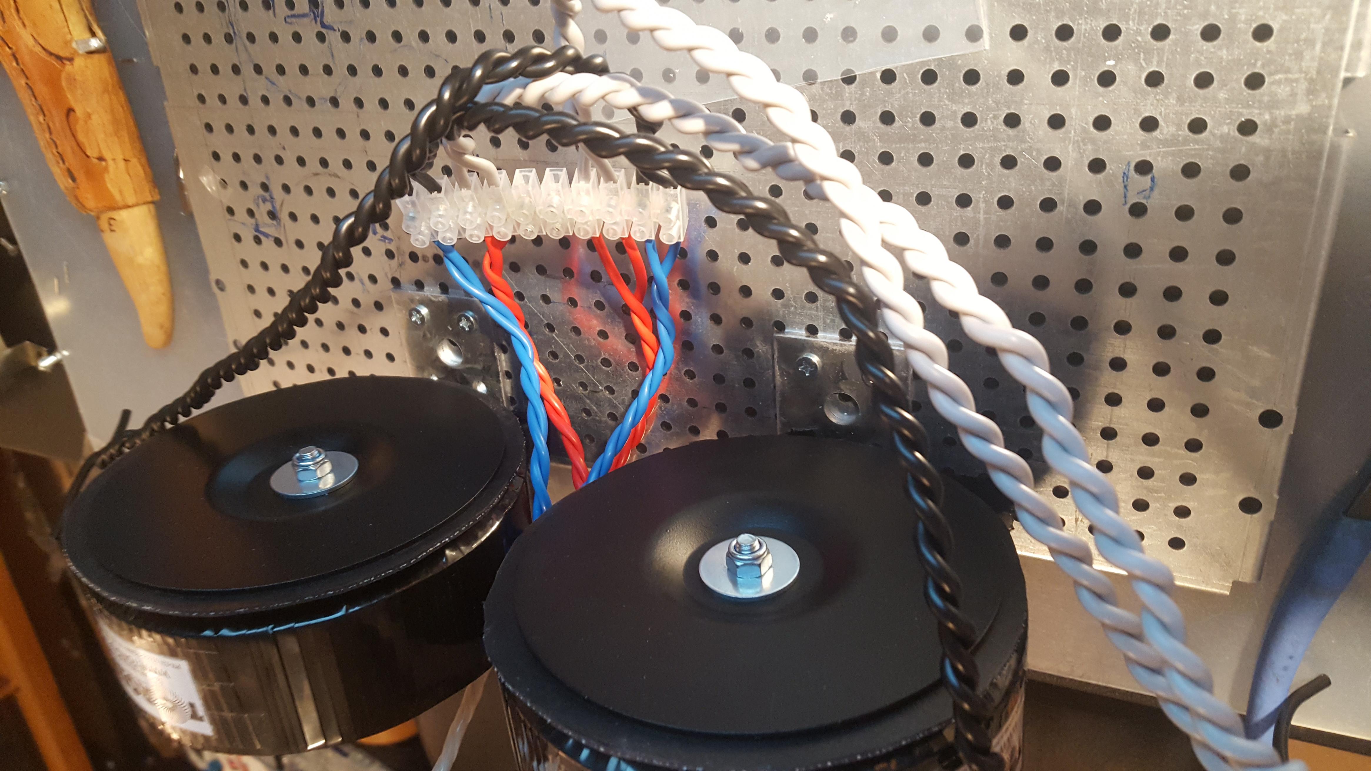

Can you post a schematic of how you've got everything connected? A couple good pictures of your supply connections would help too. It sounds like you have something connected wrong, but we're guessing without having any info to go on.
Yes, the build is kind of a tight fit so not every cable is visible.

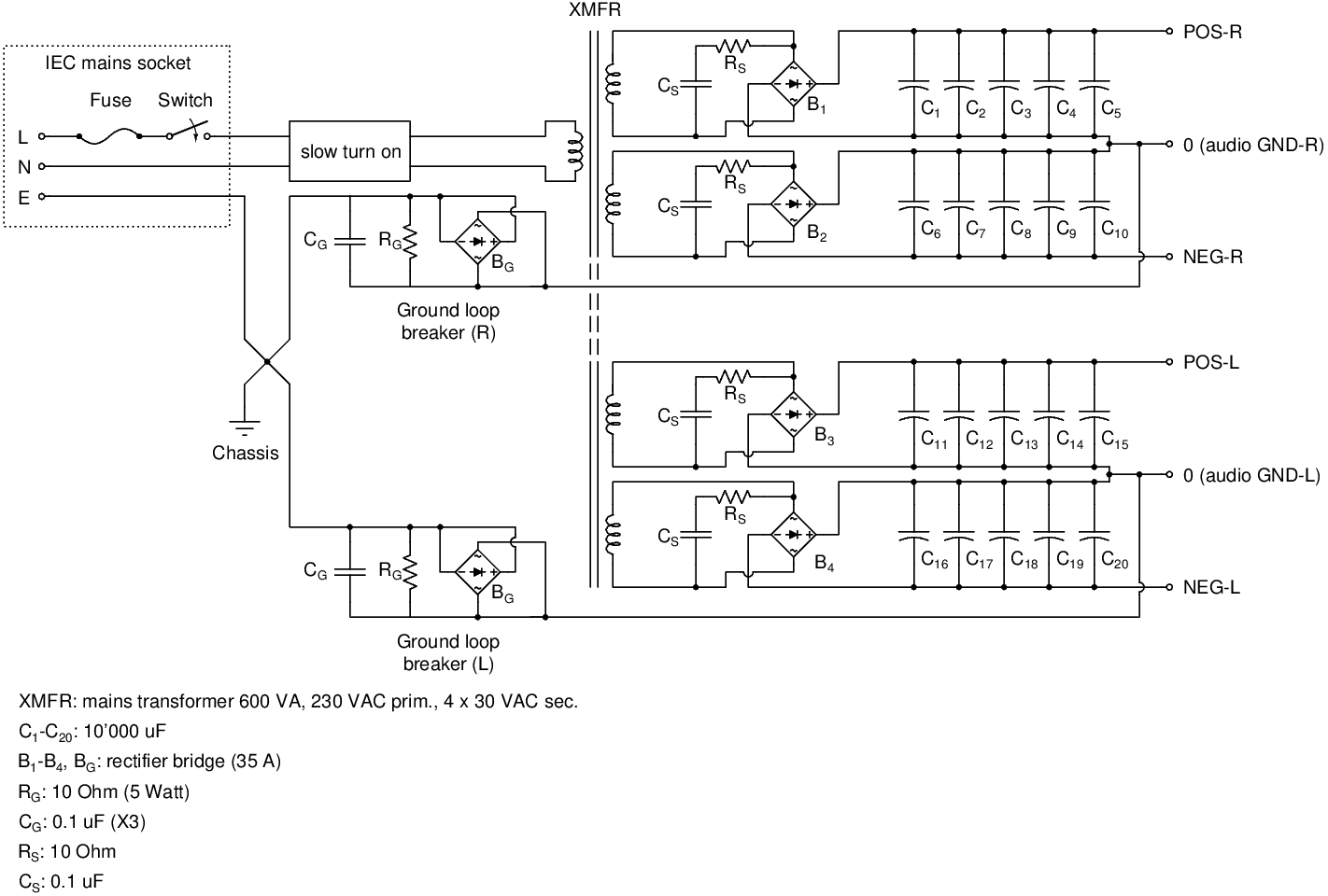

First attached is picture of the PSU wiring I'm trying to follow that mbrennwa posten in POST POST #2905 with the difference that mine is with 45VAC secondaries.

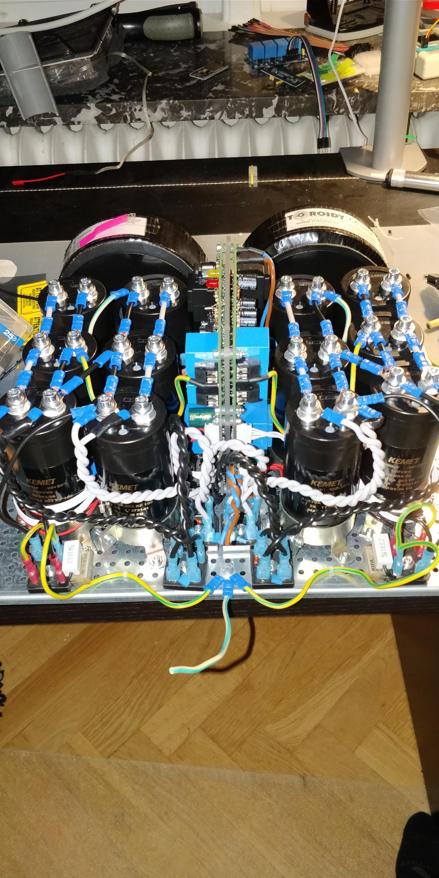

The second picture is shows some of the wiring. The pictures where taken before testing and before i started i removed the green/yellow PE wire that comes from tranformer and connected it to chassi instead. I also lifted the green/yellow PE wire from the speaker protection while trying to find the fault. Here you also can see the black wire from PSU-0V going to the ground loop breaker.
Ground loop breaker is a 35A bridge rectifier with 10Ohm 5W resistor in parallel with 100nF x2 capacitor.

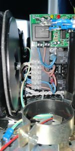

On the third picture i have removed to capacitors to be able to show the connection to the slow start. The brown and blue cable on the bottom is the L+N in to the slow start. The brown and blue above is L+N out to transformer(white wires) and speaker protection boards that sits above.

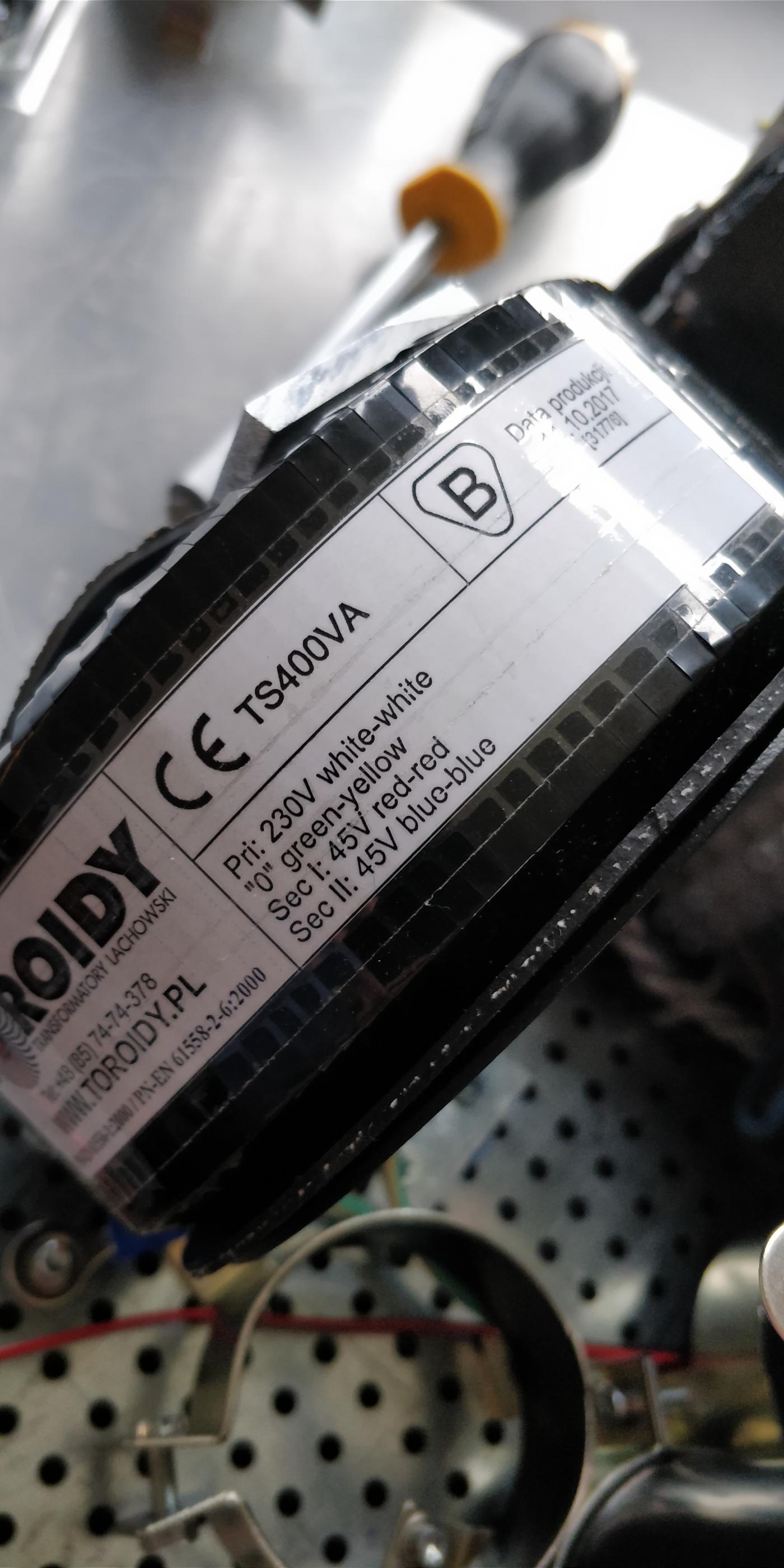

Fourth picture is the transformer info.

Btw, your pictures show that you have connected the electrolytics to the rectifiers by a pair of twisted wires of the same colour. In order to avoid confusion, don't do that! I suspect that your electrolytics are polarized the wrong way.
