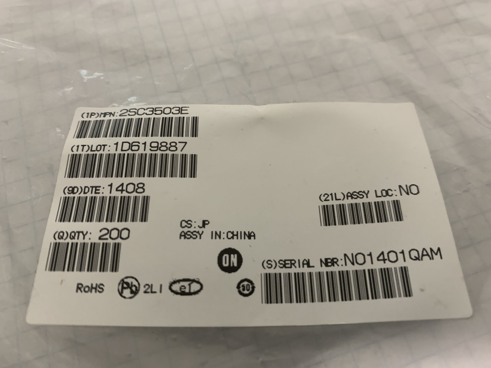

The shipping bag .I have Sanyo datasheets for those devices, do not believe Toshiba made them, also notice the exposed pad where as the ksa,ksc versions have a thicker bodies and are isolated
^ I'm assuming you're posting this b/c of your post #1957 => your link to sell parts. If not, please ignore.
Pics of your parts being offered along with a data sheet matching the form factor and parts markings would be very helpful along with provenance.
No disrespect meant, but in the days of so easily re-etching / screen printing parts markings themselves... a printed parts bag label as evidence of parts authenticity does not pass muster (for me).
Documented provenance from origin and/or spec sheets and measurements are what counts (to me).

I agree with your concern. Just wanted to show the Onsemi logo printed on the bag. These are Not toshiba or Sanyo.^ I'm assuming you're posting this b/c of your post #1957 => your link to sell parts. If not, please ignore.
