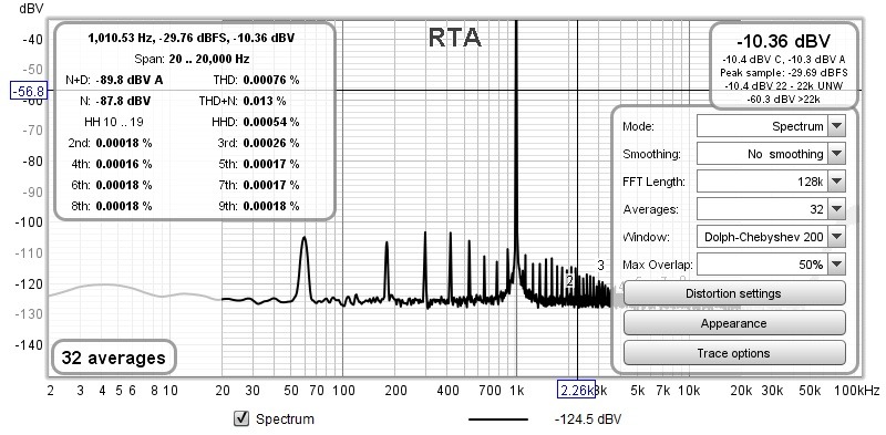

0.000042 % THD + N at 1 kHz
Those are impressive measurements. Thank you.
Heyenc, this is the final step of the design process, what we designed for and it is confirmation, finally, that we, collectively, did it.See post 2006. Build thread is where these should be.
More importantly this is what the current design, BOM and build guide can deliver when any DIYer builds it.
(but yes, I am sure it will end up in the Build thread too)

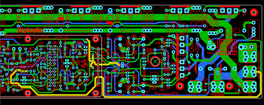

Hello everybody. Looking at the Osstriper PCB, why are the resistor and the suspended capacitor referenced in the GND of the speaker and not in the star G2? Thank you for your patience and care.
Please provide a clearer question. Maybe a photo, sketch or post number.Hello everybody. Looking at the Osstriper PCB, why are the resistor and the suspended capacitor referenced in the GND of the speaker and not in the star G2? Thank you for your patience and care.
So we can try and help you.
RLft, diodes D1 e D2 e CLft, could it not be referenced in the G2 star?Please provide a clearer question. Maybe a photo, sketch or post number.
Hi CLPK, we did this to separate the Signal Ground from the many and higher currents flowing in the Power Ground. The placement of those traces also avoids nearby noise sources. There are other areas where separate tracks are used, in the feedback path for example, in order to achieve the extremely low noise and distortion floor of the overall design.
I understand, is that why the negative feedback is also in parallel with the GND speaker?Hi CLPK, we did this to separate the Signal Ground from the many and higher currents flowing in the Power Ground. The placement of those traces also avoids nearby noise sources. There are other areas where separate tracks are used, in the feedback path for example, in order to achieve the extremely low noise and distortion floor of the overall design.
