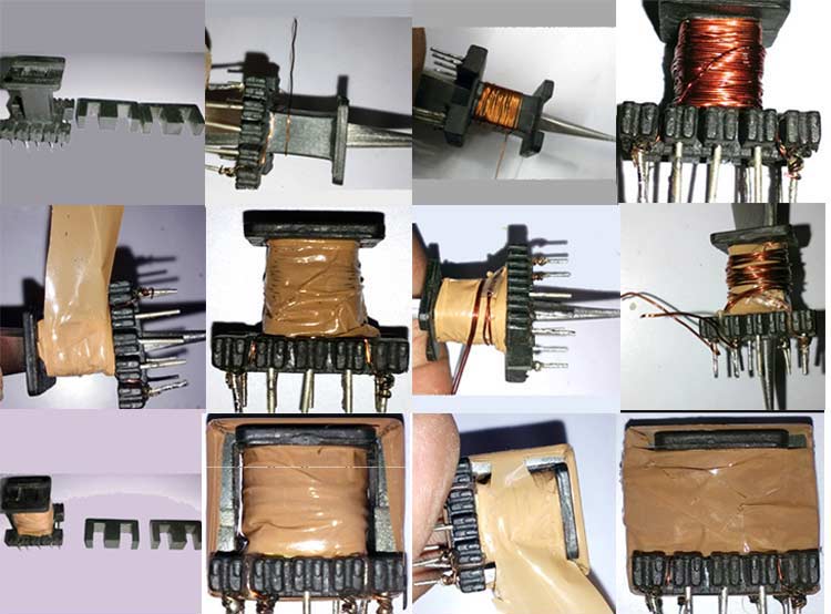

We could wind our own trafo ...
Wind our own common mode chokes .... much fun.
In other words , we could make a "cooler" unit that would seamlessly integrate with protection , allow a arduino to read V/I ,
and is VERY safe and quiet.

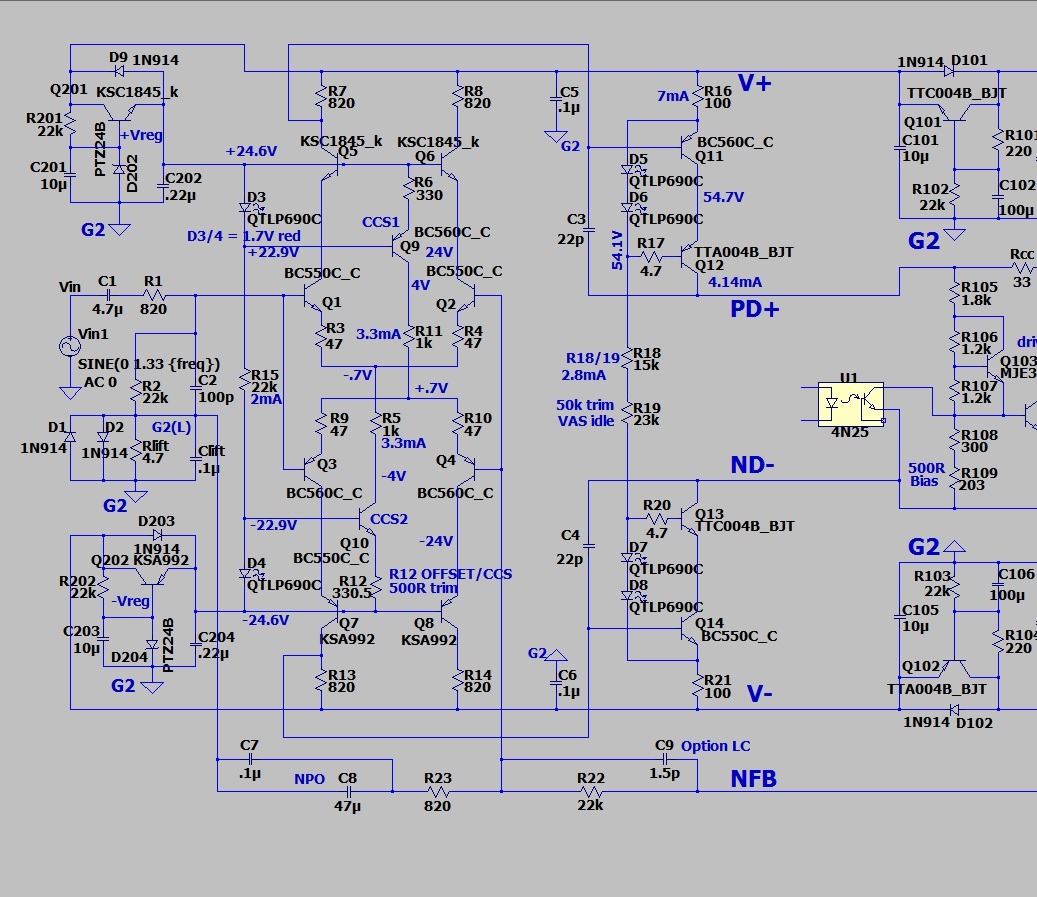

Yup , still have the spooky. Good thing I have such a reliable PC ... helium hitachi 4TB hdd.
All the Wolverine stuff is in "slewmaster" LTspice and the sprint layout program are still installed . 2 years later !
I actually built the spook , i am sure it is as flawless as the Wolverine.

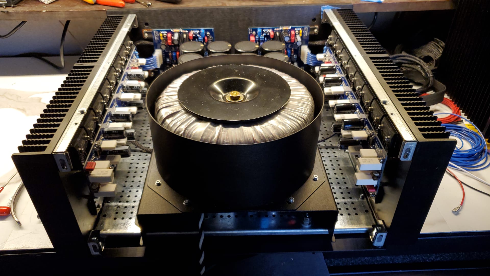

Speaking of the Spook... I worked with Neilshop to develop this insanity. It's based on the Spook/Leach but with some modifications. This is the 8 pair per channel. I originally designed using 6 pair but there was space left on the 400mm heatsinks so I had to expand it to 8 pair. The IPS and Driver are mounted on the 10mm thick front panel.
Jeremy
Jeremy
That is awesome 😁😁😁
