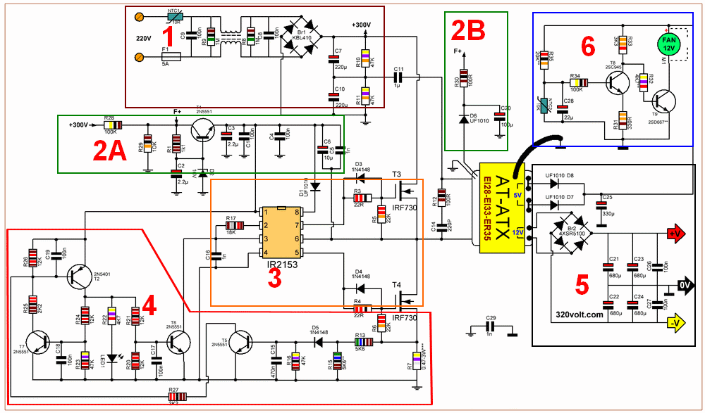

Here is how simple we could go , about 30$ group buy arena ...
https://320volt.com/en/audio-amplifier-smps-circuit-ir2153/
Even as the IR2153 is a sound established controller , I would want pfc ,
10A bridge , bigger caps ... etc.
It can be done.
It can be done.

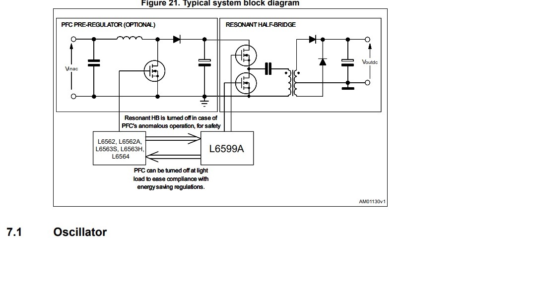

“Among many resonant converters, the half-bridge LLC-type resonant converter has been the most popular topology for many applications since this topology has many advantages over other topologies; it can regulate the output over wide line and load variations with a relatively small variation of switching frequency, it can achieve zero voltage switching (ZVS) over the entire operating range, and all essential parasitic elements, including junction capacitances of all semi-conductor devices and the leakage inductance of the transformer, are utilized to achieve soft-switching.”
This was a statement that hit home.
PFC becomes much less an issue here, So .. ( series-resonant half bridge topology) it is.
Cool ! DIP-16 no smd.... So L6599 https://www.st.com/resource/en/datasheet/l6599a.pdf
And why not also add PFC because ST makes a resonant pfc controller that communicates with the dc/dc convertor.
https://www.st.com/resource/en/datasheet/l6564h.pdf
The 6564 can shut down the 6599 for brownouts / over-under V . And the 6599 can "communicate" the output load
to the 6564. Turn PFC off for low or no load , and scale to any high loads. quite a PAIR !

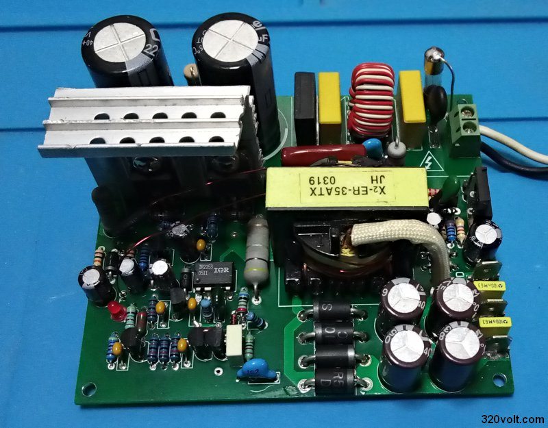

But Thimios , That IR2153 is primitive ! Do I have to design 2 units ? (primitive and advanced).
My 5V led supplies use the 2153's ... not bad after I replace the Chinese caps and fix the heatsinking.
They DO get noisy as they reach rated amps.
With active PFC , they would be acceptable. But if we implement PFC (with added complexity) .. why not go all the
way with the more advanced controller/PFC combo. 6599/6564 combo would be better than most 200$+ offerings.
If we went "anal" with layout and sourcing (premium components) we could have a Wolverine "match".
"Halcro level SMPS" !!
