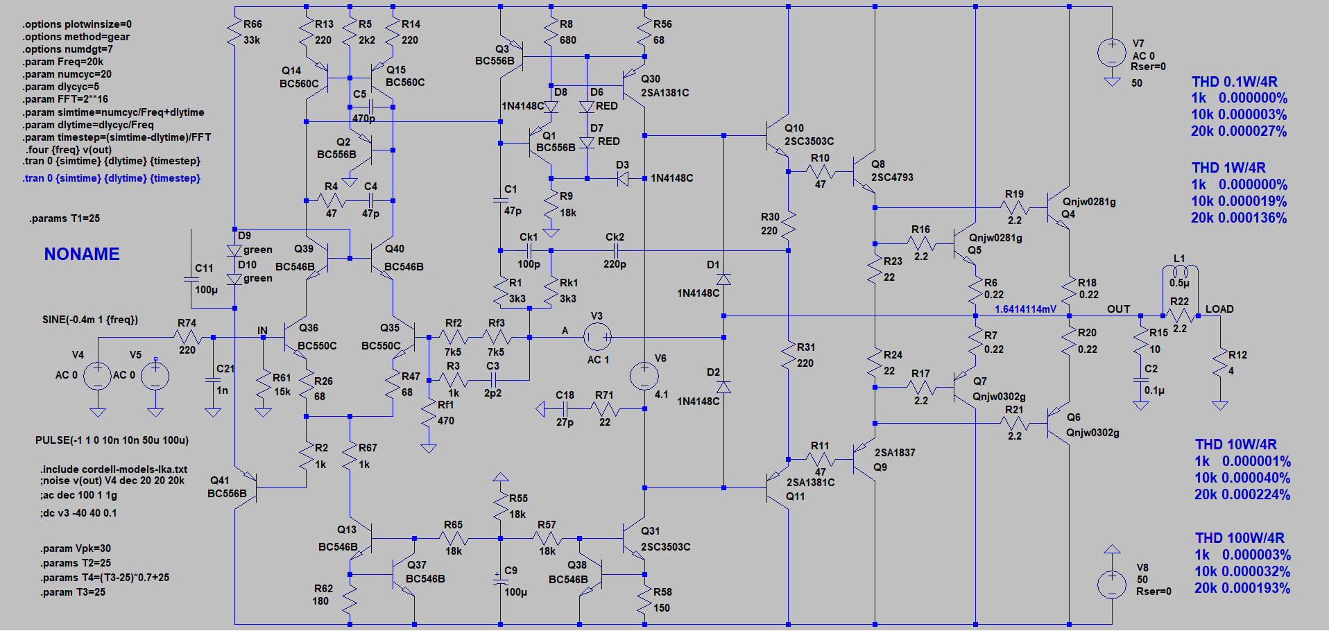

Do you know if there is already an implementation of a balanced input precision op-amp buffer IPS? Otherwise it would really be great to enable the Wolverine to accept balanced input 😎You mean like the spooky (different IPS) or a balanced input precision op-amp buffer ?? Some of the AD OPA-xxx's are PPM enough for
the balanced buffer. An accessory for the amp ? This would also need a precision regulated supply. Feedback "super Jung" territory.

Is there any interest in another design ? I will use Stuart's IPS standard but ALSO design a single pair power device stereo OPS board.

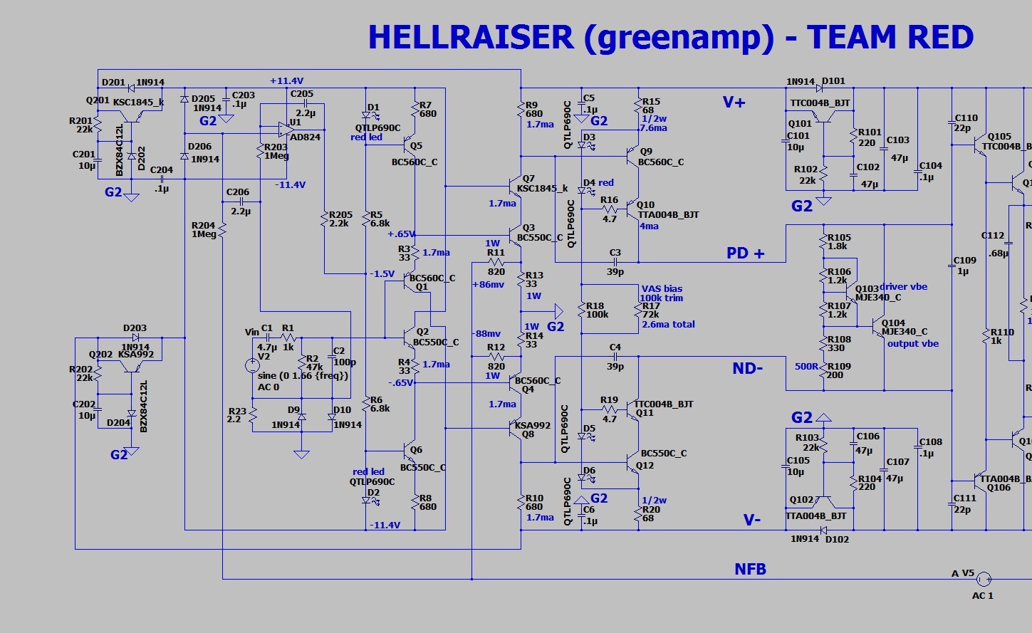

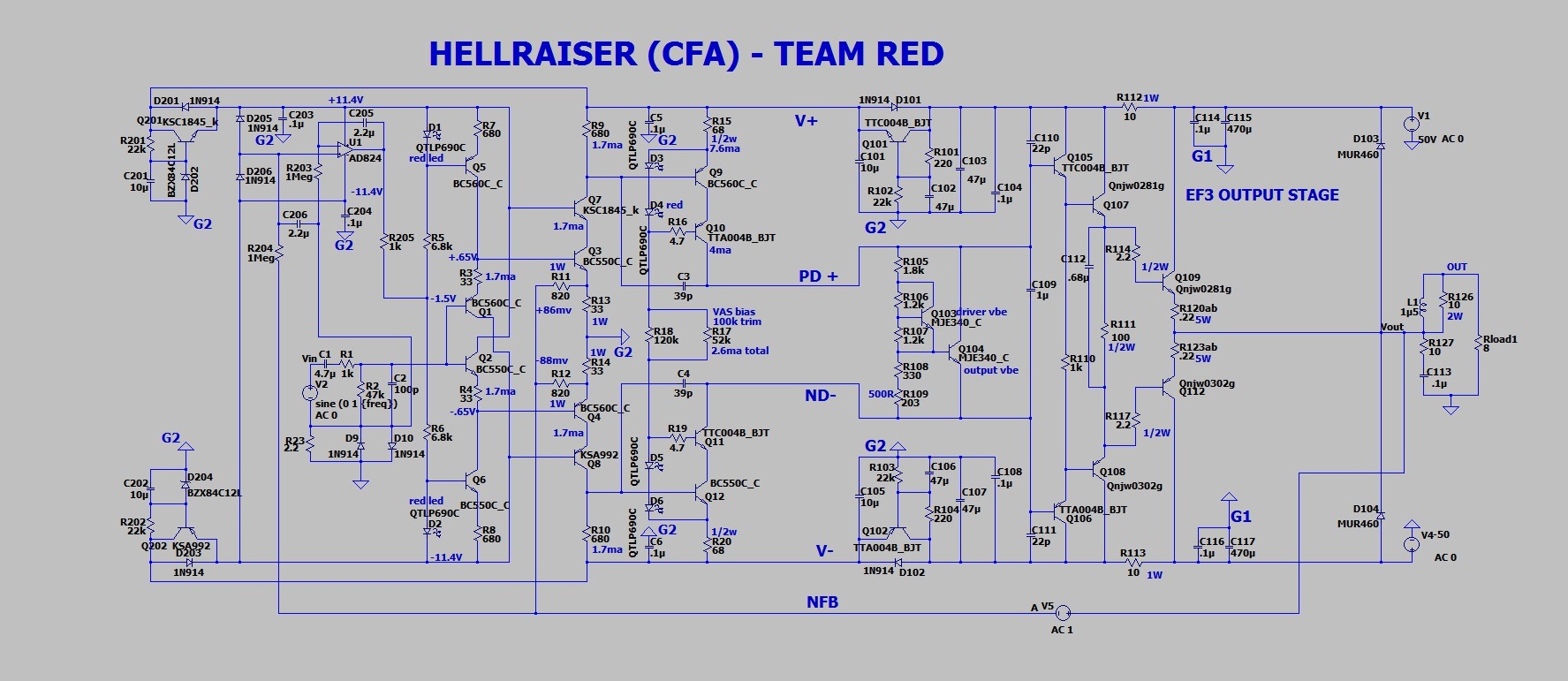

The advantages of the hellraiser.
-PSRR is quite superior. -120db easy. Single supply will match a monoblock wolverine.
-NO caps (just input cap) in audio (or DC) FB . servo can make for uV offset - LED CCS's are controlled by servo.
-300V/us slew - I don't know whether this would be audible , but - what the hell ... FAST !!
-A small 300W SMPS would make for a quite small and accurate 60w/ch amp with plenty of headroom (100w+ peak).
-this design seems to have the same 8-10ppm regardless of freq./ load - could this be the current FB ?
-not as many silver mica caps.

-warm 1W feedback resistors , you will waste a whole watt .. ha ha !
Seems a quite ideal endeavor as far as a design. Even if there is no interest - I shall have it.
below I have a FINAL schema to layout what ( I ) want. Off to the Sprint layout.

- It MIGHT approach Wolverine THD - plugged into "fireanimal's" 4 pair Sanken EF3.
- Typically , complimentary ips's cancel even order harmonics. But , the odd's are so low it don't matter.

This design is unique in that its input stage can supply more than twice the bias current when slewing. The problem is that works only in one direction. The two integrators will have a tug-of-war when slewing (that will never happen on music).ostripper said:300V/us slew - I don't know whether this would be audible , but - what the hell ... FAST !!
Ed

The Hellraiser and Spooky behave similar , have the same LED cascode. CFA = 250v++/uS Spooky = 120+
Both at 1-2ppm 20Khz/8R.
All these IPS's will run from dual 35-80V supplies. 70+ might need a few component tweaks (larger R on zener supplies , close attention to
Vce for devices).
