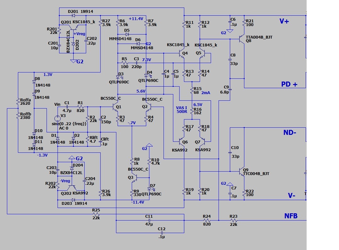

Very nice. You can safely loose the ripple eaters between the VAS and output stage. You could also simplify it by removing the DC servo chip and extra capacitor and still get comparable performance but let AB listening tests decideIs there any interest in another design ? I will use Stuart's IPS standard but ALSO design a single pair power device stereo OPS board.
The advantages of the hellraiser.
-PSRR is quite superior. -120db easy. Single supply will match a monoblock wolverine.
-NO caps (just input cap) in audio (or DC) FB . servo can make for uV offset - LED CCS's are controlled by servo.
-300V/us slew - I don't know whether this would be audible , but - what the hell ... FAST !!
-A small 300W SMPS would make for a quite small and accurate 60w/ch amp with plenty of headroom (100w+ peak).
-this design seems to have the same 8-10ppm regardless of freq./ load - could this be the current FB ?
-not as many silver mica caps.

Seems a quite ideal endeavor as far as a design. Even if there is no interest - I shall have it.
below I have a FINAL schema to layout what ( I ) want. Off to the Sprint layout.

Don't like servo's , neither do I. But this one just shifts the Vf's of the red LED CCS's , setting the diamond pair. No signal (corruption) involved.
I suppose I could just make one of the CCS's adjustable , as I do on my new spooky. Or , I could emulate that 1V CCS LED offset with
diodes strings and a pot (Wolverine tech).
I DO like always having uV offset at any frequency without having an evil servo tainting my audio path. It just seemed convenient , as I
already have the 12V supplies available. The cap multipliers are already on the Wolverine boards by default. If (WHEN) I make a 60W X2
board , I still might include them as 2 channels will run from a unified supply.
Hellraiser/Spooky are complimentary designs , natively they ARE ripple eaters enhanced by NFB , channel separation should be stellar.
On the 2 channel board .... even a very conservative multiplier (47u) won't take up much real estate.

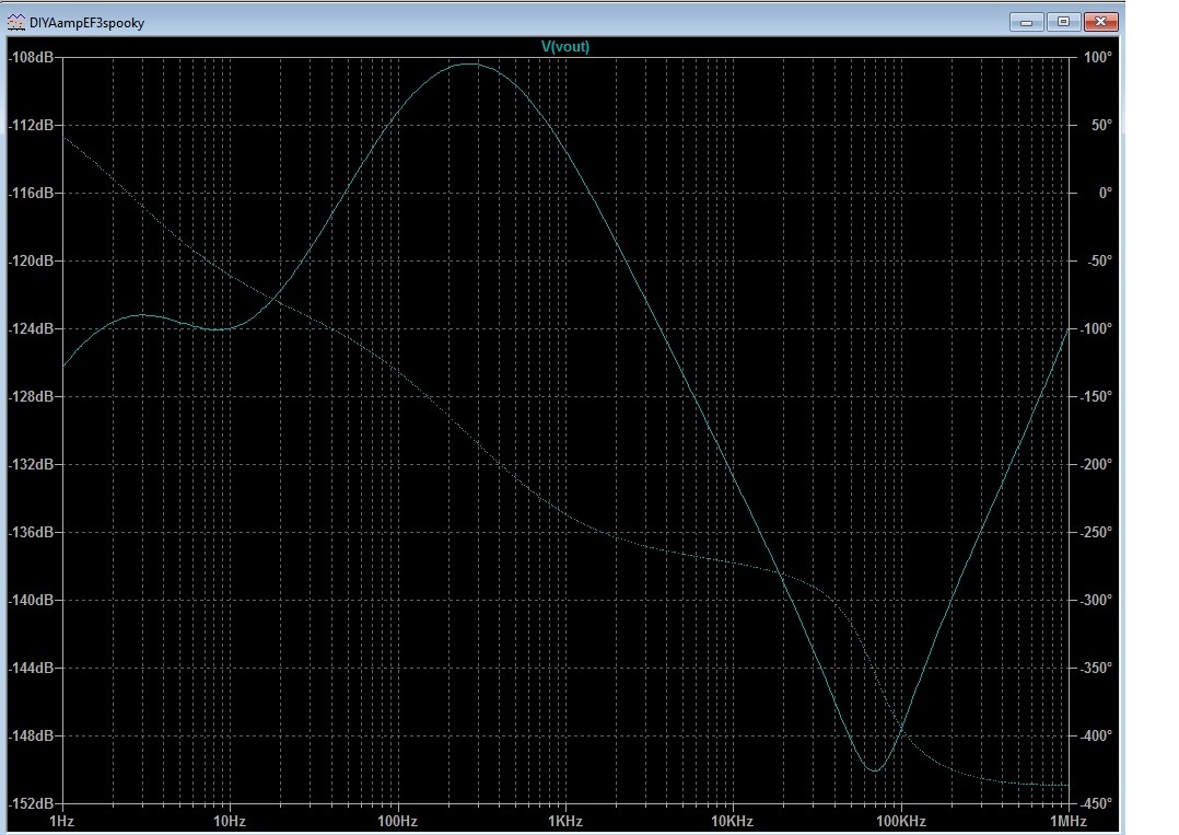

Here is the spooky V2 , since i was asked about it. It says "Bass Amp " .... as it's superior PSRR makes it ideal as a
Subwoofer plate amp.

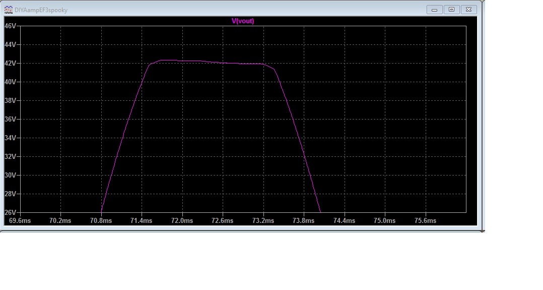

Another killer advantage is the clipping -" tubelike" with the Hawksford's. Hellraiser uses the Spook VAS - same deal.
WOW , 20-200hz spook with NO ripple eaters proves this topology IS a ripple eater natively. No wonder the Leach amp
could run with a BS PS. This also would give audibly superior bass performance , you would hear this as much more definition.
Edit - look at the 20k-100Khz rejection .... this is the ripple of a typical SMPS. What a perfect match.

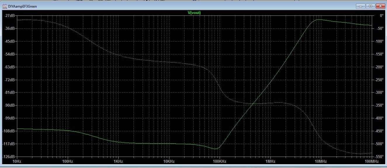

Strange finding , having just the right R/C at the Wolverine EF3 driver bypass dramatically changes the amp's PSRR.
A smaller cap (47uF-100uF) before the cap multiplier. Bigger is NOT better here. higher values (220-470uF) , actually reduce 60hz - 100khz rejection.
cap multiplier device value does not seem to matter much ... semi Hfe is the bigger player. For the big caps most are populating the OPS with ,
just lower the 1W resistors to 4.7R. The simulation does not take into account the actual ESR of the caps , bigger IS better here.

It sounds like there is positive phase PSRR and negative phase PSRR coming from different parts of the circuit and when they match, they cancel out. This may depend a lot on the Early voltage of certain transistors so the question is whether it is repeatable enough we can take advantage of it in practice.
Also consider the capacitors have ESR and ESL so if their filtering at 100KHz affects a null then these could be important as well.
