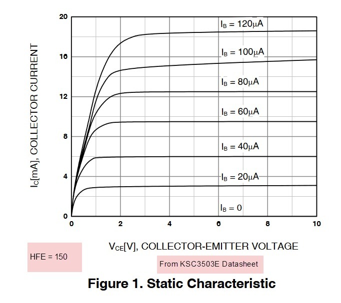

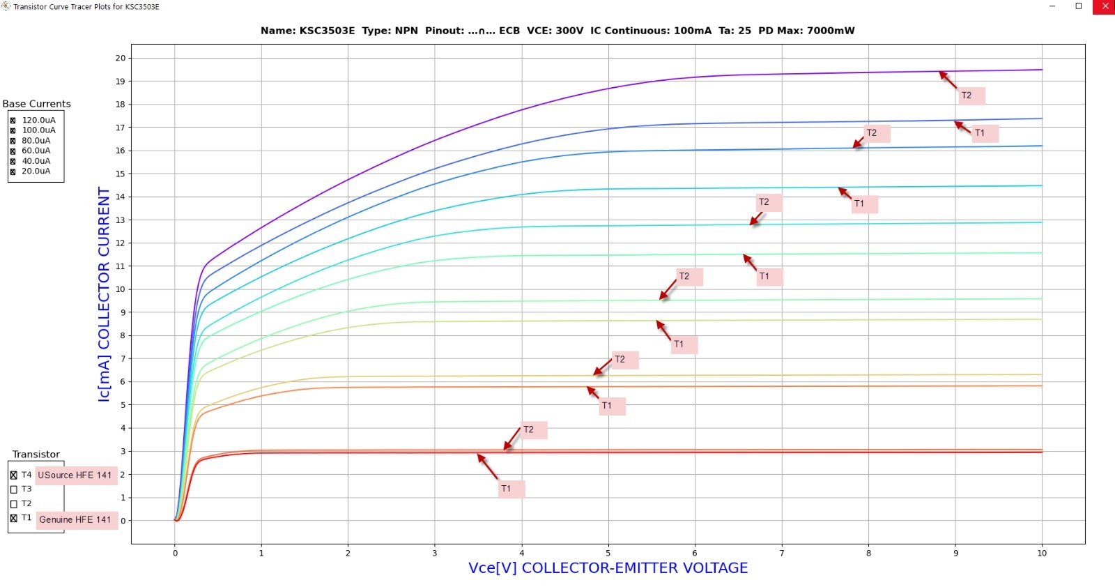

Definitely, genuine and they were plotted on my cure tracer as a double check. Many of the other parameters were verified by @jjs in the lab.I have Sanyo datasheets for those devices, do not believe Toshiba made them, also notice the exposed pad where as the ksa,ksc versions have a thicker bodies and are isolated

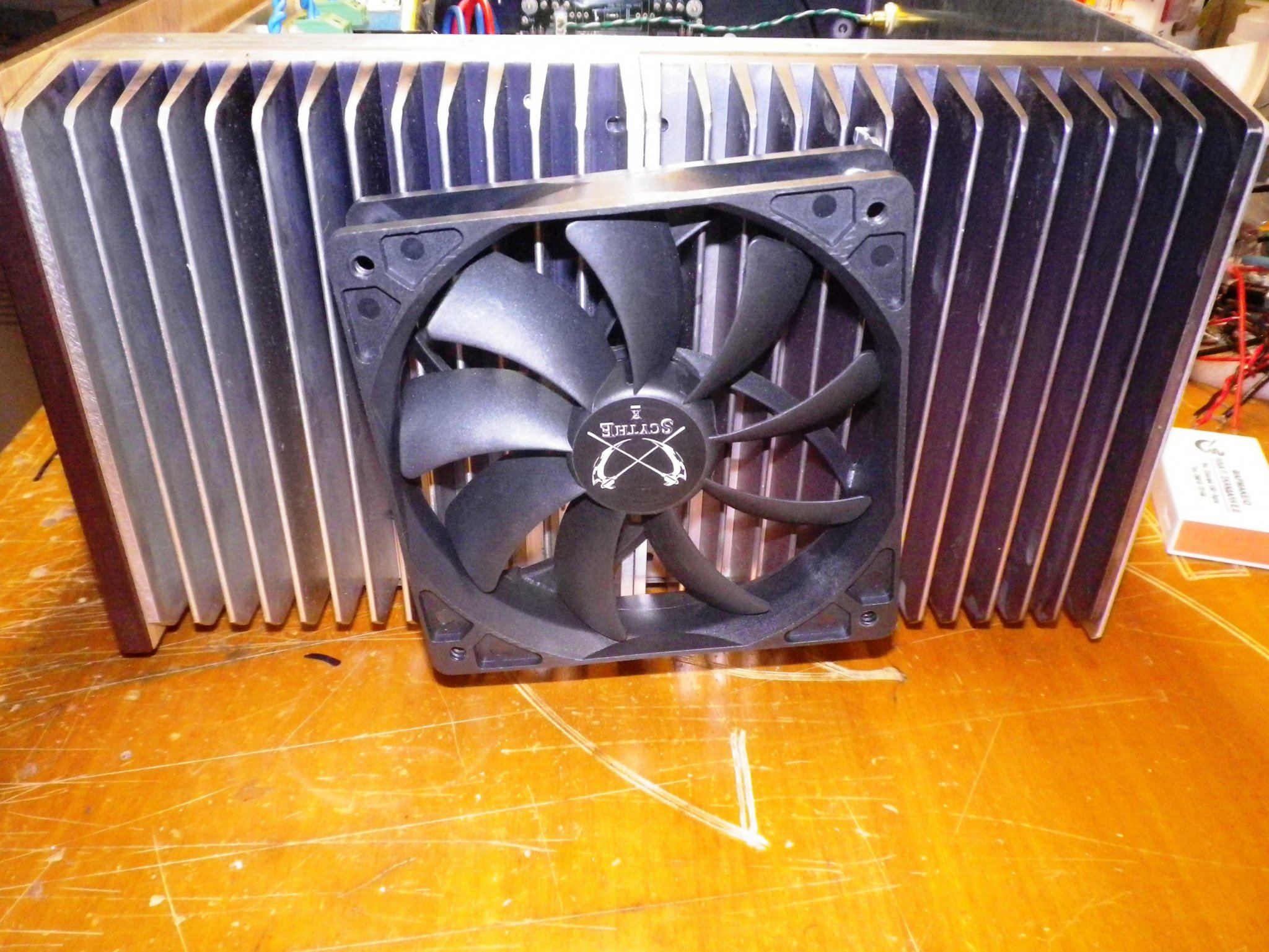

what do you believe ? its small ? i can put external fan controlled ....very very quiet..

You probably won't need that fan for normal use. If your bench testing into 4 ohms you might need it versus playing music. I guess what I'm saying if you know your going to be running it hard you can blow an external fan on the sinks to keep it cool. If you have to blow a fan on it all the time then your heatsinks are probably too small but I doubt that from the size of your heatsinks.
