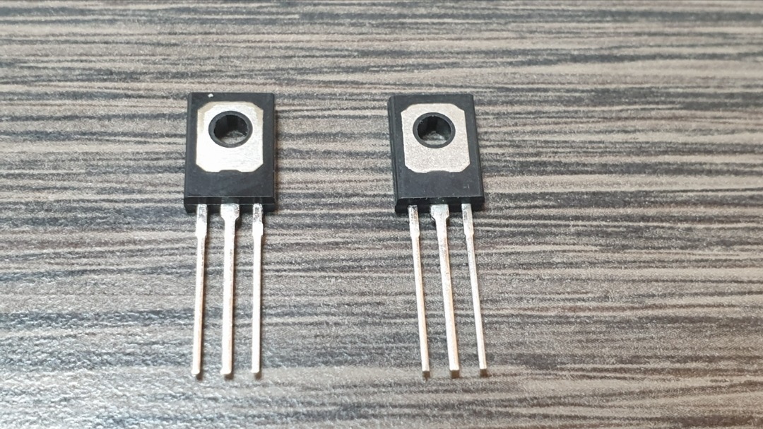

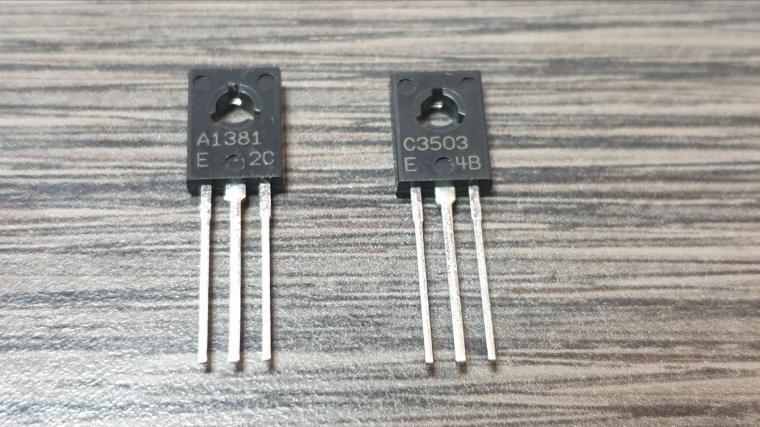

Try and get some KSC3503E for the pre-driver. There are a few of use on the team that have them. If you ask her publicly someone may send you a pm offering to send you some. I don't want to mention names as they may not want to be bombarded with lots of pm's.
Incase your wondering D and E are different HFE grades with E being higher. Ideally the pnp and npn pairs should have the same hfe grade. Check the datasheet for details. And just so you know these were not sourced from china. The are original toshiba 2SA1381E and 2SC3503E. They came with certification and were purchased from a reputable company in the USA
I have Sanyo datasheets for those devices, do not believe Toshiba made them, also notice the exposed pad where as the ksa,ksc versions have a thicker bodies and are isolated
