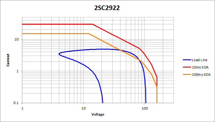

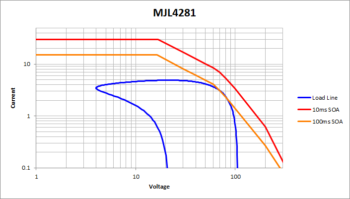

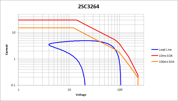

It's a lot more to it then cooling. SOA, Outputstage capacity, railvoltage and load. Clipping becomes an isue when driven like your calculations.
you can try driving a 3 pair 150W BJT output at +/-70V with 4ohm load (that dips into 3ohm) as hard as hard gets continuously for 8 hours. I bet it will not survive even if you cool it with liquid nitrogen.
Yes, with a 3 pair output stage not just any transistor will work on 70V rails. These plots show the temperature derated SOA(per transistor) with a heatsink temperature of 60°C per driving 4 ohms at 45° phase angle (which means the real part of the load is 2.83 ohms and the reactive part is 2.83 ohms) using 3 pair. These plots also take into account the rails sagging by 10% which would be the equivalent of a 1200VA transformer for two channels. This is why we made a 4 pair option, so more than a select few transistors can run on 70V rails.
