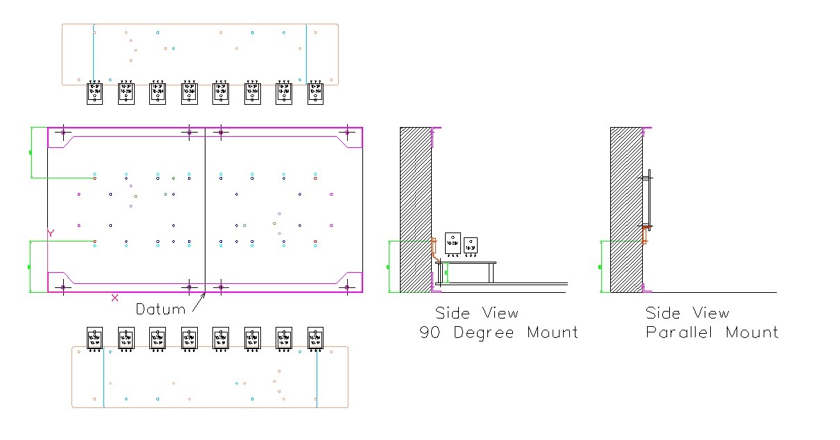

Me and Stuart are currently working together to add the holes for the Wolverine board in the best possible way to avoid misalignment or huge tolerance issues. We plan to drill both heatsinks together instead of drilling one at a time so this problem should be avoided.
Our idea was to center the layout on the heatsinks instead of having it shifted towards the bottom as in the Deluxe 5U chassis, I am attaching a screenshot to give you a better idea of what we are currently doing
This is a great idea, cant wait to see what you guys come up with !Me and Stuart are currently working together to add the holes for the Wolverine board in the best possible way to avoid misalignment or huge tolerance issues. We plan to drill both heatsinks together instead of drilling one at a time so this problem should be avoided.
