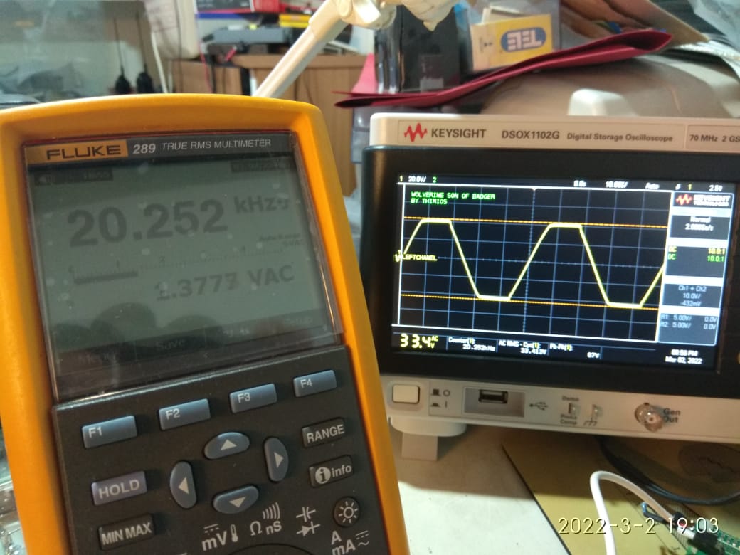

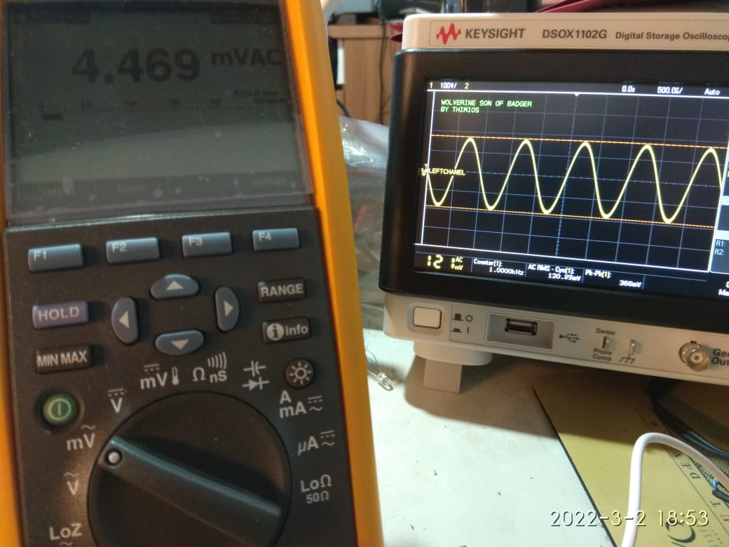

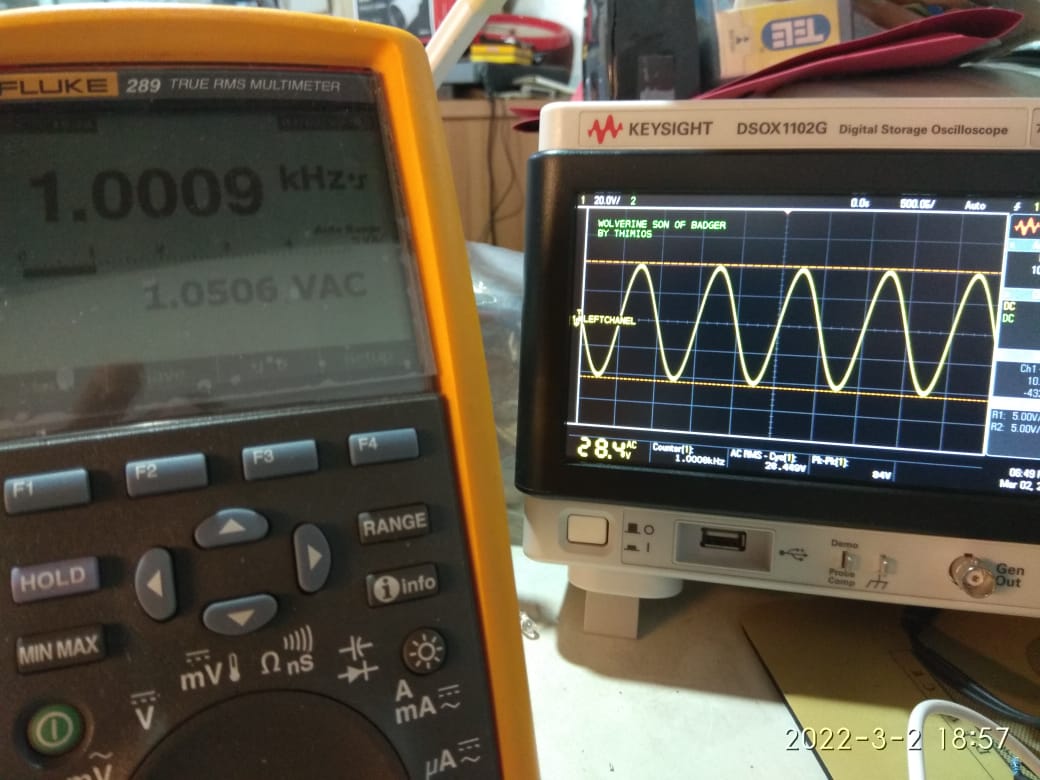

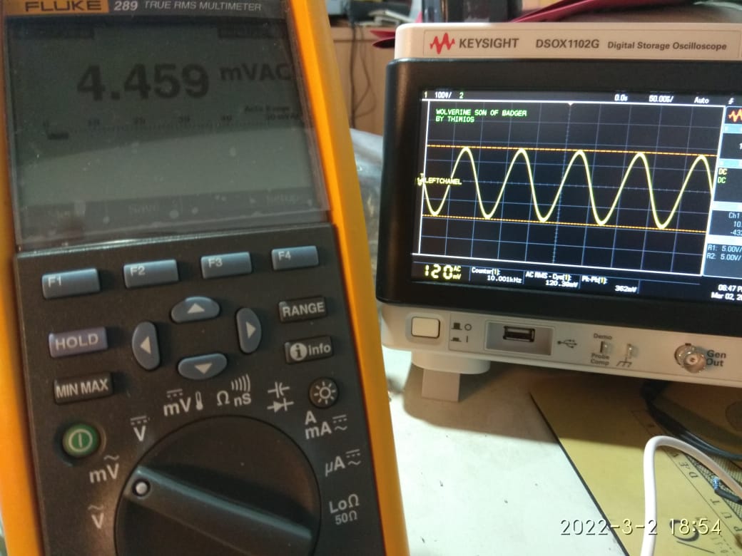

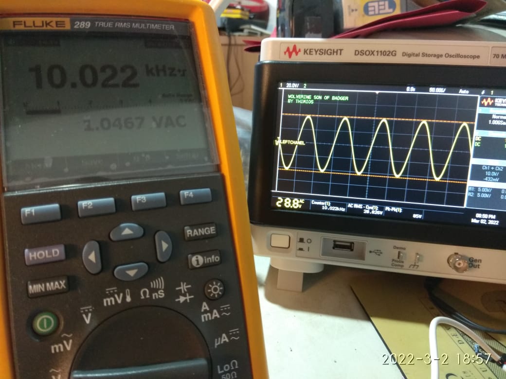

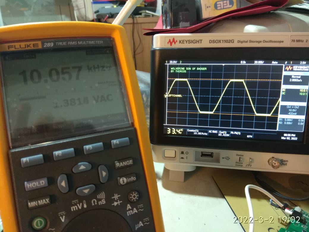

Hi Guy's
Just a quick update.
Thimios has completed the build of the EF3-4 precision output pcb with the Wolverine IPS pcb.
Please find attached some of the sine wave results he captured.
A big thank you goes out to Thimios for his work on this PCB and providing us these results.
High level,just before visible clip - 1khz, 1.05V in, 28.4V out load=8ohm.jpeg87.9 KB · Views: 173
High level,just before visible clip - 10khz, 1.05V in, 28.8V out load=8ohm.jpeg88.7 KB · Views: 171
Sine wave - Clip Behaviour Power supply=+-50V Bias=88mA Load=8ohm.zip1.6 MB · Views: 155

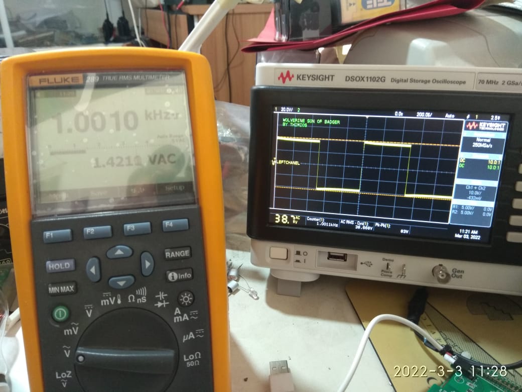

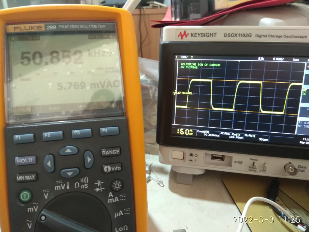

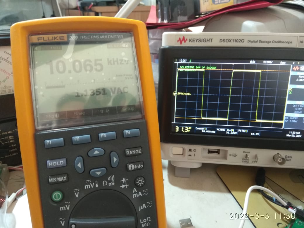

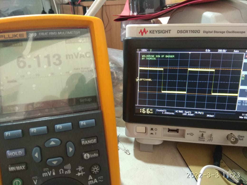

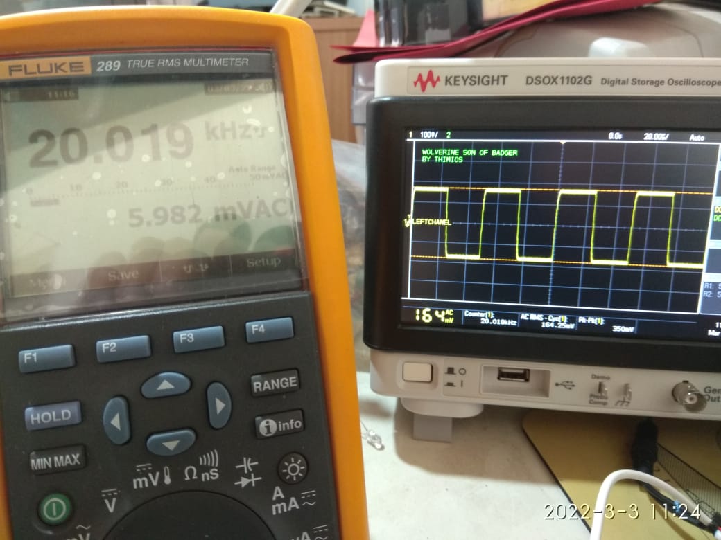

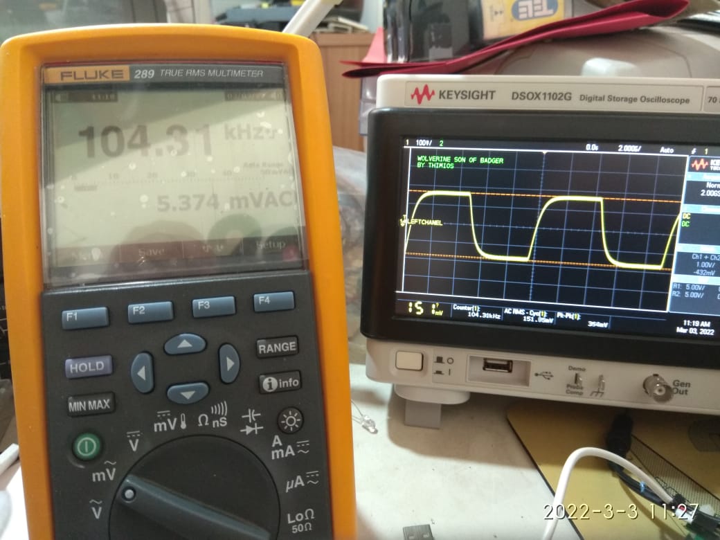

Hi Guy's
Just another update.
Please find attached some of the square wave results Thimios captured.
Another big thank you goes out to Thimios for providing us these results.
High level, 1khz, 1.4V in, 38.7V out, 83V Pk-Pk, load=8ohm.jpeg93.1 KB · Views: 164
High level, 10khz, 1.1V in, 31.3V out, 64.7V Pk-Pk, load=8ohm.jpeg90.4 KB · Views: 172
High level, 20khz, 1.1V in, 31.9V out, 66.7V Pk-Pk, load=8ohm.jpeg91.3 KB · Views: 168
low level, 1khz, 6mV in, 166mV out, 368mV Pk-Pk, load=8ohm.jpeg86.2 KB · Views: 158
low level, 10khz, 6mV in, 166mV out, 358mV Pk-Pk, load=8ohm.jpeg91.9 KB · Views: 146
low level, 20khz, 6mV in, 164mV out, 350mV Pk-Pk, load=8ohm.jpeg85 KB · Views: 161
low level, 50khz, 5.8mV in, 160mV out, 350mV Pk-Pk, load=8ohm.jpeg87.1 KB · Views: 160
low level, 100khz, 5.4mV in, 151mV out, 350mV Pk-Pk, load=8ohm.jpeg90.1 KB · Views: 163
