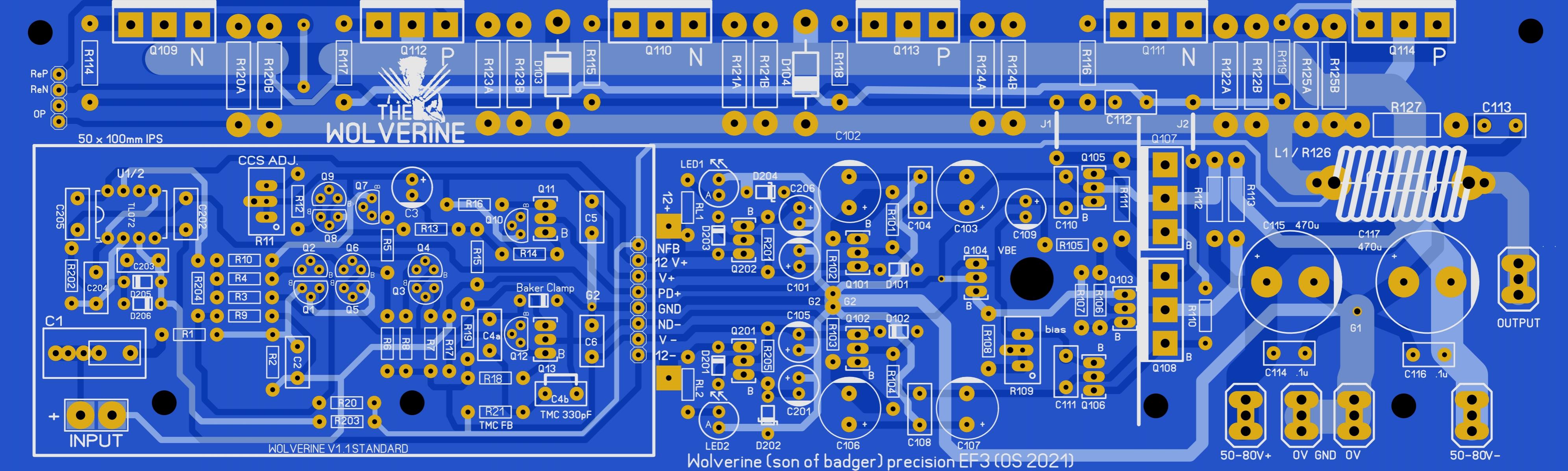

Use solder pad jumpers to make 'removing' the default IPS really easy. Or it is a card bought as part of the kit. A panel of two OPS boards and two IPS boards would be straightforward for manufacturing.
I sold the boss on a updated Blameless to modernize the current one.
If a user wants to use the modular approach , I would suggest just not
populating the wolverine.
You see the extra 12V supplies. Easy to just make a wolverine daughtercard.
Female header will match the male one onboard.
Thanks JK , you see I am utilizing your "style".
OS
It looks like you have loads of room on the input board! Hopefully Spooky will fit with no issues.
That is why I made the 12V supplies integrated with the OPS.
I could pop off spooky in few hours. Spooky and greenamp are way more
symetrical. I could go way more dense , I'm not even making full use of
the second side with Wolverine.
PS - I forgot the main IPS decouplers.
Fixed the trimmers (both) , too.

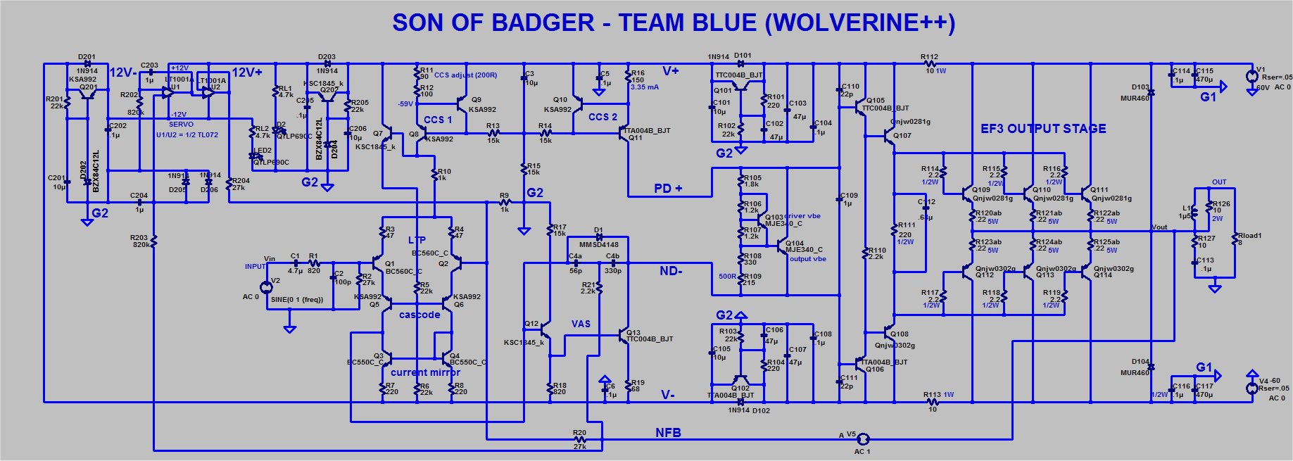

Bias can easily be measured with the overcurrent connector, either at the protection board if used or with a jumper cable.
In case when trimmer is from outside reached, the same must nead for the test points.
ReP and ReN plus OP could be main OPS testpoints.
Or just don't cut back one P channel and one N channel emitter lead.
Measure to output.
CCS should be preset .... It just serves to compensate for different devices (3.2 mA ideal - hey ....1k/R10 resistor).

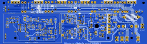

It looks good. Looks like some recovered macros from the SM artwork, which is cool to see.
I started a layout myself in a similar direction with a different design using a daughter card IPS, though not related to the slews nor UMS compliant.
It will represent a nice upgrade to the Badger and should go over well with the DIYA store.
What is wrong with those little Wima 63 V 4.7uF's.
OS
After all my "humming and hawing", and discussion with AndrewT, and probably a few others I can't remember... That's exactly what I chose for my 2.4 Badger.
Perhaps someone has an objection... But whats good for the badger, is good for the wolverine. No, wait now... If it's good for the goose, it's good for the Gander. Meh.

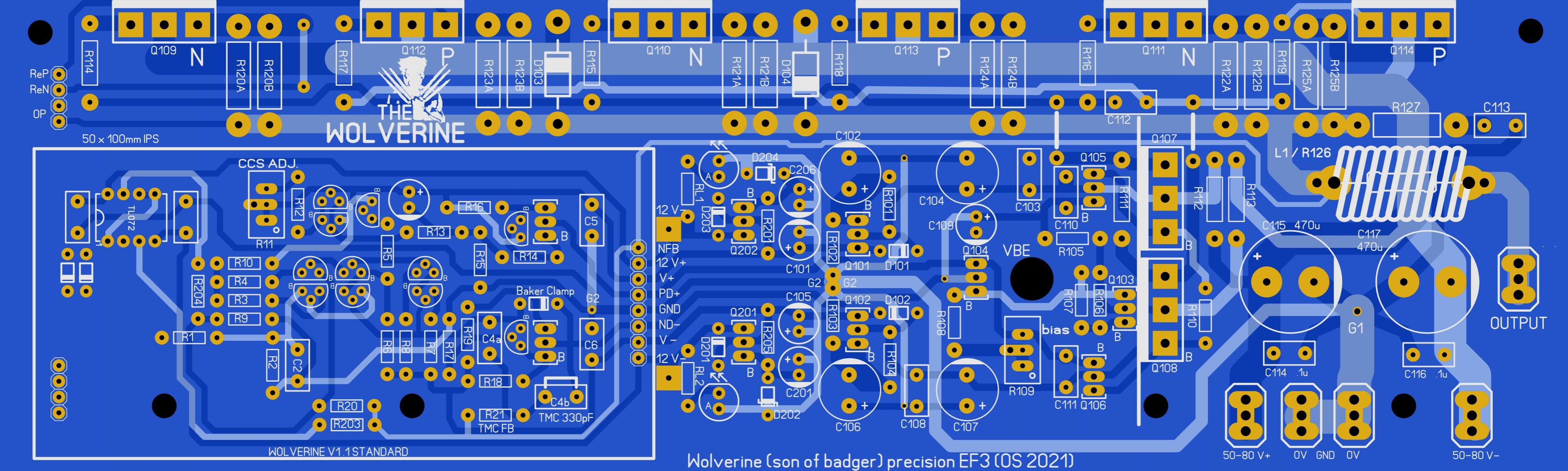

All done , Maybe just some final tweaking.
Please help me find any errors. Two photo's and the Sprint .LAY6 files.
Big caps up to 15mm will fit perfect. 5,7.5, 10, 12.5 lead space.
Those big 38mm ones , you might still be able to fit them.
OS
OS
That 1n4148 was just for simulation. Yes , the BAV .... I wanted to see
how the C and reverse leakage would affect this design.
I'm looking for trace errors , device pinout/spacing , reverse diodes ... etc.
Or wrong device names .... just found one. R201/205
