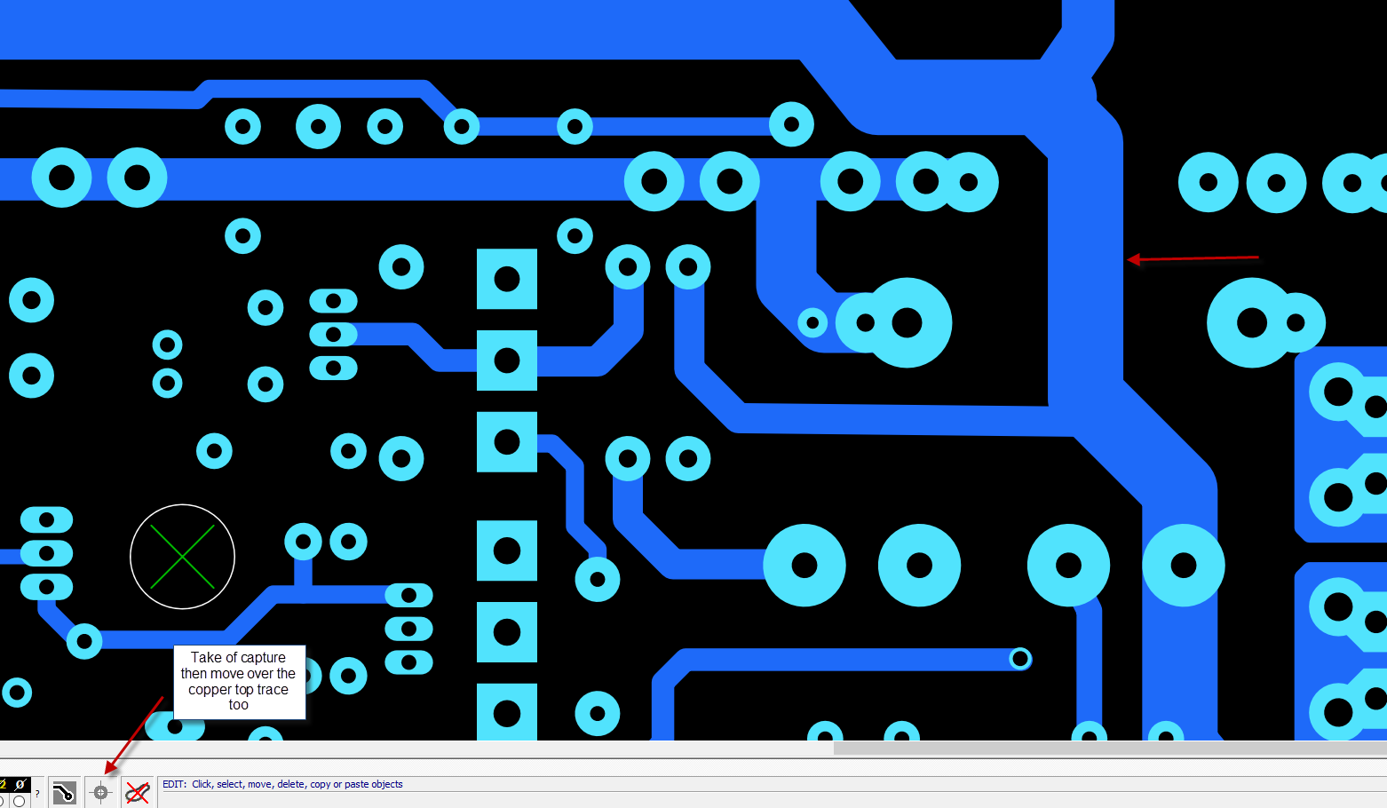

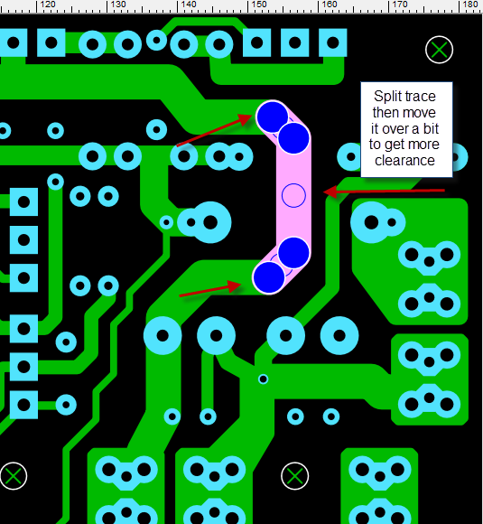

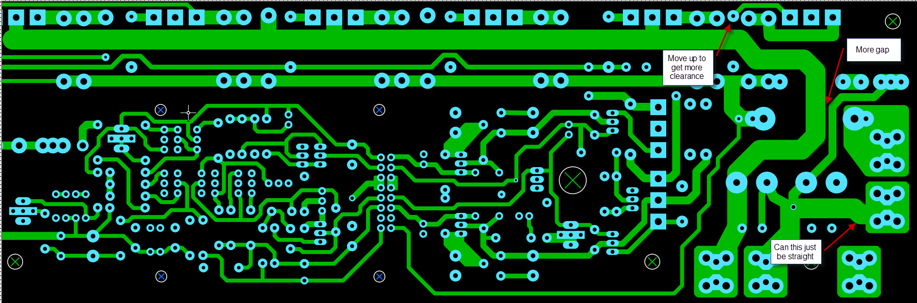

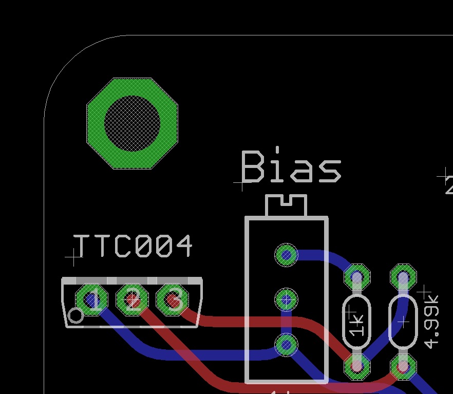

Hi OS,
I like to isolate the top and bottom copper layers to see that layout of the traces
in isolation. This way you can spot if traces are to close of if there is a better route to the same net.
I have just marked up a few that I see straight away.
I sure you probably do this but I'm just trying to help out.
You will also need an outline and I think some silkscreen over the holes looks great. I posted a macro with the outline for you to use as a starting point if you like.

Hi OS,
Thank you , Stuart. Yes , ground /rail creep near C113 ... while not critical -
is fixed.
Circles around mounting screws ... nice !
Your best idea was the preformed TO-92's. Thanks !

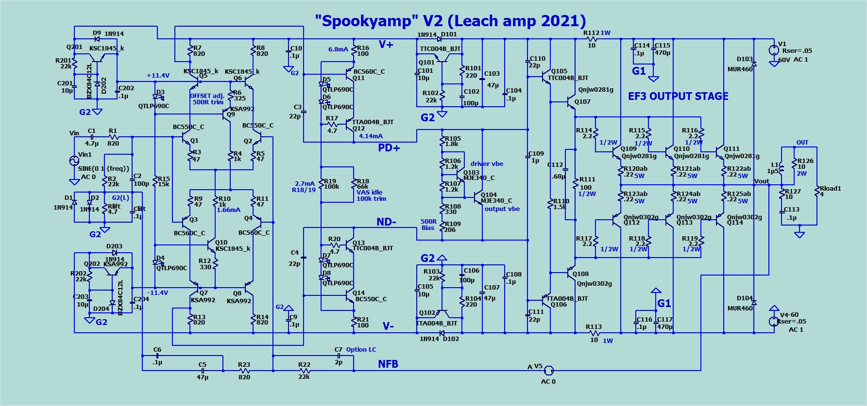

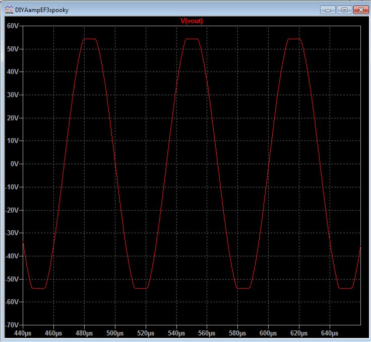

BOO !! Spooky V2 ....
What a neat (different) design (below 1). I want one for me SUB !!
I will lobby to try to have this as a store option. Wait till you see my
layout on this one !!
NO Servo !! Ha ! 😛

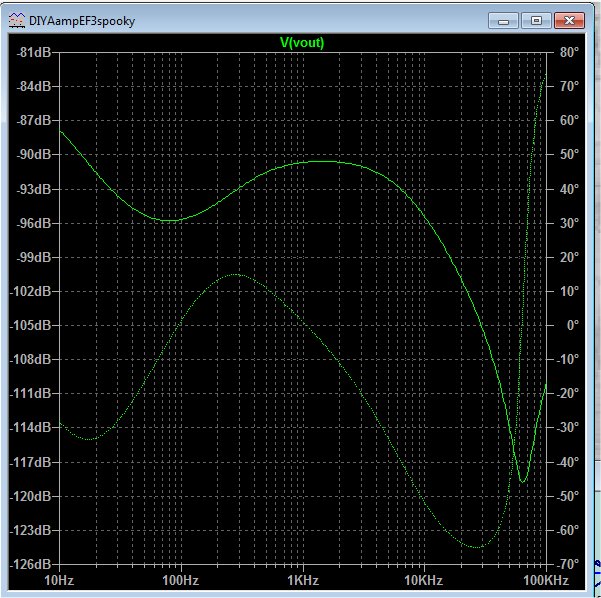

1. - Since the BCxxx P channel devices seem to model with less beta in general ,
Just a single trimmer (R6 - 500R) is needed to balance this beta (imbalance).
Since R18 "bleeds" off excess current to establish the VAS mA's , the general IPS current
is not as important. (better than V1.2)
So , offset is determined by the cap C5 (and R6). No "dirty servo".
Q1-4 on the layout will be REAL close , a drop of thermal paste ... heat-shrink
all 4 together.

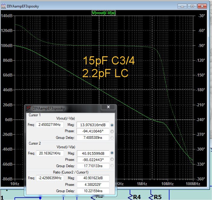

2. - C3/4 and C7. C3/4 can go as low as 10pF with 2.2 - 3.3pF lead compensation.
This amp has crazy bandwidth. Optimal with C3/4 = 15pF
and LC/C7 at 2.2pF (below 2). Margin is better than the Wolverine even
at this obscene UG.
3. - What was I thinking ? Shunt regulators on the V1.2 ???
Way better (and cold) with the zener pass regs. Ghosts are COLD! 😀
(below 3) PSRR is way better here.
4. - CLIPPING !! NO match ... Hawksford will clip all day (below 4)-(self clamping).... LEDs (D5-8) ,
will pulse. Funny the OPS bias reduces from 75mA to 48mA with heavy
overload. This is actually good.
This is SIMPLE. Just 14 X Q / 24 -R / 7 - C / 6 -D , most are similar values/
types. AND it performs better ...can't lose here.
LT attached.

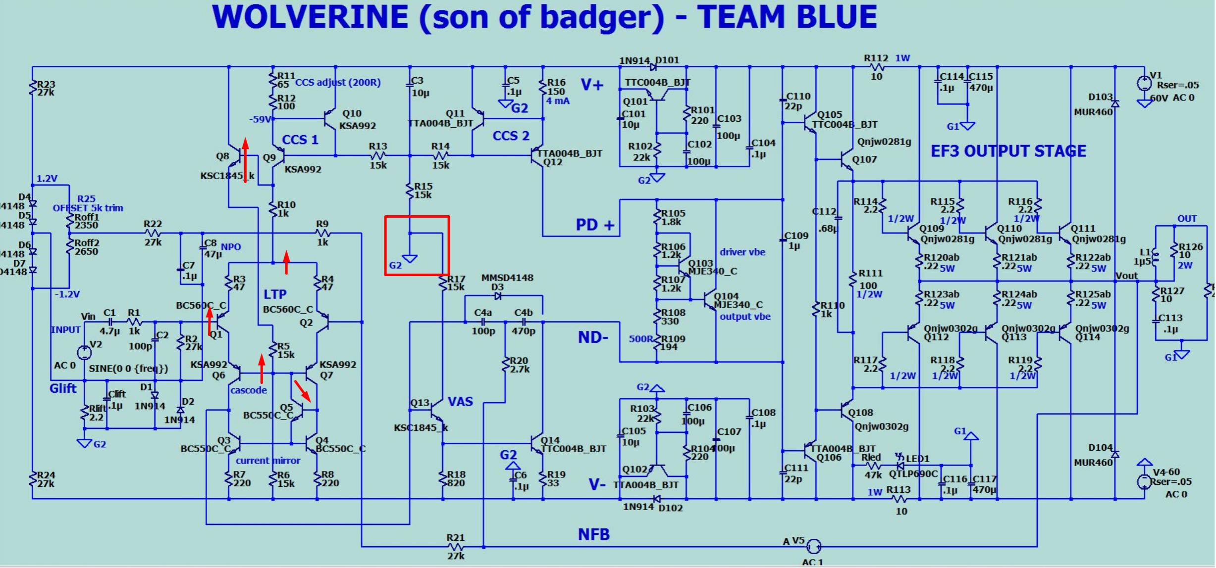

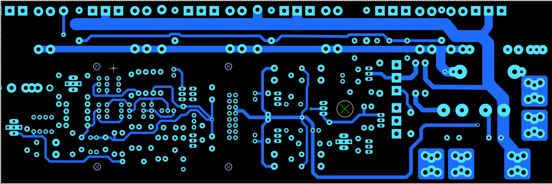

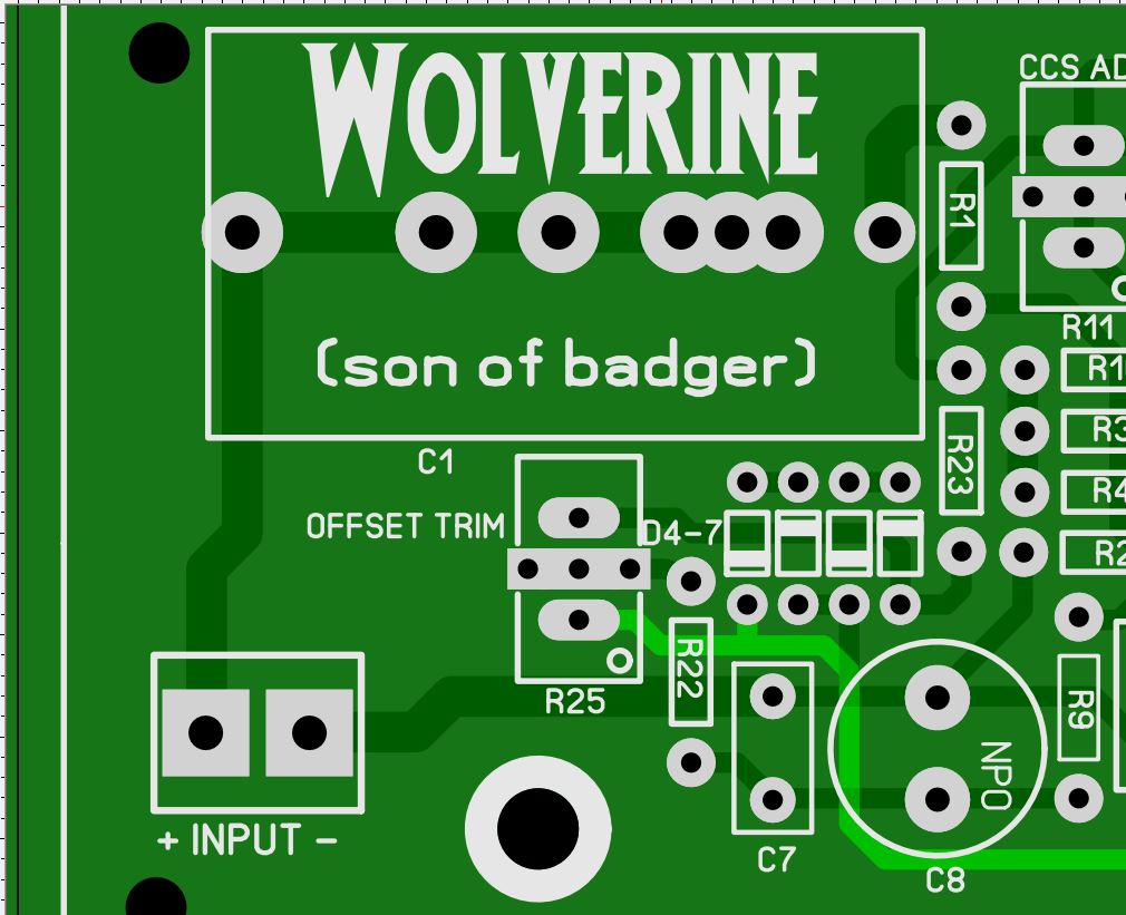

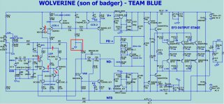

How does the layout look now with the new transistor macro?

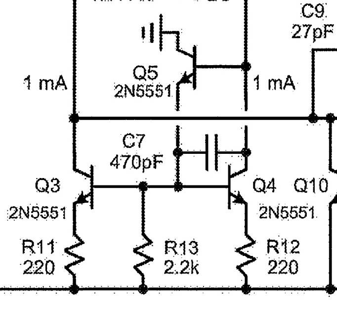

Hi Pete, looking at the design, I have a couple of questions regarding the Input stage. I find the way you have done the cascode and the mirror intriguing:
1. The cascode is rigged to follow the common mode of the differential pair (where R3 and R4 join) by virtue of emiter follower Q8 and R15. But, you divide down the voltage to ~1/2 due to the ratio of R5 and R6. Therefore, the VCE of Q1 and Q2 will be modulated. While this is not the end of the world if Q1 and Q2 are matched, I found this arrangement odd. You can potentially replace R5 with a Zener diode to make the bases of Q6 and Q7 track the common node of the diff pair better.
2. The beta enhancement transistor of the current mirror: Why does the collector of Q5 not go to G2? This one is a bit more concerning.
Referring to attachment:
- The input signal modulates the common mode node of the diff-pair as well as the bases of Q6 and Q7.
- Therefore, the VCE of Q5 is modulated.
- This modulation injects current to the input of the miror via CJC and due to Beta modulation
- This current is input signal dependent
Therefore, you are injecting a distortion current to the input side of the mirror since Beta and CJC are non-linear.
Fix: Tie Q5 collector to G2 via a resistor.
Other problems:
+ Q5 is biased only with base currents. Ths is bad.
- If the current mirror turns off (say amp is slewing where Q1 takes all the current) it will take forever to turn on, and the amp output will stick. Do a large pulse test to see what happens.
- Need a resistor from Q5 emitter to VEE
- Also, if you add this resistor, a capacitor across Q5 VBE to bypass Q5 at HF is a good idea.
Other problems:
#1 is what the original slewmaster Wolverine had.
Q5 seems to be more trouble than it is worth.
Remove it.
Both changes are easy.
If anybody made the present board , it could be jumpered out easily.
Remove it.
