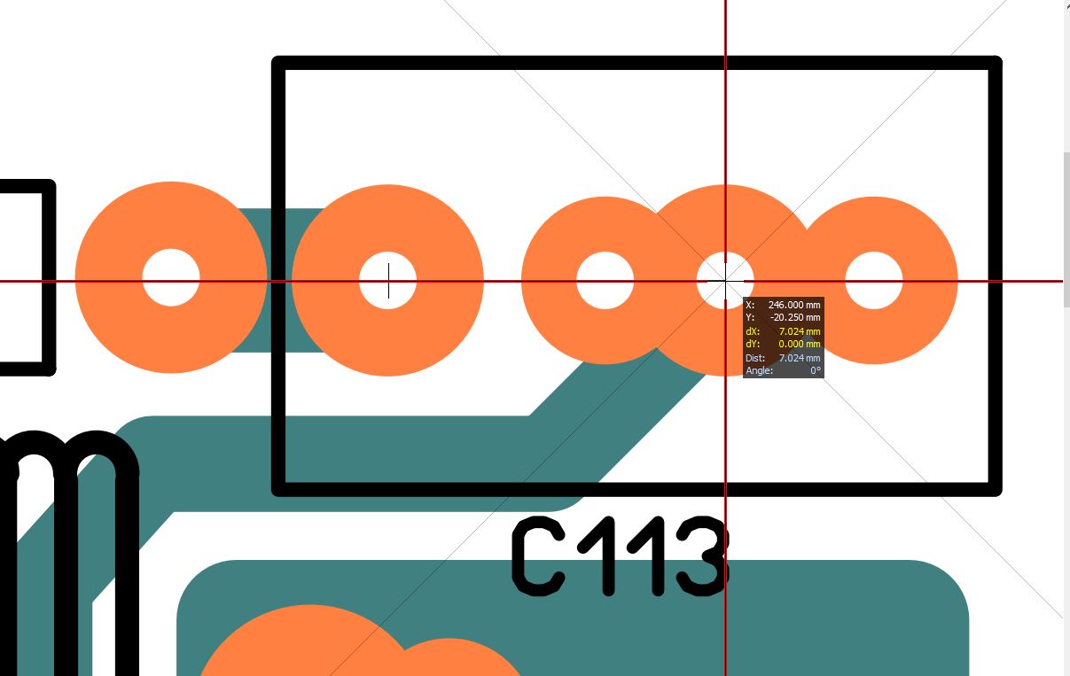

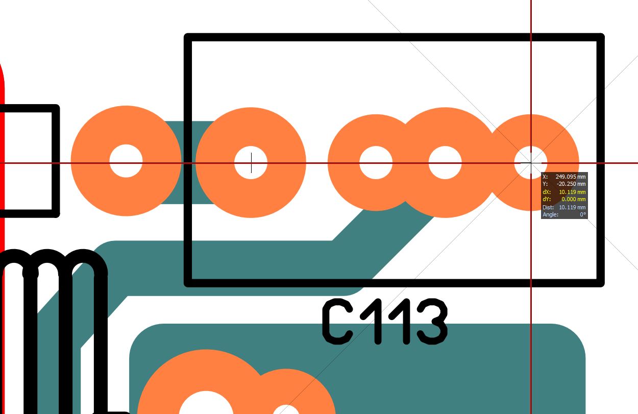

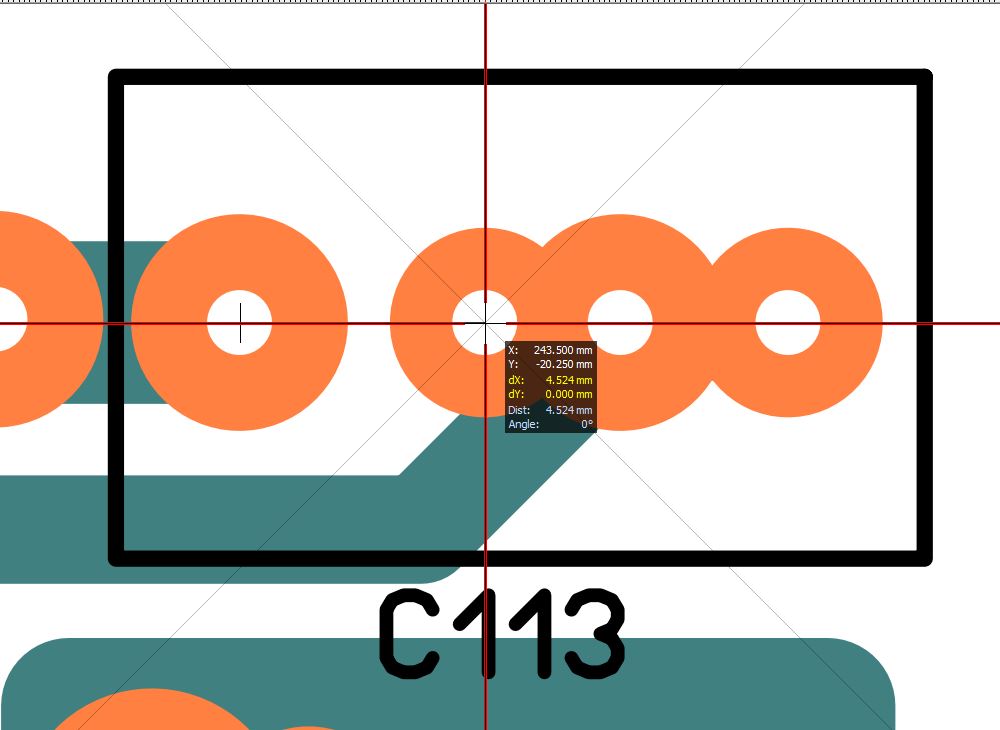

OS do a small tweak to C113 pitch distance 5 mm, 7.5 mm, and 10 mm don't mind my cat Pushi 😛

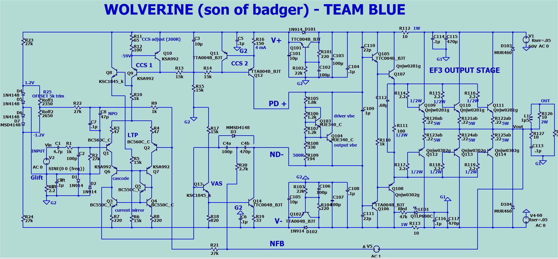

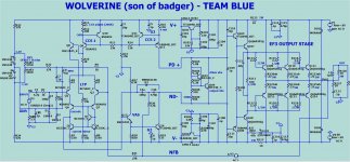

A few little bugs ...
Silk tweaked ,
R25 named /changed to 5K , R23/24 lowered to 22-27K. D4-7 need more current for stable +/- 1.2V reference. (below)

Looks good! If nothing changes on the layout by this evening I'll get some prototypes coming.
I see one other bug D3 is not connected on your schematic.
D3 is optional and not connected to facilitate simulation. 4148 model , I take
a 4ppm penalty. I lost my "BAV " diode model.
I will note D3 as an option.
Same with C4a/b. A or B jumpered with the other at 47-68pF will be
CMC (miller). C4a +b , 56p/270p to 100p/470p is TMC.
CMC = no R20 .... TMC = R20 - 2.7K.

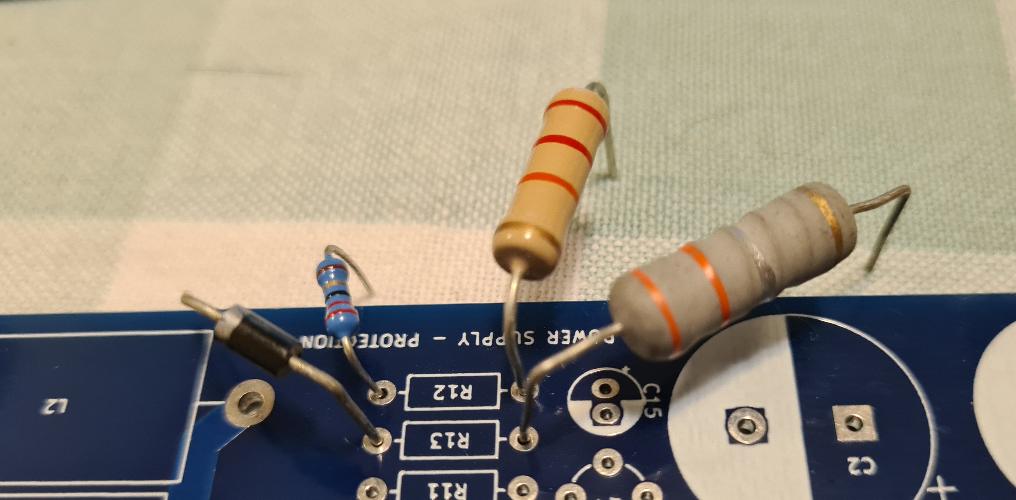

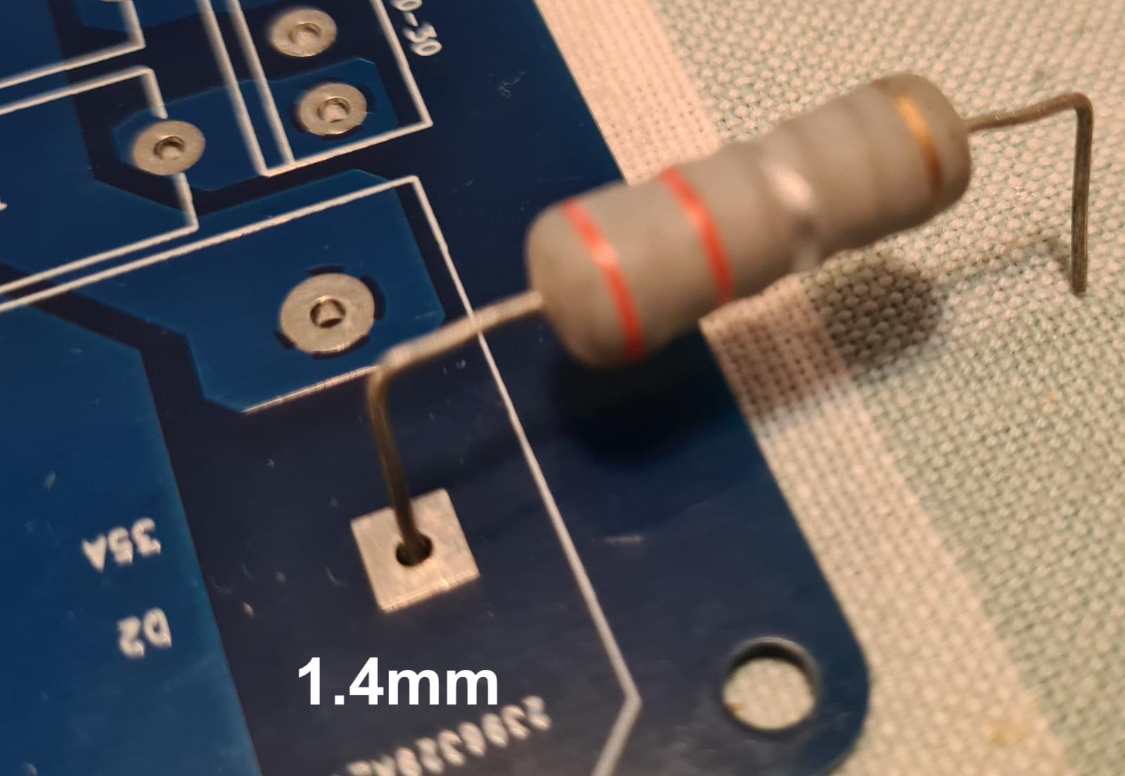

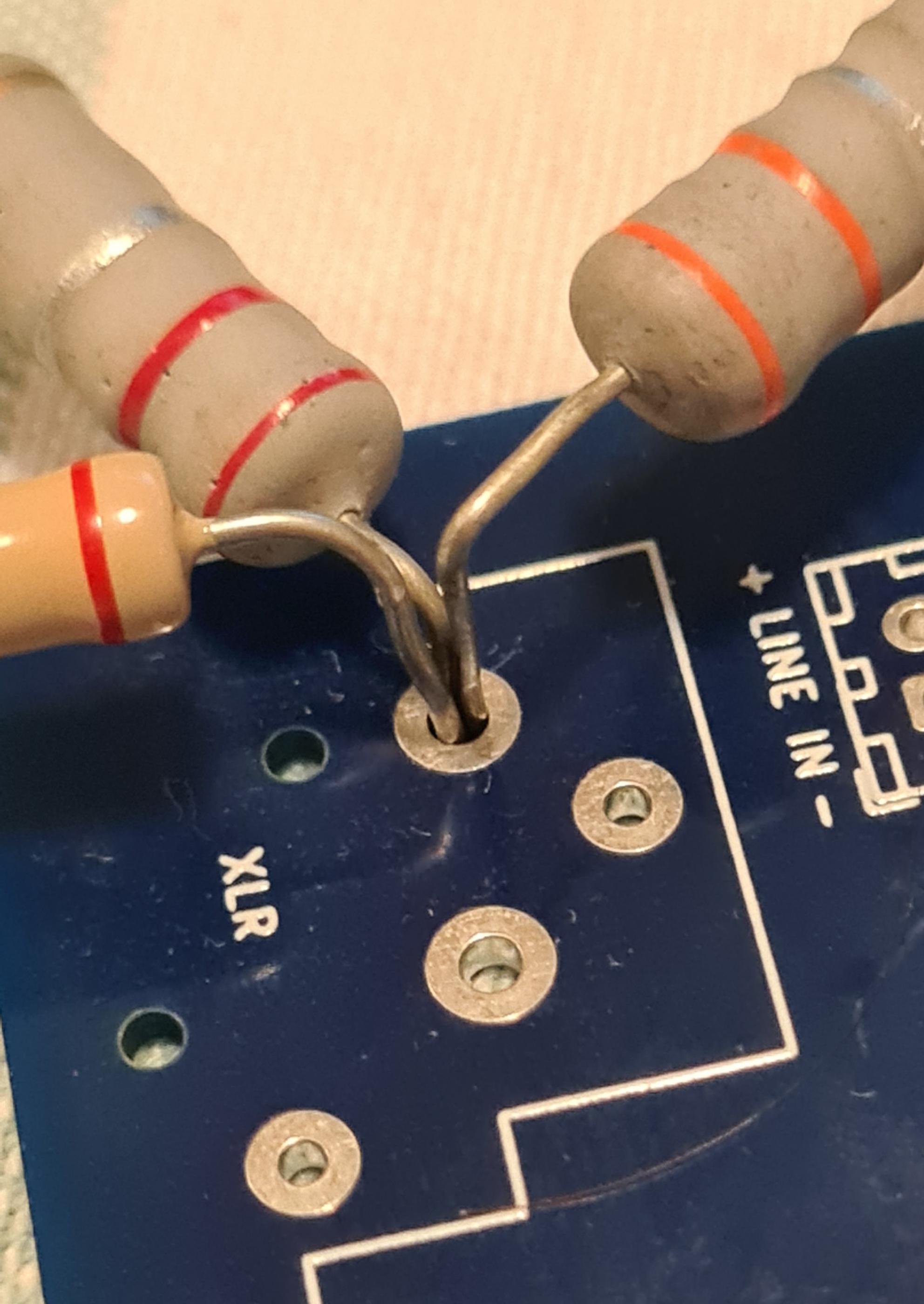

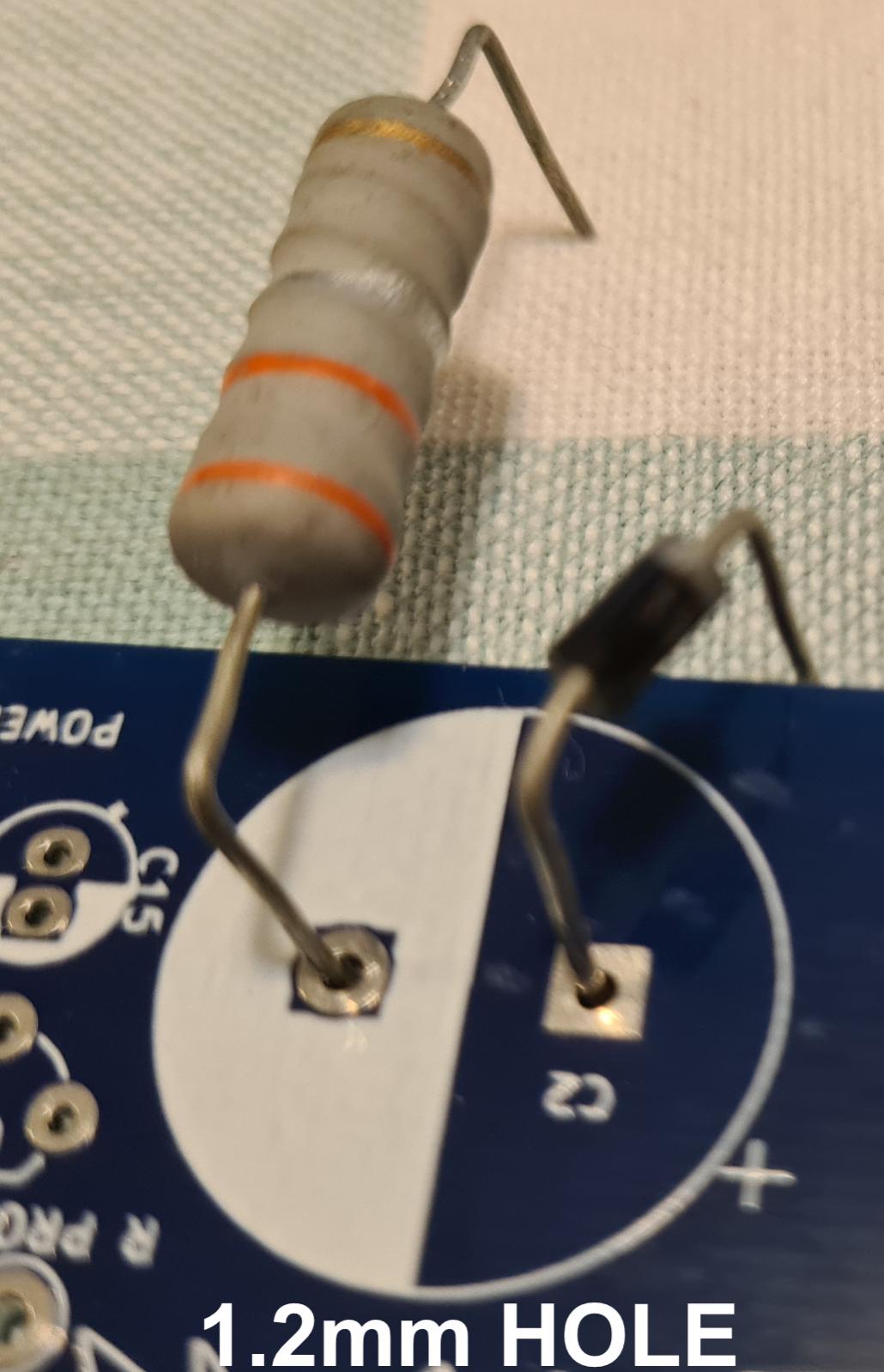

I just did a quick comparison on hole sizes between Diptrace an the Wolverine board. Diptrace 1/4W resistors have a .96mm hole instead of .8mm. Same for the headers. 1/2W and 1W resistors have a 1.17mm hole size instead of 1mm. Emitter resistors are 1.7mm instead of 1.2.

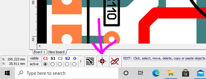

Is there an easy way to alter these in Sprint?
tips and tricks for pitch distance
C113 pitch distance 5 mm, 7.5 mm, 10 mm tips English - YouTube
I forgot to mention that grid capture has to be enable 😛
Does that mean diptrace is right ?
Those 2 big resistors (KOA and Vishay) are .8mm +/- .1mm. If those specs are right ... no issue w/ 1mm.
Too big a hole would make populating the board more difficult.
All the small stuff (TO-92 ,1/4w R's,1n914s ,trimmers) , are .62mm (+/- .1mm).
Inductor coils (2mm) , NJW0281 is 1mm +/- .2mm.
TTC004b is .75mm +/- .15mm .... So , .9mm max - I'm at 1mm for those.
I looked at a LOT of datasheets to not repeat the Badger mistakes.
At least 10% over MAX spec. on all.
OS
OS
I've assembled tons of boards with the patterns used in Diptrace and everything fit's nicely. Most of the patterns are drawn from manufacturer's recommended pad sizes. Having too large a hole won't make things harder to assemble, it'll just cause more alloy distortion for the crowd that thinks the blue wire sounds better than the red one.
@jwilhelm , so what you saying is that you used 1.7mm for emitter resistors tons of times ?
