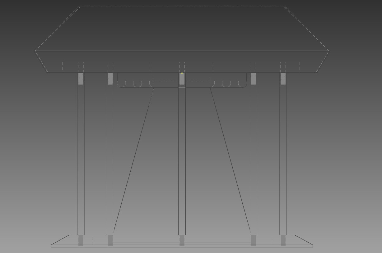

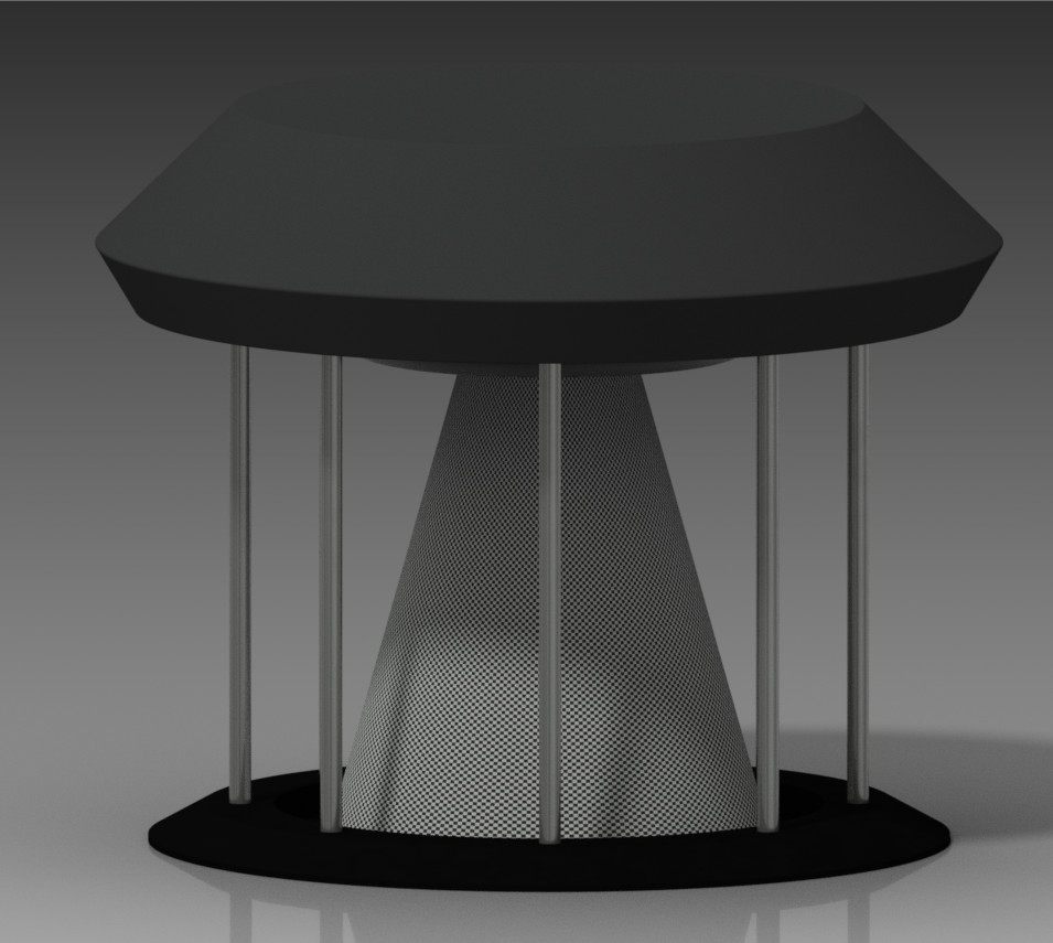

Hey Dale, I would hope I at least understand the basic principals of the driver. I have put together a very quick and crude way of making a pretty close replica of the DDD German physics unit. I will re-post it here in one place. I would love a chance to talk with you. I do not wish to compete at least not with a Walsh driver. I will sign an NDA. You can email me anytime or pm me.
The DDD driver
First piece of info. German Physics seems to use This carbon fiber at 0 degrees.The weave checks out orientation and weight are as far as I can tell exact matches.
The Weave 2.9 oz Carbon Fiber Woven Fabric: 42 inch Wide
Alright folks here is the completed model. Pretty accurate from what I can see. Structural components are added. This thing is ready to be built. Who ever is interested post and Ill upload in that file format I know how frustrating cad can be so I think per person basis is good. The rods are 144mm..... since i dont think anyone cares for anything besides the cone here are the dimensions VC= 2" MOUTH= 5" HEIGHT= 5.5"
Materials : Mirror, 2.9oz plain carbon, Epoxy, vacuum pump/press, scissor, template, spray adhesive, glue, sand paper.
Process: lay mirror on table, spread a base of epoxy, lay carbon, spread epoxy, vacuum-bag, or lay a releasable weight on top to firmly press, make a cutout template with cad and spray re-positionable adhesive then lay the template on the carbon. cut out with the scissors. sand edges to make up for cuts. remove template, roll to the proper shape and glue the ends, then do what ever treatment then proceed to glue to terminations.
Heres the break down on the w's of the process.
Use a mirror to get a mirrored finish. A release agent like Frekote must be applied to the surface. For resin prep I recommend the following. MGS resin or really anything with a slower cure. Mix as accurate as you can a digital scale really is the best. mix well. heat slightly to lower the viscosity and degas. Now apply a thin layer on the mirror apply the carbon I recommend cutting a rectangular area that is 2 inches larger in all directions than the cut-out to allow for cutting of flashing. I also recommend taping the edges The process for this is easy. Measure the area of carbon you want. Tape the outline with scotch tape of a non stretchable tape, then use a rotary cutter and cut in the middle of the tape. You now have a very robust sheet of carbon. Next soak the carbon and spread using a bondo spreader the small ones making sure to not only spread the epoxy but also the fibers flat take your time and let it set in. Then vacuum bag or make a releasable press with the same Frekote. Cure for 3 days and then post cure IN THE MOLD OR UNDER PRESSURE!. This will prevent warping.

You are indeed a smart fellow and are right on track. Increase the length of the cone to 6". Use the most powerful magnet you can get, with a single layer edge-wound VC on an Aluminum or Titanium former. No paper. Must also be able to handle high temps. Keep the weight of the VC down. 2.5 to 3 grams. The Carbon fiber cone can take more pounding, but it will not give the high end that Titanium will give. You are at the very limit of the thickness for this cone, .006" + resin, .008" to .010. too much.
You are correct, cone weight not as important as VC weight. VC represents the mass that must be accelerated or decelerated. Internal cone damping is a must and can be tricky. Foam, putties and or expanded neoprene. BTW cone suspension is also very important. A flexible spider and surround are a must.

Dale thank you for chiming in. I am at the very limit but the odd thing about the carbon and resin mix is that is can end up thinner than the carbon fabric as well as thicker and the same thickness. Epoxy does not always add thickness. I agree on the extension to 6" it was an error in measure a slight one. I agree on everything else and for me is common knowledge. I think I have said all of that in various post. I know the recipe but you are the master chef. A flexible surround? really I thought it needed to be stiff. The only place I still have questions is at the surround. If you dont mind answering either here or through a pm with an NDA if youd like.

Dale, you said enough to verify what I've been proposing; a strong driver with a high heat tolerance. Keep everything as light as possible. I might take exception about a flexible surround, since the patent seems to stress damping to minimize (or hopefully eliminate) reflection of the descending waves. I've thought that Sorbothane or the like would be preferable to a flexible medium. I'd like to give it a go in a later version....
