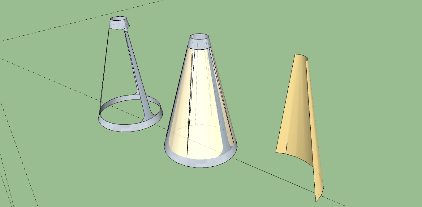

I revised the mountings on my Walsh tweets that are currently atop the 'front' V.3's, flipping the cone over to align it properly (vc up, base down). The dispersion isn't aimed at my ankles anymore, and (surprise!) it made That work. Better progress made with getting the APO Eq to work properly, and applying a 1/3 octave band set to the array. "By ear' I can get the array tuned to knock the resonances down and perk the tweets up...
I just have to avoid getting overly enthusiastic with the db's. Even broken in they, like any speaker, start getting a bit ragged when pushed. But I'm pleased that I can push them that hard at all...
Got to get the V.4's underway...*G* Push that envelope...
...on a conceptual conundrum...
...playing about with this...aluminum 'frame', inner cone of paper/plastic/lighter gauge alum...
Excuse the 'random lines'; I'm not a SketchUp 'regular' but 3D is easier to play about with within it. And it does allow one to make mistakes cheaply. *G*

The trainwreck of thought is that the 'frame' will allow pistonic motion, whereas the 'windows' will allow lighter materials for wave radiation...materials that couldn't withstand the pistonic forces involved. One could (perhaps) layer different materials, truncated cones stacked vertically...
...besides, I've got all this 5 mil alum and I'm kinda hooked on 'cones of color'... *L* Since 'serious audio types' tend to dispense with grilles and the like...

Hi Jerryrigged,
I am still here, still watching, listening. Learning.
.005" Aluminum is too thick. This is a bending wave driver at its heart and a small VC does not have the energy to produce strong enough waves to give you much volume without pushing the cone to its limits.
If you want the cone to get to the lower registers, i.e. like our TLS-4, (200 hz to 40KHz without a cabinet), then some pistonic motion is required. This requires a frame and a surround. The surround keeps the cone centered and prevents break-up and or standing waves. The surround also absorbs a great deal of the back-wave and eliminates phase discontinuity or cancellation.
Again, for now, keep it simple.
To prevent ringing, again think in simple terms as to what is readily available from your local hardware or crafts shop. Make a mandrill the shape and size of your cone. Then try thin sheets of foam, 1/8", 1/4", Felt, expanded neoprene rubber.
Make an exact duplicate of the cone in this material. Simply insert it into the cone inside. You do not have to glue. Your experimenting...
Keep up the good work and all of you enjoy Your music.
Dale
Follow-up:
I would also recommend sticking with Aluminum or Titanium for your material. These are proven and work well. Stiffness and density are very important. The material may have no strength while laying on the table in sheet form, but made into a cone or cylinder and it gets pretty stiff.
Mags is also on the right track with Carbon Fiber, but this is pretty complicated for the average person and has somewhat of a learning curve. At least it did for us.
Graphene is also a very, very interesting material for this application.
