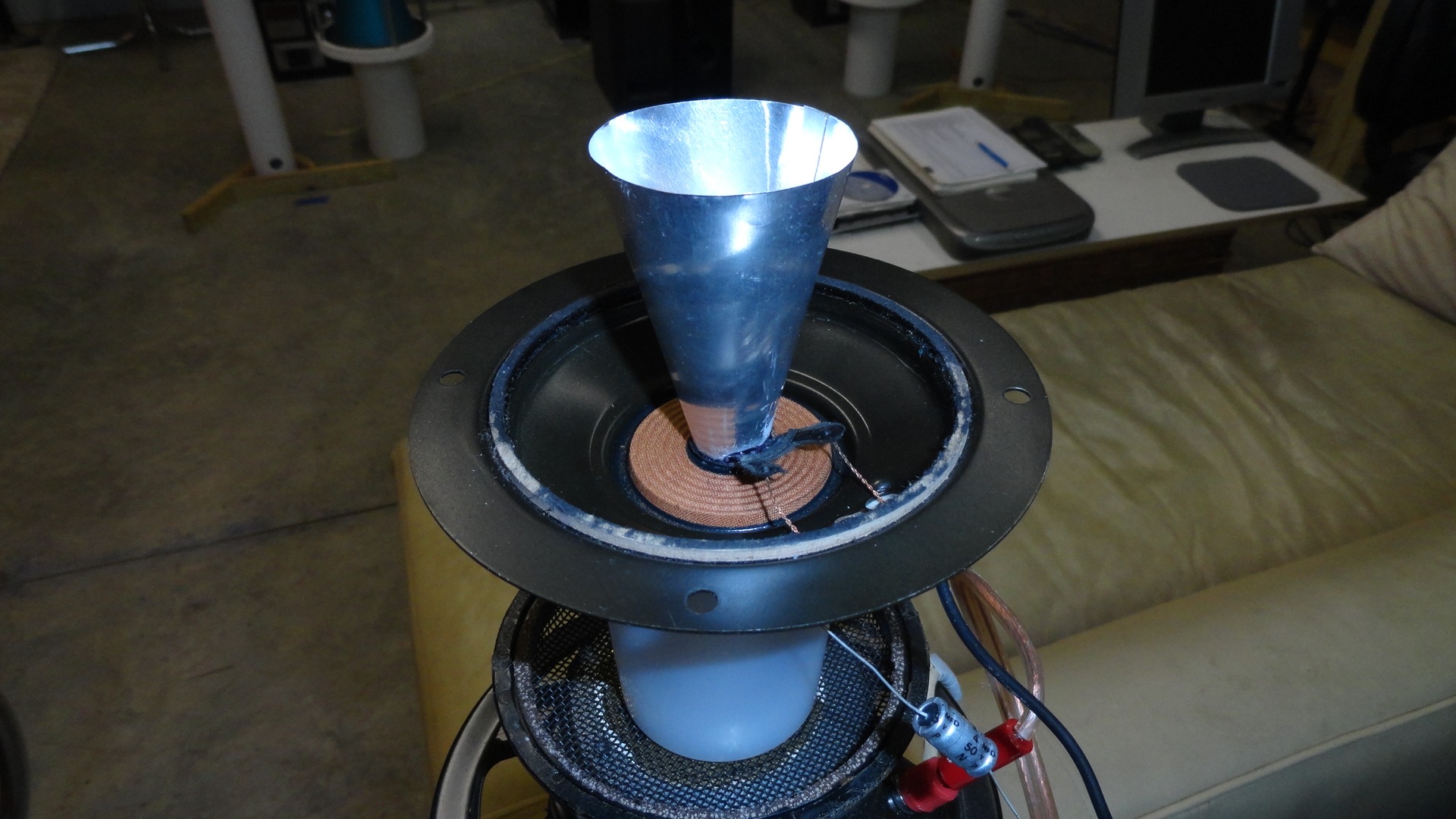

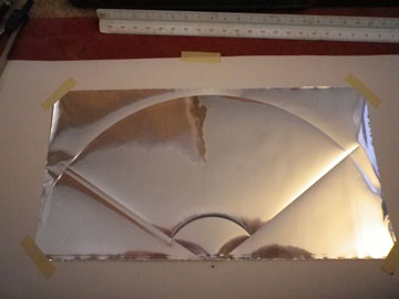

The 2mil alum cones ride again...
...this time, Successfully. *S*
Turns out, the mids from those POS speakers had 1/2" dia. vc with ferrofluid. Pretty 'advanced' for something that came from a speaker that wasn't impressive overall.
Fills in the high end on the back pair of the array; didn't especially want them to 'compete' with the lower unit, which they don't seem to. And they certainly act like a Walsh....
Let's see what the woofers can do with paper cones...😉

Thanks for the update and the pics 🙂
What kind of paper are you going to try?
I have a sheet of Kapton heading my way...reportedly good for winding a voice coil on.
"It's just the normal noises in here..."
Happy to oblige....since I've not met any true audioholics here in AVL, I've got to show this stuff to Someone that can appreciate what it's about...*G*

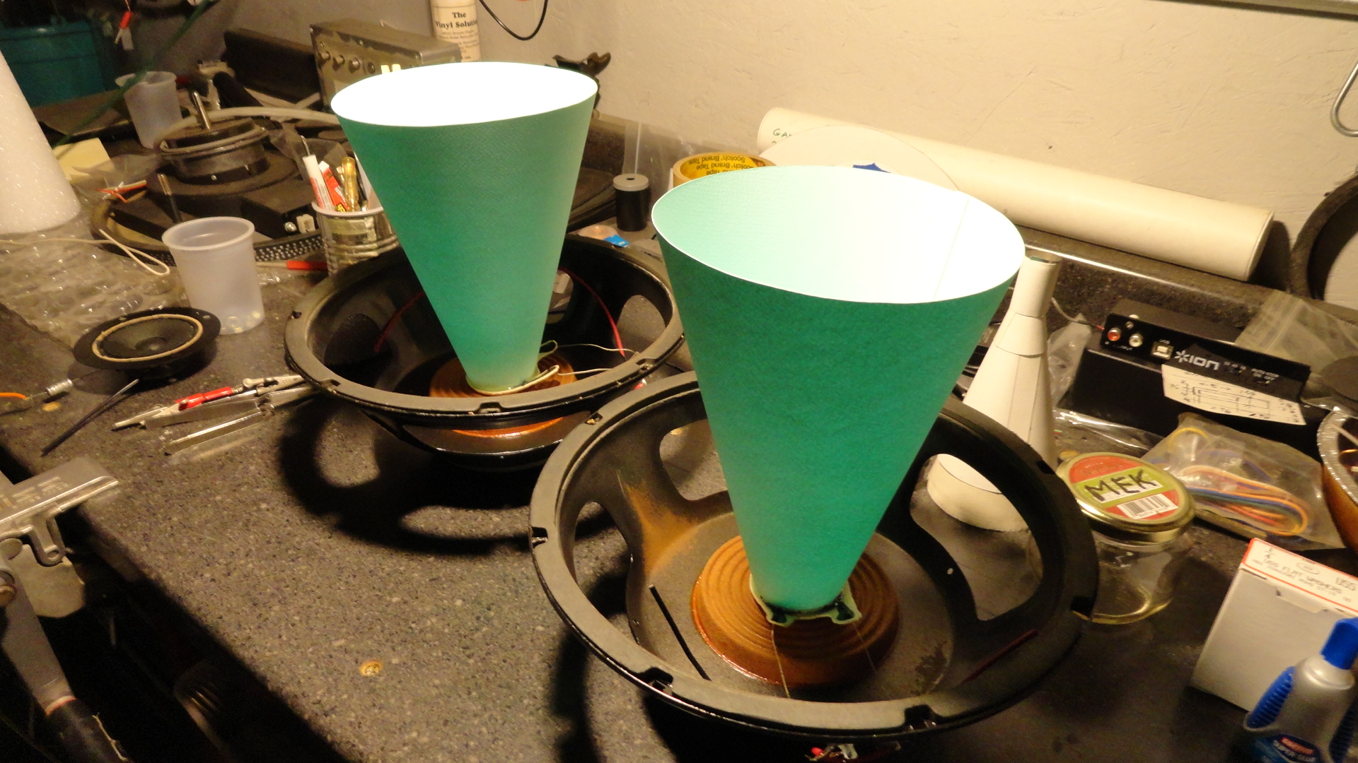

The paper I've chosen is a 2.5 mil stock made by an Italian co. that's been around since the 1700's. 'Ell, Stradivarius probably used to wrap his violins in their stuff.*L* It's got a slight 'nubbly' texture to it, so I'll get to hear if that has any effect vs. a 'smooth' surface...
Kapton's been used on vc's for awhile now, due to it's high temp qualities. Wikipedia notes that it's subject to mechanical wear, although I've seen it used for planar elements; perhaps a variant that's tougher in that regard.

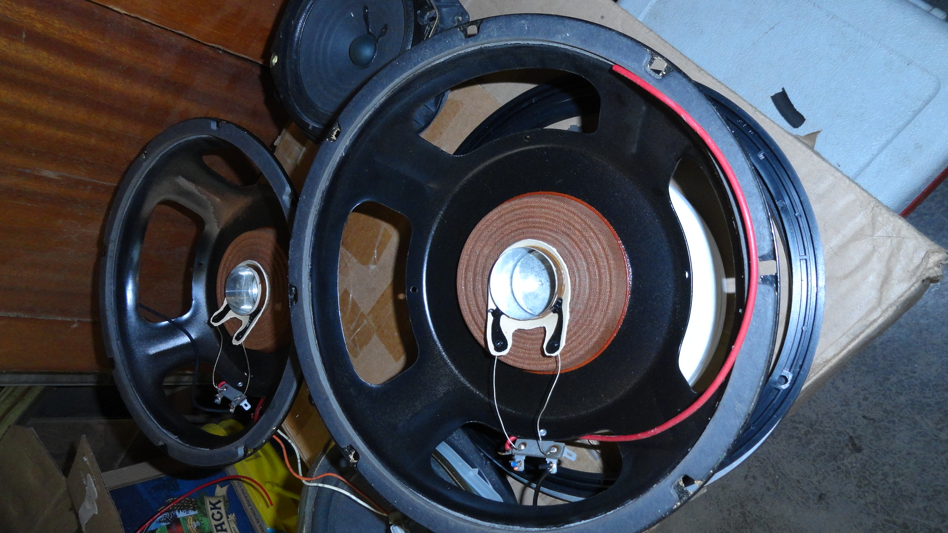

Meanwhile, I've prepped the cheapie woofers to receive the paper cones. 1 1/2" vc's...I'm going to make some 7 1/2" tall cones to test the 'crossover' therory re mid~bass that we've discussed...

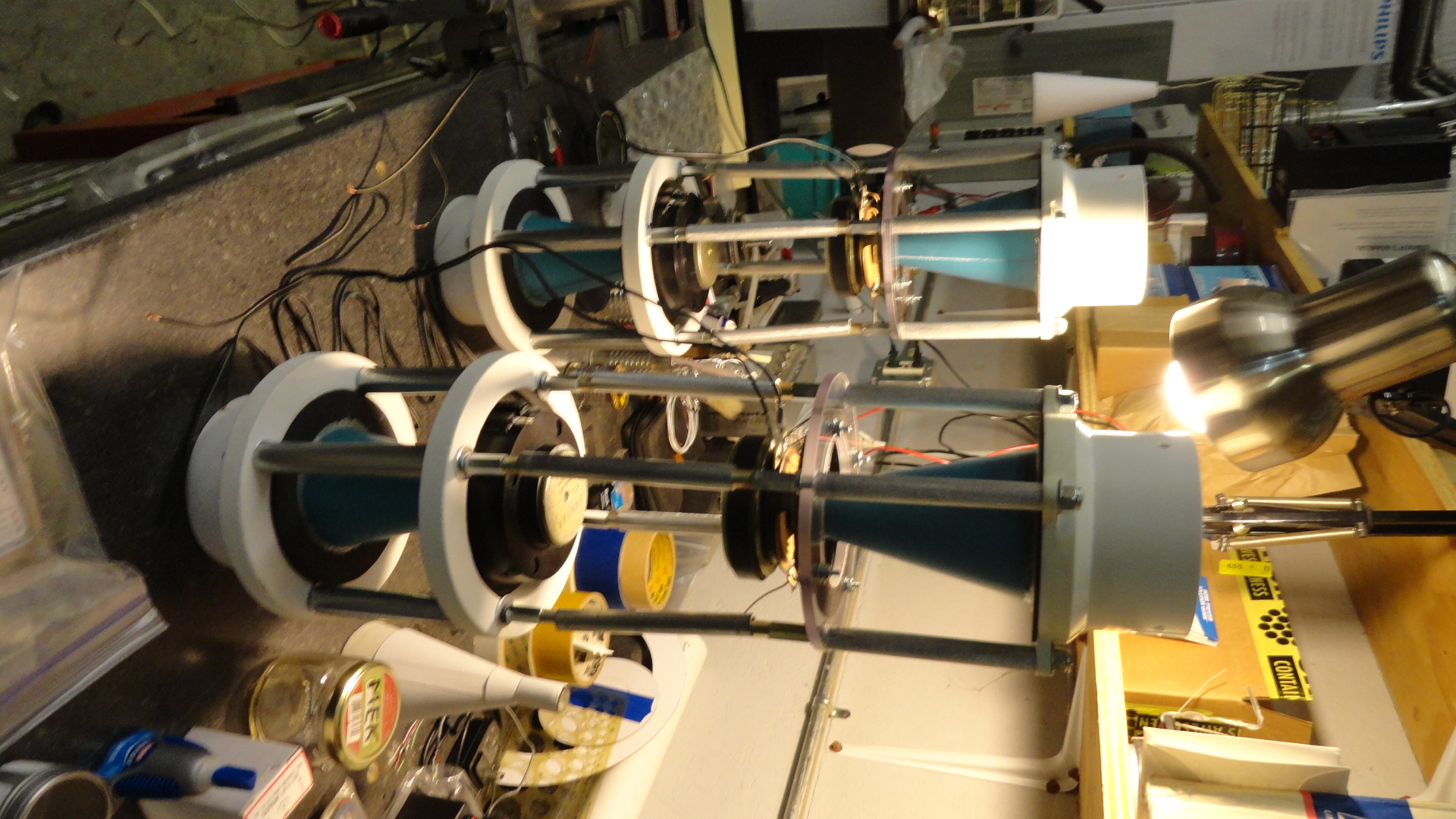

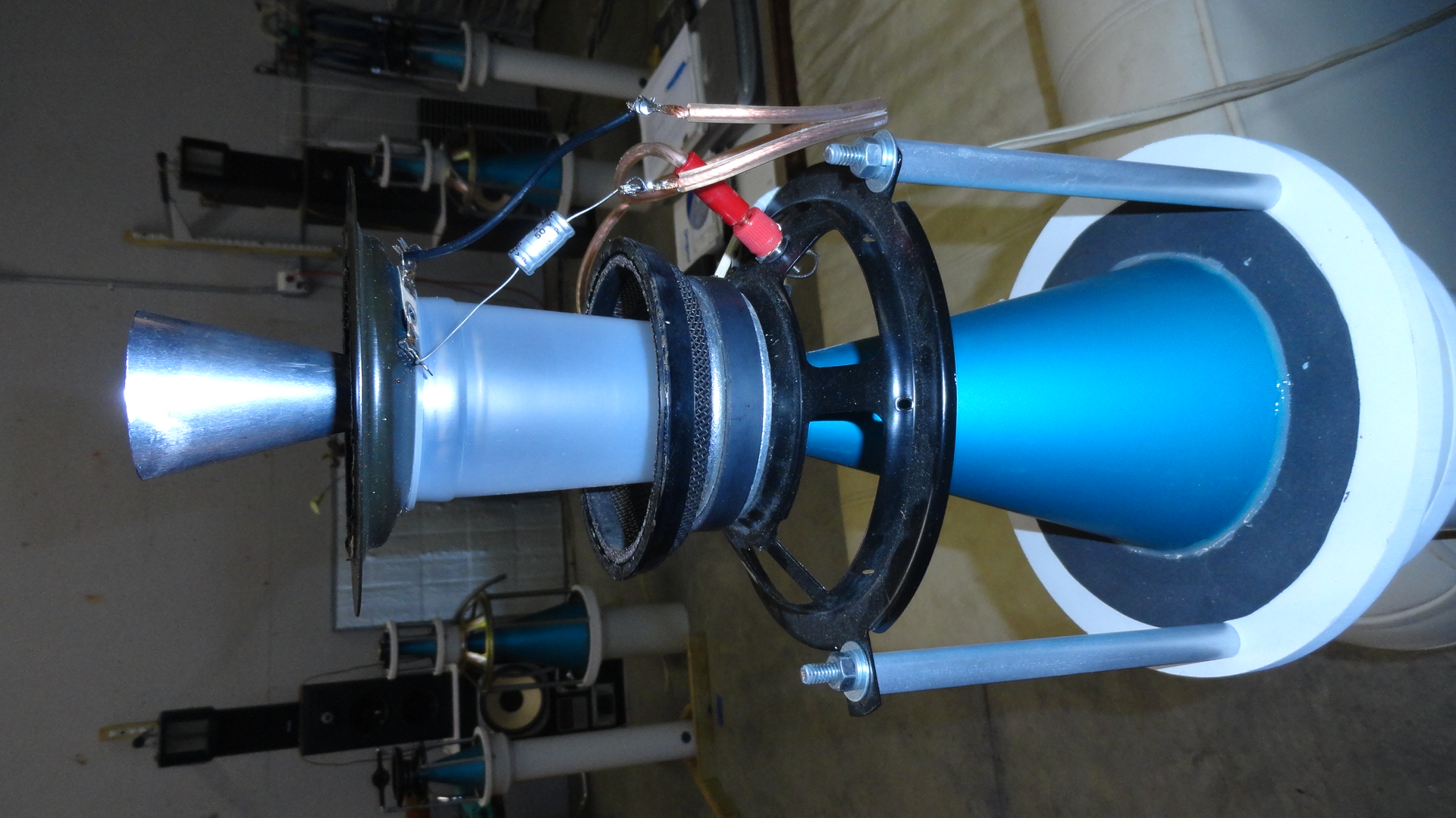

The other project is to mount the V.2's above the V3.75 mids in an 'hourglass' config. re the cones (which are the same size in both). When I tried the reverse config, base to base, it seemed to create a dispersion that had a 'hole' in the middle, kind of a 'null zone'. I'm hoping that this will reverse that, and perhaps augment the field created...
The 'fly in the ointment' is that the V.2's are 4 ohms, the 3.75's are 12 ohms. Paired, I can either have 3 or 16, both of which aren't terribly typ. I'm going to opt for 3 and not crank the amp, even though it's got thermal cut-outs and I run fans. I'm not in the mood to go shopping for a new/used receiver...*L*

Temp mounting on the existing bases, some basic 'wiring'....
...and it works. Plays quite loud, no vc heating, the Sony's not complaining, no noticeable heat coming from the fans....
...and the dispersion is just like I thought it would be.
I've noticed a difference between sitting and standing when playing a single pair. With a doubled pair like this, it doesn't exist anymore....
The sound coming from the base of the top pair still sounds 'honky' to me. Stuffing it with some polyfill helps, but if blocked off with some manual dexterity (my hand), it 'firms up' appreciably...

paper or plastic?
Glad to see your experiments proceeding...
Interested to hear your take on paper, the classic material.
Thought I would try polyimide, since some prefer it to titanium in compression drivers.
Seems like I'm hearing voice coil bobbin resonance (possibly caused by the large impedance change from aluminum to paper/plastic). Going to swap to an aluminum cone to see if that solves it, and I hope it does because that would simply imply matching bobbin/cone materials.
The 'honk problemo' is a subject all in itself...one problem at a time (yeah, right). 😱

Winding your own vc's ought to be a good test of one's patience and steadiness of hand. That and matching the dia. tolerances...good variable factors in that pursuit. *S*
Yeah, the 'honk problem'....the honk in the speakers, the honkys in the street, just can't seem to avoid it anymore....*mock sigh*
There's a group of cone materials I'd like to test drive; papers, plastics, metals. Candidate motors will be an issue, but I'm thinking of haunting auto junkyards for volunteers to keep the costs down. The other issue will be the plethora of speakers that will come from that, I can see where I'll be wading through a cone forest soon enough.
Got to find a means of 'cone swapping', a 'reversible' adhesive that won't make me break out in some ghastly skin malady or require a biohazard cabinet...*L*

...and a Beautiful cone. The reflection tells the tale, no distortions that I can see without being a snot and blowing the pic up to try to spot fingerprints. *G* A 'one off', or are you going to do a pair?
One of, kind of like wine tasting 😉
High are crisp, clean, and loud. Mids are dynamic.Transparent.
Extremely challenging to fabricate!
Only thing is, limitation in how much power the cone could withstand, no doubt.

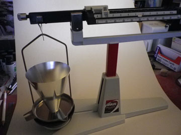

The cone only weighs 1.5g...
Ah, sounds like you've hit an arterial, to butcher a phrase...*G* Or, perhaps better, a promising combination. And anything that'll render the qualities we're searching for will likely require care in fabrication. Ask Mags about his project, or Solhaga or Bandsei about their diy ribbons. The more care and concern we invest hopefully will yield the acoustic dividends sought. *S*
