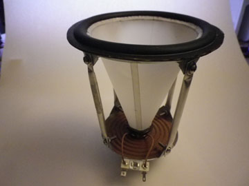

I made a couple drivers last week. one is a carbon/paper lam weighing in at a hefty 3.41 g. The other, a cotton vellum at 1.41 g. The paper cone has slightly better highs, the carbon/paper lam handles wattage without breaking a sweat. Both sound nice with an enclosure. You don't need a "woofer", unless your a bass freak. In that case...add a sub.

Here's a pic of the paper cone. the paper is clearprint cotton vellum (.076mm) at 64g/m^2. Nice highs. Cone fails at high driving levels though. When making a driver, assembling everything in perfect alignment is the key to success. There was a small imperfection where the cone base connects to the surround.

Nice looking pair ya got there. 😉 (Nice to be able to say that without getting slapped *L*)
Alignment is definitely important to attend to. I've made it standard procedure to shim the vc before gluing the cone to keep it centered, and to ensure the base of the cone is centered on the surround since I've been 'rolling my own' with the EVA foam...

Anywho, back to your observations of cf/paper vs. vellum...it does make sense that the cf/p would be able to 'play harder', likely due to density. The vellum, being less dense and lighter would be able to 'go higher'. Pity it breaks up...do you think the imperfection can be repaired?
