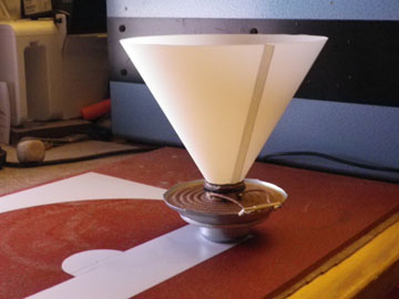

Made a new cone testing a new material, 0.15mm polypropylene. Beats my previous cones both in sound quality and durability. It is 14cm diameter and weighs 4.5g. I made it less steep at 60 degrees due to lower modulus of material. I like the way it sounds, and I'll give it a better test run later (when everybody else is awake).
Nice looking, and polyprop for a cone is interesting. I've been thinking of Mylar or the eq. for a trial. It'd be fun to have a clear cone, just for the 'ell of it, and it might even sound acceptable...

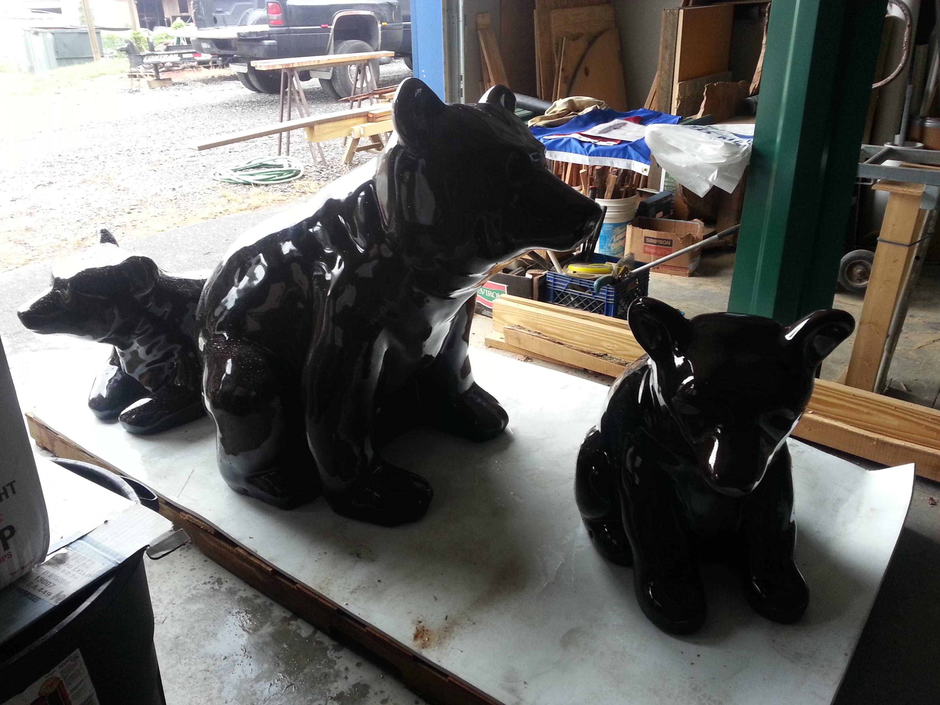

'Da bears'....since my spouse is a red head, we've had fun with Goldilocks puns. They are well behaved, no problem to feed, and no real threat. In fact, you could say they're pretty inert, and be right on. *L*
They're for a dinky (850 sq. ft.) 'play area' at the main entrance to a hospital in Cherokee, 'bout 1 1/2 hrs. S/W of us. It's been a real PIA/JFH job, more details per sq.ft. than anything we've ever encountered. The landscape architect begged us to take the job, as we were the only co. that bothered to call him back. In retrospect...we should have told him to take a hike. But, it'll be 'high-profile' due to it's position and ought to look good when the dust finally settles....
