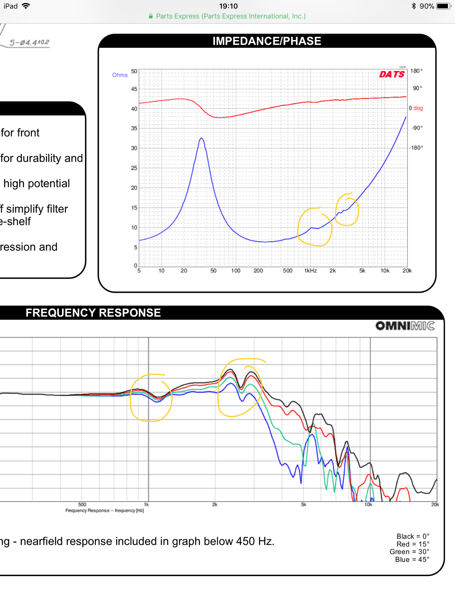

This speaker seems to have reviewed well but I have some concerns about it. The plots have been smoothed, it always a bit misleading to compair unsmoothed plots with smoothed ones. There could be short peaks in the response that we cant see and the peaks we can see might be worse for short frequecy spans
The cone break up at 1khz looks like it is resonating quite strongly, notice the disturbance in the impedance plot at the same frequency. This is indicative of resonance in the cone and thus energy storage causing poor transient response. You always get a bit of this but it seems quite high in this driver. It might sound quite musical depending on the behaviour of the resonance but it is not accurate and usually smears the image slightly. See the regions I have circled in the plots.
If it is especially cheap it might be worth putting up with these faults and designing to minimise the effects but they would be quite hard to mask in the crossover.

The good reviews and technical data called my attention but I don't have the resources neither knowledge to judge it right. The price is half of the Scanspeak. There are other Dayton drivers with good reviews. I would like to find a woofer with a frequency response higher than 2000 Hz, no matter if the crossover be designed to less than 2000 Hz. I would like to feel safe in case a live test doesn't sound the way I like. Having a woofer with more mid-range allow to increase the crossover point and to release the tweeter in any case. Maybe it isn't necessary but the possibility is there.

Of the two I think the DS215-8 would probably be easier to work with as its response is more controlled over a larger frequency range. However neither of these speakers has 60deg of axis plots (They stop a 45deg) so their off axis response could become very poor the further out you go. (the scan speak included 60deg)
Whilst they do offer extended on axis response the off axis response of any 8 inch driver becomes problematic for good power response in the room as you go over 2kHz. It why most manufacturers of 2 way speakers now use 6 - 6.5 inch drivers rather than 8 inch.
