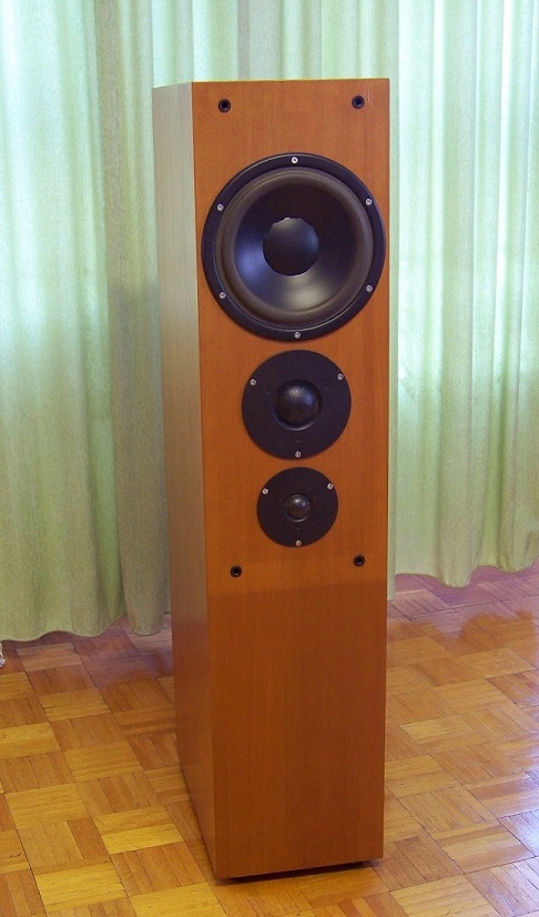

IMHO, you didn't listen to a soft dome, but to a soft dome with a crossover. See here what Zaph says about dome material (scroll down to the Vifa NE line tweeter test results, March 27, 2010): Zaph|AudioI am open to listen but regarding to the tweeters, I haven't found any soft dome I like yet. I have listened to Sonus Faber, Tannoy, Mission, Dynaudio, etc. I don't like the sound of the soft domes I have listened to.
In general your constraints are hard to match all together (2-way with 8" sealed and metal tweeter), I don't know of an open design like you want. If you want a 8" you need a tweeter in a waveguide or horn, and that is what was suggested, or you need a more robust and thus expensive tweeter.
Ralf
Right,and on top of that a overly tight cap on netto enclosure volume: book-
shelve size. Meaning a bucket of air behind the bass.
That said,industry speakers got him covered of course. I remember the
Canton Karat 920 for example which comes close. Although its not a enclosed
but vented speaker,it has a 8" bass and a 1" metall-dome and is bookshelve
sized.

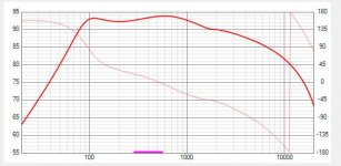

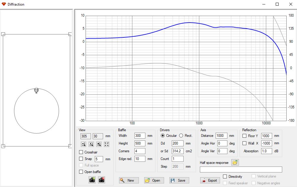

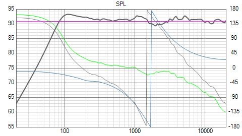

Of the speakers you are looking at I think these two will integrate together the best (although I agree a 6.5 inch driver would be better for off axis response). The bass drive is not well suited to a small box.
Scanspeak Discovery 22/W8534600 8" woofer
Peerless DA25BG08 metal dome tweeter
I have done a crossover simulation from the data sheets, the woofer is showing signs of beaming at the top of the response. So I brought the tweeter response as low as I though I could get away with 2KHz (which is the measurement bandwidth in the data sheet for its power response). You can see this in the off axis responses and the power response.
I have minimise crossover components as far as possible to give as direct a path as possible and reduce cost. As it seems you like to hear the metallic top end of the instruments, I have balanced it quite bright.
The bass alignment is a massive compromise as this speaker really wants to be in a much bigger box than a book shelf speaker will allow. I have simulated a 15L box this has quite a high Q hence peaks a bit and will give a mid bass heavy presentation. If you wanted to reduce the bass peak a 22R resistor (or other value to your taste) in parallel with the bass driver will massively reduce the 40 Ohm peak resonance at the cost of a dB or so off mid range response.

I agree with you.! Probably, the limitations of those soft domes I have listened to are the results of the crossover design. It makes sense but to be clear about it, I have to buy some soft domes and to play with the crossover. I have to take the risk. ThanksIMHO, you didn't listen to a soft dome, but to a soft dome with a crossover. See here what Zaph says about dome material (scroll down to the Vifa NE line tweeter test results, March 27, 2010): Zaph|Audio
