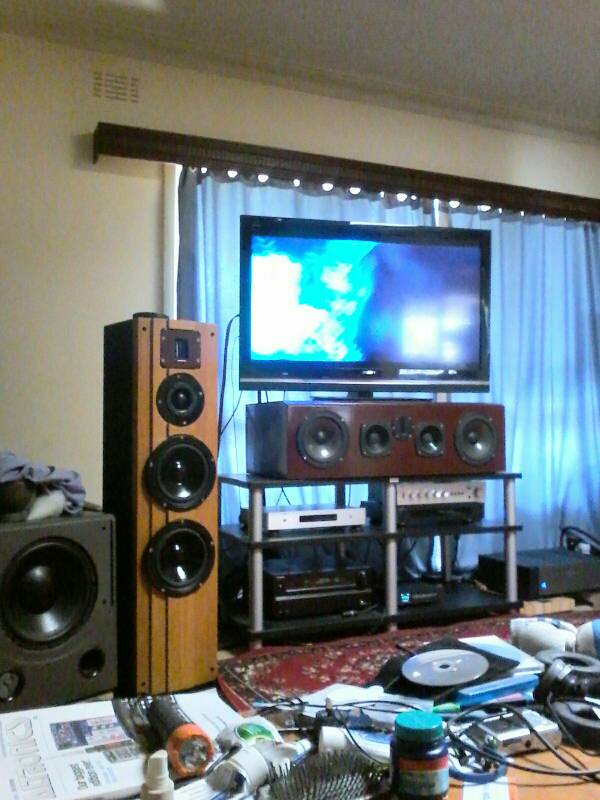

I agree somewhat but if you do your research and take it slow it can be fun , I heavily modified some ElectroVoice status 50 's and made my center channel from scratch. Here's a pic . That center is massive weighs about 60 kg is a 3 way crosses with an LR2 @ 450 Hz and 3800 Hz has a Lpad on the mids.
The enclosure is heavily braced lined with felt and stuffing and is a sealed unit.
You are absolutely right, it is fun , but only when you are happy with the results. Btw your speaker looks great!
Thanks and that's a 46 inch Sony sitting on it for reference.You are absolutely right, it is fun , but only when you are happy with the results. Btw your speaker looks great!
