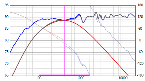

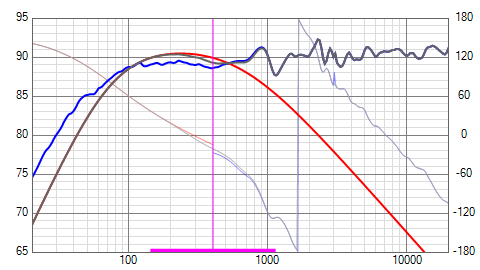

I entered the T-S parameters and did a Butterworth maximally flat amplitude bass alignment. This comes out at a much more reasonable 10.3L (practically anything around 10L would be fine.)
Or if you want a little more deep bass at the expense of mid bass a Bessel filter alignment (Which provides a maximally flat response in the time domain - i.e. minimum group delay peaking) and is typically easier to use in a room close to walls requires a volume of 17.5 Litres.
This speaker is much better suited in terms of its T-S parameters to a book shelf design.

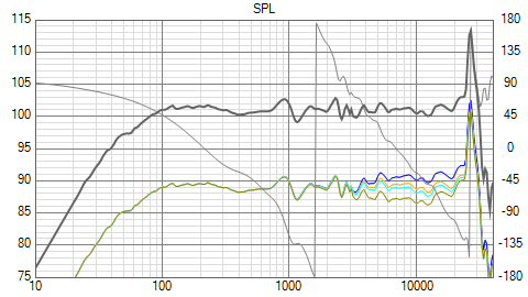

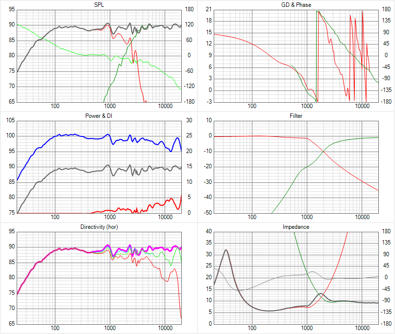

The Dayton Audio site had the frequency phase and impedance data available which saved tracing it and provided real phase information. The off axis response of the tweeter has been estimated by using the 30deg for both 30 and 15 and using the 60deg for the 45deg (There is no 60deg woofer plot so this cannot be simulated) this means the off axis response of the tweeter is worst case over estimated.
The design has been optimised to try to avoid awkward values. The on axis response has been compromised with the power response to try to give a falling power response with no significant peaks. There is a slight "BBC" dip at around 3kHz as the tweeter becomes dominant and the directivity index dips to attempt to minimise overly bright presentation in this area. the electrical crossover is a 2KHz the acoustic somewhat higher depending on how you average through the peaks and dips in the response.
I have shown both Butterworth and Bessel bass alignments (keep in mind that this will be affected by the baffle set and room response). Bessel would be best if you plan to use a subwoofer with it or you find your room tends to be boomy with speakers close to the wall. Butterworth will provide the best response if you plan to have the speaker away from the wall, you like a lot of bass or you room tends to such up bass (this usually means you have wooden construction walls and the bass is escaping)

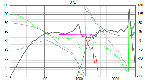

For interest I have included what happens if you use the Dayton driver with the crossover from the Scan Speak (The tweeter remains the same) this clearly shows why it is often problematic to swap seemingly similar drivers over.

Thank you for all.! I have compared both data you provided (scanspeak and dayton) and find the Dayton is also a good contender. I hope it sounds good.
I agree the aluminium driver does seem to work well and the crossover looks like it has worked out well. Also spending more time working on crossovers I am remembering more of the techniques I used to use (its been about 10 years since I did my last comercial design). If you do build it I will be interested to hear your impressions of how it sounds. I will send you the design filesso you can adjust it if needed.

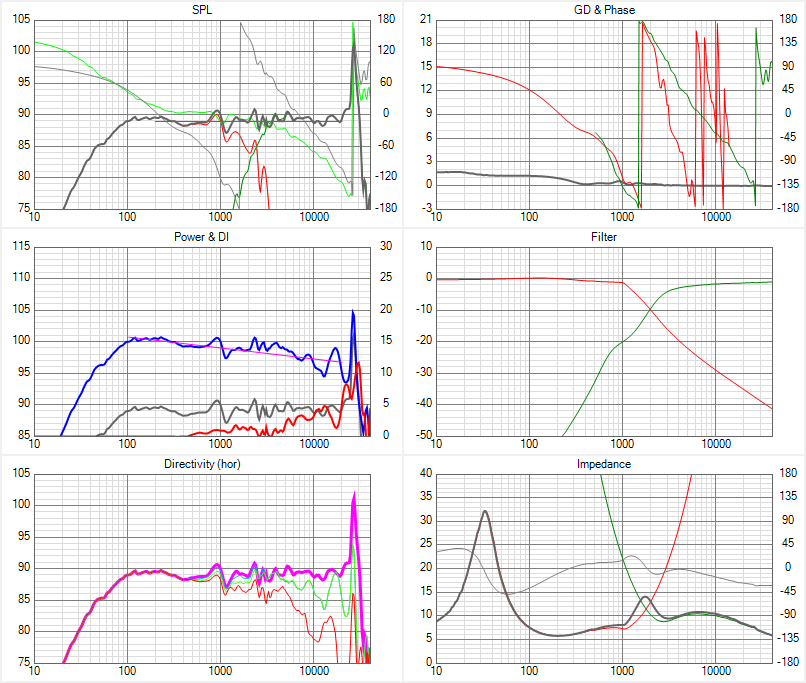

I was a bit concerned about the 1R Ohm resistor in the tweeter crossover. The tweeter needs to be padded slightly to match the Dayton woofer as it is not as sensitive as the Scan Speak one. This is a common requirement and the approach I used is a common one.
However this tweeter has such an extreme resonance at 27kHz I am concerned that putting a 1R in series with it will mean the amplifier has reduced damping control over it. (It not much good having a fabulous amplifier with a massive damping factor if the speaker is the other side of a resistor)
So I have come up with an alternative approach that requires no changes to the Xover region (so you could try both if you want to) and provides a convenient way to slightly adjust the HF level independently of the Xover components.
It uses a C-R filter to adjust the HF. The cap attenuates the signal over the top end and the resistor prevents the load on the amplifier becoming entirely capacitive at high frequencies. (which can make some amplifiers marginally stable and ring a bit and poorly designed amplifiers might actually become unstable and be damaged)
Attached is the updated Xover the extra parts should be relatively cheap as the capacitor is fairly small and resistors are not expensive. The resistor is set at 4.7R as this is a reasonable load to place on the amplifier at high frequencies when all the capacitors basically look like short circuits. In the impedance plot you can see how the impedance falls at high frequencies it will level out at very high frequencies to 4.7R in parallel with the tweeter inductance.
The capacitor at 0.68uF gives a good approximation of what the 1R did. I have also included a plot with this circuit removed completely, 1uF and 2.2uF so you can see how it behaves going up (removed - Blue) and down (1uF - Light blue and 2.2uF - Yellow). As the capacitance gets higher the 4.7R dominates above 10KHz, hence you get less attenuation so at 2.2uF you get a bit of a lift above 10KHz.
I think this approach will give you better control of the tweeter, as at high frequencies the amplifier has a direct path to the voice coil of the tweeter. It also provides a 4.7R load directly on the tweeter at high frequencies when the 0.68uF cap will behave like a short circuit, this should help to provide some damping and some attenuation as well.
