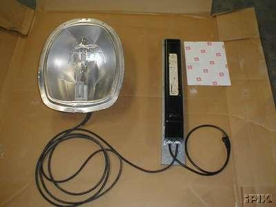

400 W MH bulb, ballast, reflector for $90 Too Big?
One of the more usual things you see at ebay. Looks like a good deal though.
http://cgi.ebay.com/ws/eBayISAPI.dll?ViewItem&item=2020161724
Has an electronic type ballast (quiet, important). Reflector is a bit large looking (17" x 10" x 7") especially for a projector panel. What do you think? I emailed the guy, he doesn't know crap about the bulb, expect for that its a mongel base and he says it can take any mongel base MH bulbs.
What do you guys think? A good deal? By the way, speaking of reflectors, why not just buy a whole fixture assembly that has a reflector built in. What I found here may not be a good example, but I'm sure there out there.

The MH fixture/ballast on ebay is interesting...pretty cheap, but no bulb. I think 250watt bulbs are not as common as 400watt (also, higher wattage bulbs are often cheaper!). You can get a new 400watt MH ballast for $45.00 here:
http://www.vitrex.net/~lighting/mh400ballast/mh400.htm
http://lighting.webpipe.net/ballast.htm
That's a pretty good deal!
SuperDave, those bulbs are large! I know that MH bulbs for reef aquariums can be smaller (cylindrical shapes). I think the glass envelope is only for UV filtering purposes...but I DON'T recommend removing it! That's a quick way to burn out your retinas and/or house. I agree with Myren...a good reflector is the key to success with any point source light. Oh yeah, there are two bolt/screws that hold the reflecor onto the fixture. I was able to remove it without damaging it, so that might help you out. Good luck with it.
