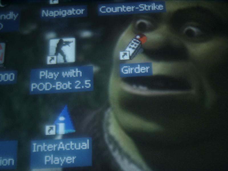

Here is a screen shot of my projection. My projected image was about 5 feet high so it was rather large....but as I mentioned befor it is a bit dim...I knew it would be because of my low lumen overhead projector. I will fix this next.
The image here is about 1.5 feet tall and is about 250 pixels(maybe a little less). You can see a screen door effect but it is not really visible from just a few feet back..
The biggest problem right now is the brightness and color...This should be remedied when I change out my bulb.
I bought the VG150 because it was supposed to be one of the best (at least for a 15" I could get cheap...Sharp and Hitachi have some GOOD monitors but I dont know if you can get an unobstructed view to the screen). However, I was not too impressed with the color on the monitor when I got it. I guess its becuase I'm comparing it to my really nice 20" CRT monitor (I suppose I shouldnt compare the 2). With the high contrast and quick response of the VG150 this should be a great projector.
Oh ya...this is displayed as part of a 1024x768 resolution screen. Again let me know if there are questions... and I will get back to you this afternoon or on Monday.
Good luck.

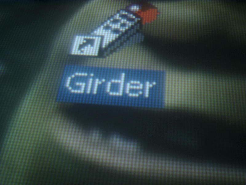

one more screenshot
Ok here is a VERY close-up screen shot....and yes I mean screen shot. This is only about 75 pixels wide and you can clearly see the screen-door effect. You are able to realy see the detail of the projection....and again I would like to state that the screen door effect really isnt visible a few feet back.
I'm sorry I dont have any full screen shots...my camera just couldnt take a good picture...It doesnt take pictures of non-bright objects more than a few feet away. I will try to get something soon.

Heres a better screen shot of my projected image onto a regular white sheet.
