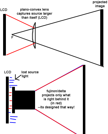

I don't know if someone can help me, my lack of optical knowledge is really hurting.
Up till now I have been using a fresnel lens as the projection lens for my 5" lcd. Now I am redesigning the setup so it is rear projection and thought the 4" Delta77 compound lens I have would be better quality and more suited to the short throw needed (about 70 to 100" or so).
I thought that the "projection lens must be bigger than LCD problem" could be avoided if one or more fresnel lenses were used on the light source side of the LCD in order to converge the light, so in simple terms it all fits through the projection lens. However my really basic experiments so far have shown that I still need to have the Delta77 lens really close to the LCD (about 15mm away), and even with trying a fresnel lens at various distances behind the LCD I can't get anything better than a weak circular image that fades at the edges.
I have seen some peoples photos who are obviously using some sort of small lens as the projection lens, I assume they are using lenses intended for ohp's which might have longer focal length than the delta77 which I think was intended for CRT projection.
Am I stuck with using a ohp fresnel lens as the projection lens? I assume the problem is even worse with bigger LCD's.😕

well, you are pretty much right. we might have to use either a plano-convex lens, or bi-convex lens (OHP lens) instead of a delta or fujinon in order to capture an LCD that is larger than the diameter of them. (see attached pic)
however, if there is some way of using both of them -- the delta AND a bi-convex or plan-convex, it might work. But remember, you dont need a fujinon or delta to complete the project, and, if I was going to use both a plano-convex and a fujinon, then, it would only be to achieve a shorter throw distance.

As you may know the majority of lens are made as a section of a sphere. The simplest lens use can use to project an image is a converging len(like the ones form an OHP) It is flat on on side and convex on the other. The curved surface is the section of the sphere, the center of this sphere is called the center of curvature.
If an object is past the center of curvature you will form what is known as a real image.A lens can form two types of images, real and virtual. A real image will apear on the opposite side of the lens(projected),and will be inverted. A virtual image appears on the same side of the lens as the object, can not be projected, and is not inverted. The image you see when using a magnifing glass is an example of a virtual image.
So, now as we move our object from beyond the center of curvature and closer to the lens the image becomes larger, untill we reach the focal length of the lens, at that point the image becomes a virtual image and of no use to us for this application.
When you put a fresnel in between the light and lcd, you are not trying to make the light converge onto your lens, in fact you dont want the light to be anything but parallel rays of light hitting the lcd at a right angle
This problem you are refering to will real only apply to complex lens like the delta or equivalent. These lenses were made to save space, the designer wanted to put the lcd as close to the lens as possible. Unless you have an LCD of a size designed to work with the complex lens it is going to be a pain in the *** to get your delta to work. It may be that your 5" lcd is just a bit too big.
Try using a convering lens. It is more efficient in passing light and will result in an image with less aberations then projecting with a fresnel, and you wont suffer from the constaints of the delta.

Thanks for the help Undream and gray, invaluable.
It sounds like a converging or plano-convex lens is what is required.
Gray - what you said about not wanting anything other than parallel rays striking the LCD makes sense, but now I am confused as to how the plano-convex lens will function. If parallel rays pass through the regions of the lcd not directly covered by the projection lens, how can they be captured by the converging lens? Unless we are relying on scattering occurring (there will be some), all the light from those regions will miss the lens entirely.

When a panel is placed on an OHP stage, the rays of light from the fresnel are converging to the head lens, so the rays are indeed not travelling parallel. Several posts back, I mentioned that this could theoretically cause a central hotspot because of the decreased transmission in the periphery (I think this is mostly due to polarizing layers in the LCD matrix). So anything other than 90 degree light rays will be less than optimal. I hope my thinking is correct with this...anyone?! 😱
This is what led me to look at the fresnels themselves. jvisaria confirmed my guess that OHP fresnels are acutally two fresnel--one for making the light from the bulb parallel and one for taking that parallel light and converging it to the head lens. If the LCD could be sandwiched between the two fresnels, this could lead to an increase in transmitted light and/or a more consistent image.
The basic design of an OHP seems to include the very minimum of optics that are necessary for any DIY projector that uses large panels: point-source light, fresnel, LCD, fresnel, projection lens (PCX, DCX, or achromat). Now all we have to do is adapt a more efficient light source (MH or MV, or example) and find a lens with a throw that suits your goal. Combine that with a VG150 like SuperDave and some quiet cooling, and that should be a nice setup 😎 . BTW, the PCX lens I purchased from www.surplusshed.com produced (rough estimate) an 85" image from a 9" source at 11 feet.

The plan to stick parallel rays of light through an LCD is very clever, but it will not work the way you're going about it. Fresnels (which are by definition approximations to proper lenses) have shite image quality when compared to proper glass lenses. If you look at the surface of the fresnel is it any wonder? It's not a proper lens, and intended really only for light. Why do you think the Big Woody 100" TV project didn't work? Is sticking a fresnel in front of a lit LCD any different to sticking one in front of a big TV? Nope.
Just had to get that out to pre-empt the hundreds of messages saying "I tried this but it didn't work? Why not?" Try looking a few pages back. The forum repeats itself over and over again so you shouldn't have to look too far back to find what you're after.
😱 I apologize, Scot_lad. I honestly didn't see it earlier. It's hard to keep up with everything that is posted, but I try.
I guess until we can get our hands on those 0.8" high-res LCD's we will be limited to using fresnels. You are right...fresnels are just flat, lower quality versions of a plano-convex lens, but an equivalent PCX lens would be heavy, expensive, and nearly impossile to locate. Aren't most fresnels from OHPs of much higher quality than the "page magnifier" lenses? I guess it depends on the level of quality you expect from a DIY projector. Good point, though. The advantages gained from "sandwiching" probably would be negated by the reduced quality of passing the image through the second fresnel.
-f4
Posted by Scot_lad on 03-17-2002 08:29 AM:
....Putting the fresnel in front of the image isn't a good idea, because it is relatively low quality and while that doesn't matter as much for just light, it matters a lot for an image. Notice how in an OHP, there are two fresnels, one which takes the light from the bulb and turns it into a parallel beam, then another fresnel directly stuck to that which takes the parallel beam and converges it through a slide (or an LCD panel) into the high quality glass optics at the top of the OHP arm. Or whatever they're called...
-f4
