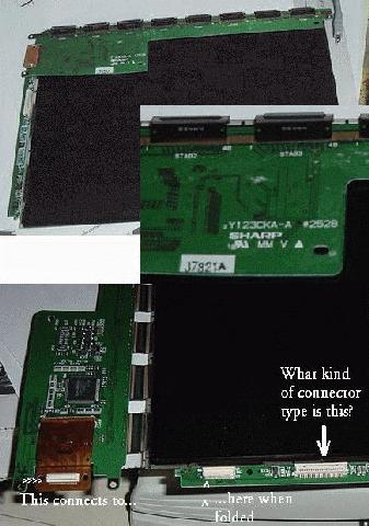

1st: Panel choice. I've obtained a Dell laptop computer (Latitude CP) with a 13" 800x600 display. (I hope to find a 1024x768, so I'm trying to keeping my ideas scalable)
Here's what the panel looks like, once it's freed from the case (see attached pic)
But I havent figured out stuff like:
a) What kind of connector is that that takes the input signal?
b) Where do I find the extension cable which will hook up the vertical and horizontal signals (that is, since the circuit board must be swung out of the way and disconnected from the edge board, how can it be reconnected?
c) Does the panel also require power, as well as signal. (I know that the backlight for the display in the portable computer needed power, but was it ONLY for the backlight?

Sorry to be the bearer of bad news but it's not practical to use old laptop displays for this purpose. You can't just feed a analog signal to the panel. You have to convert the analog signal to digital via a controller card. The controller cards for the laptop lcd are rather expensive (if you can find one). I've seen some on eBay for approx $150. Earthlcd also carries controller card that, if I remember correctly, sell for that much or more. Additionally most of the controller cards are setup for a particular panel and you odds of finding one that will work for you are not good.
There are two type of cards that I've seen, PC based cards and standalone cards. The PC based card will (I would guess) have a limitation on the distance between the PC and the display. You would also have to find a way to feed the video to the PC.
The standalone card accept various non VGA video signals (S-video, NSTC, etc.) These cards are generally more expensive than the PC based cards. This is the type of card (Digitaview) that you provided the link to. I've emailed Digitalview regarding pricing and they indicated that they don't sell single cards.
The power for the lcd would be supplied by the controller card.
I looked into this route when I started researching for my project and quickly gave up on the idea. Do an eBay search for "lcd controller" maybe you will get lucky. Welcome aboard!!!
