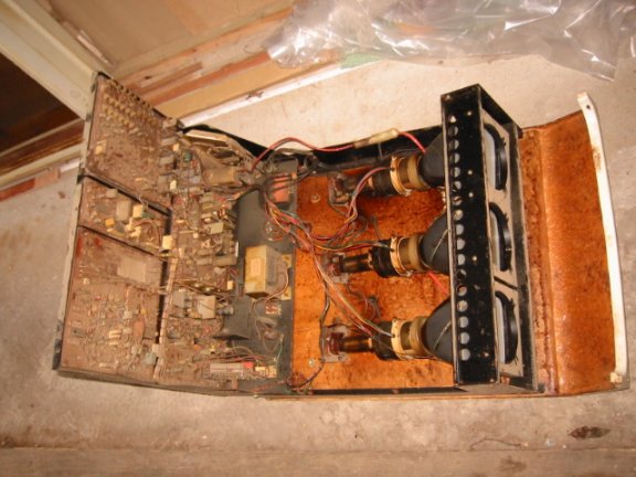

I was raking around in the attic the other day, when I came across.....the original copy of the bible. Which was nice.
And I also found something which appears to have come from around the same era, this projector (see attached photo). The lenses have been removed but you can see where they would go in. The reason it is a kind of manky orangy-brown colour is because I got it from a friend who is a DJ in a club - the smokey atmosphere really got to this thing. You can also see from the dust it's been sitting in the garage for a while.
Anyway, it is arcing when I turn it on, which is a bit like a machine gun. I haven't tried to get a picture from it as I'm really not too interested in it. Maybe I should try and fix it, it might soldier on for a while.
Scot_lad said:...the smokey atmosphere really got to this thing.
Thats a slight understatement 🙂 🙂
