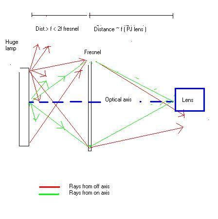

For all who wanna know something about the problems with large sized bulbs here my quick poor drawing. Dimensions are not geometical correct. You can see the rays which come from off axis don't reach the projection lens. It would be the same if a point light source was shifted to the outer region !
xblocker
xblocker
xblocker
I get it now; create a point source with an elliptical reflector. I'm off to ebay to see if I can get a Newtonian telescope that can be fed the light from a MH lamp.

Reflectors and such: SIZE MATTERS!
Its kinda funny that attention is finally being paid to reflectors. This has been one of my concerns all along... But why re-invent the wheel? I'm sure all of you have seen the insides of OHPs by know, they are all (all the ones I've seen) based on small bulbs with small reflectors.
---->Several people have tried to drive this following point home now, but pretty much ignored: You are not going to get focused light rays from a field of light! It doesn't matter if its from a light array or a perfect elliptical reflector. The whole point is to have a small light source is to let the frensel do its job. The only way to do this is to get a small enough bulb so that you can use a small enough reflector (or ditch the reflector all together and make do with ~40% output or so). By small, this is all relative, but it has to do with the relative size of the frensel. Remember the frensel the the key to all of this, so you have to operate around its parameters!
To sum it all up:
1) find a small enough bulb to use a small reflector with. It does NOT matter much if the reflector is a perfect shape or not, as long as its small. (functionality wise, of course the % light effecency improves if shape is good..)
2) If you can't find a small bulb, just use the bulb then, don't use a large reflector!
Now then, barring any major errors with my post, holy grail now is for a cheap SMALL MH bulb....
